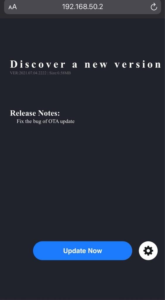

My original CarLinkIt v1 dongle has an update as below. The file size is really small though, and it’s the July one not the recent Aug one. Safe?
It is this way, 07.04, 07.05 and then the 08 update.
Ah ok so I need to update with 07.04 first. I was just nervous seeing the size (Mb) of the update where normally they are much bigger. These will all be OTA as well?
Thanks I may try it on my CarLinkIt v1. Wonder if there’s a USB version to see if I can recover my cheapo Amazon which just displays solid red LED
