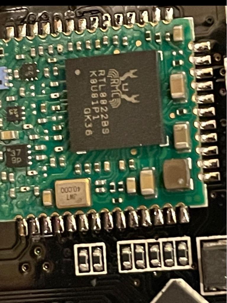

That's not entirely correct. What you have shown above is known as the 3.0 Mini.
The original model (non-Mini) also comes in 3.0 revision. One of the differences we have now confirmed (vs. 1.0/2.0) is the different WiFi/BT chipset.

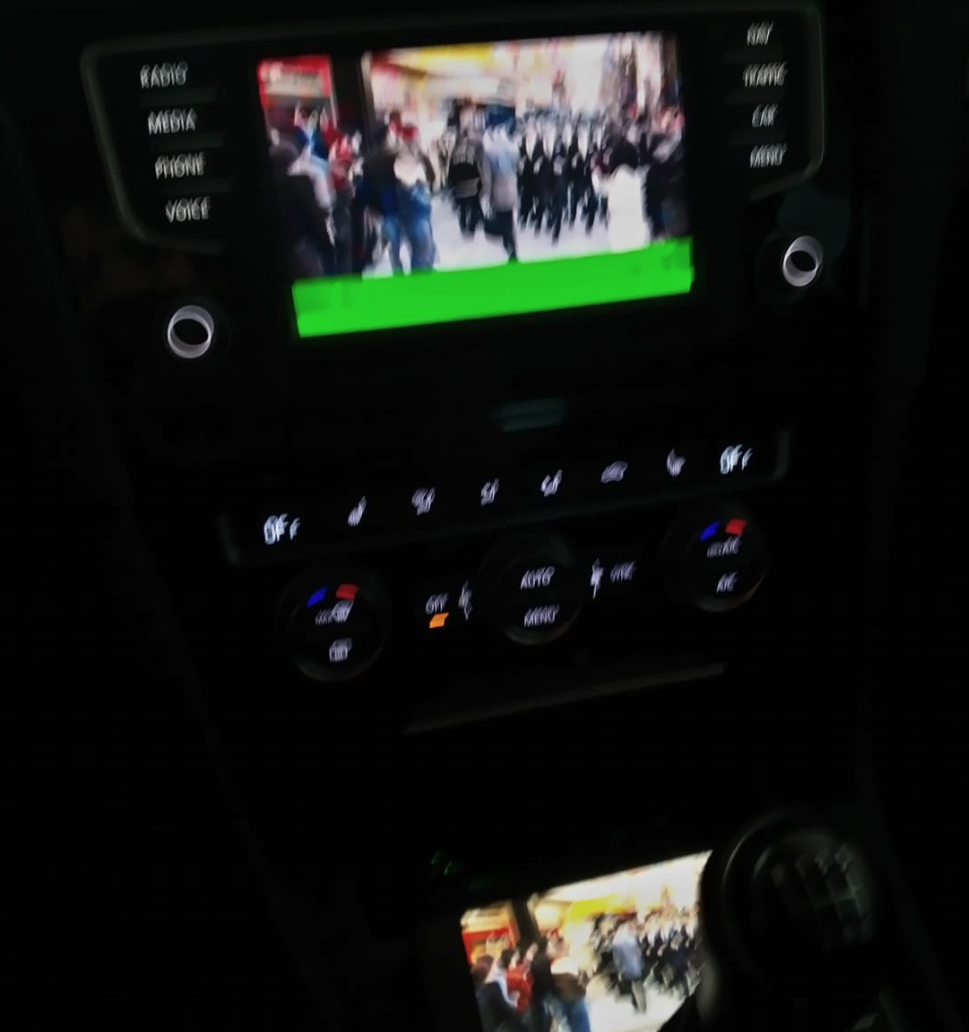

1 hour trip with music plus gps on the podofo.
No lookups, no stuttering everything fine!!!! Also it does not get as hot as the carlinkit v1.

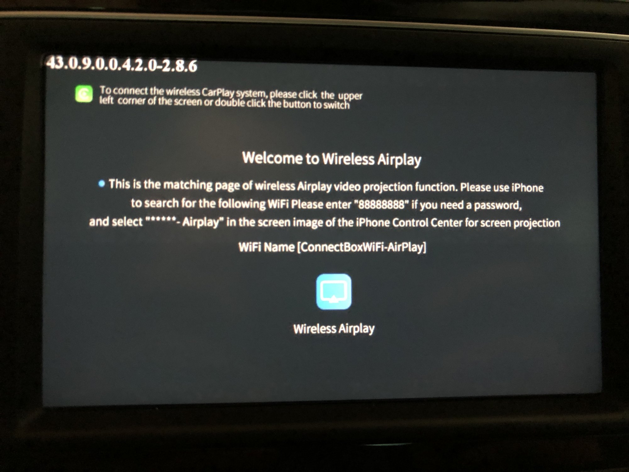

Tried casting, podofo casts a wifi but didn't know its password. i updated the firmware and now the wifi pass is on the load screen (88888888). Tried casting my phone and it works, a bit of video artifacts on youtube but could be cause my old iphone 8.
Overall pretty satisfied, for 36€ its a steal. Hope it works as good for a long time 😬

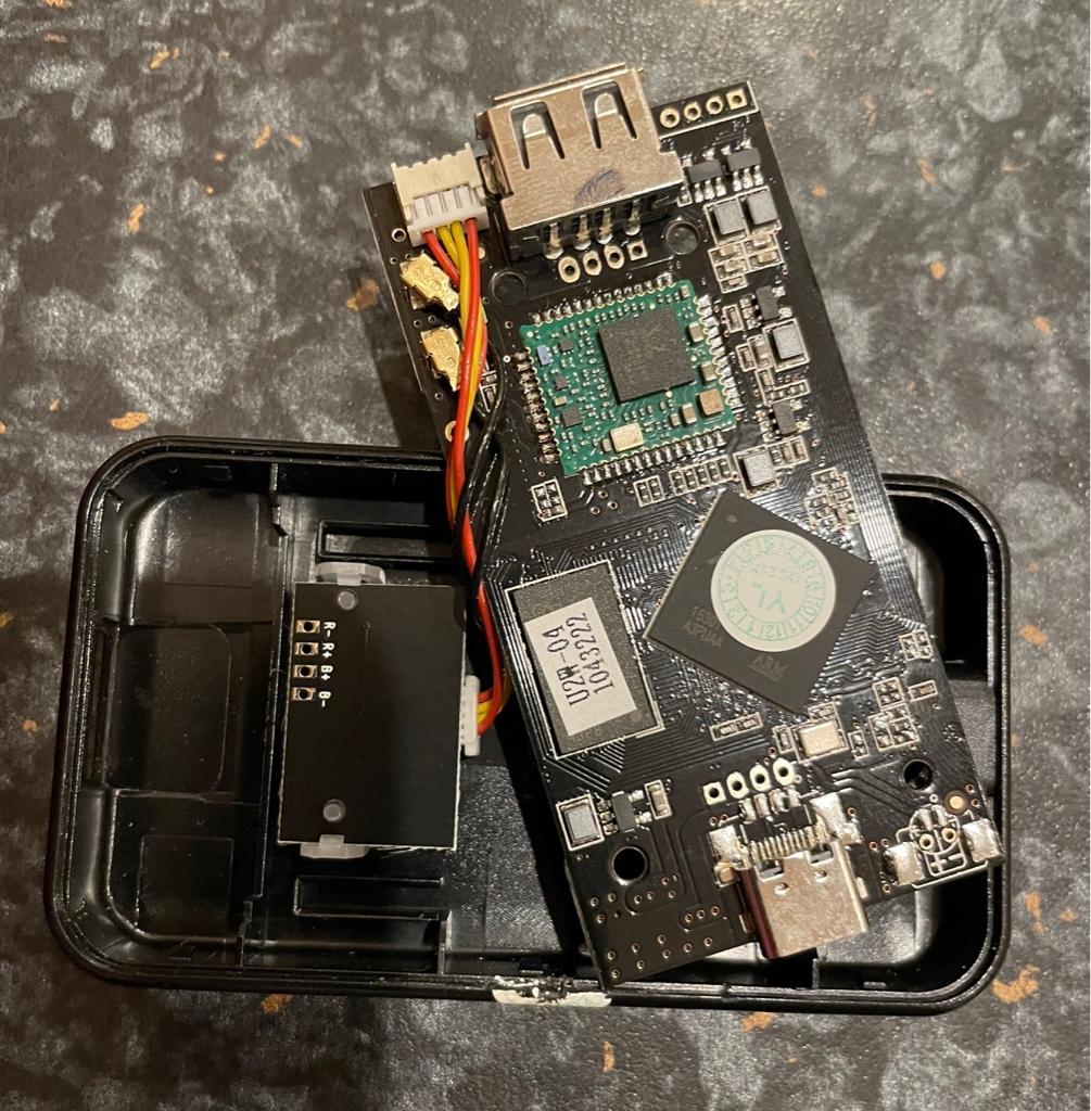

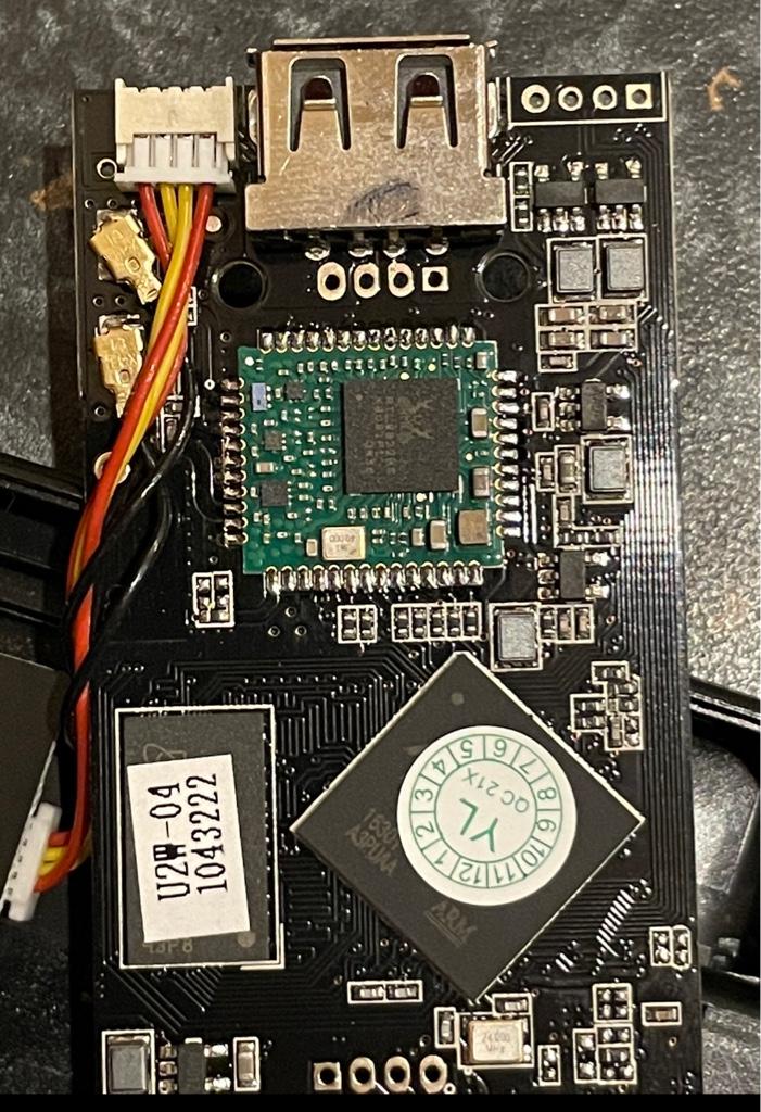

For info….
Here’s my dead (solid red LED, no WiFi, nothing comes up on car screen) cheapo Amazon internals, looks like a v2 CarLinkIt with a USB-C.
