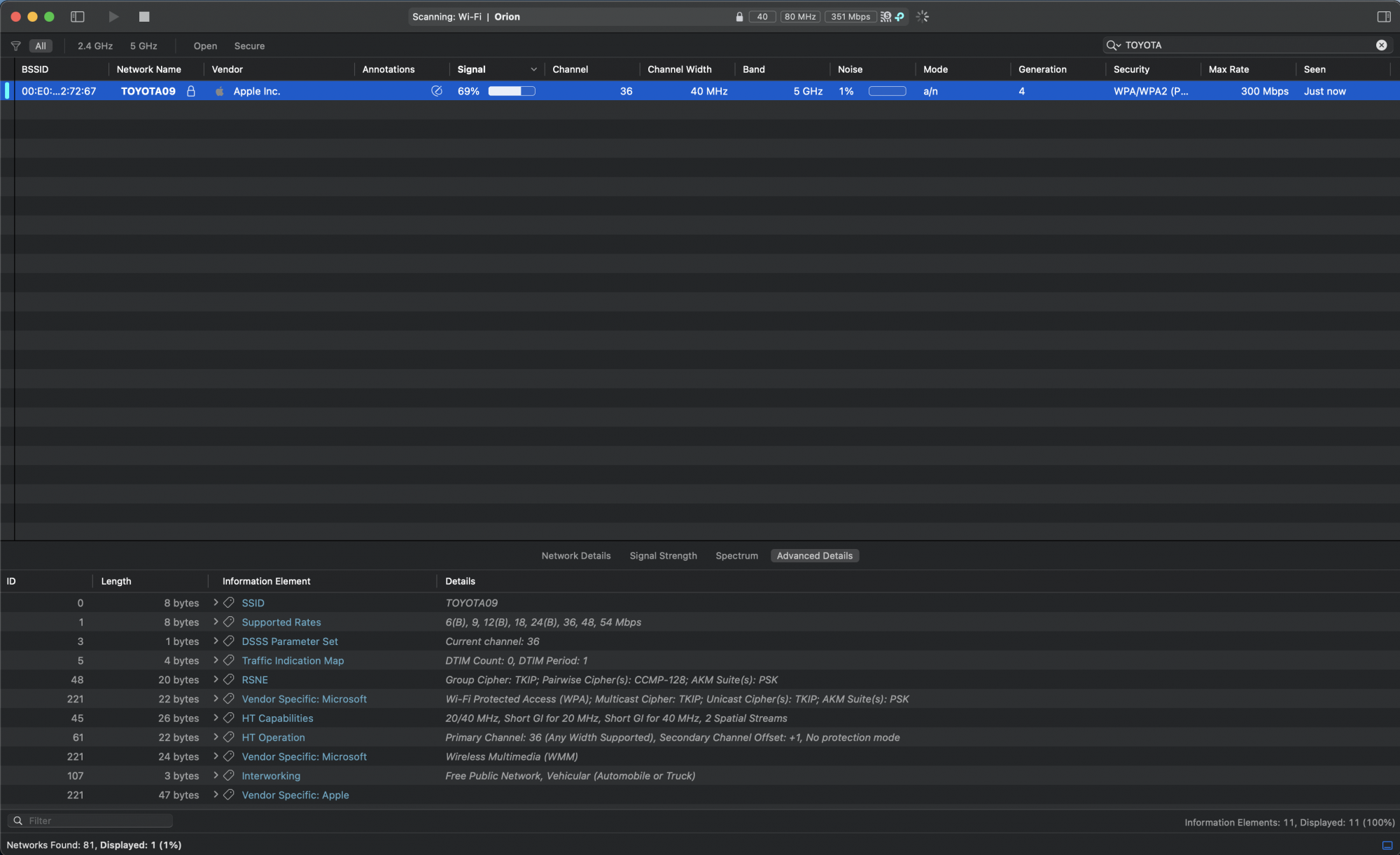

The access point spanned by the Carlinkit adapter only offers 802.11n 2x2 40MHz @ 300mbps:
It uses channel 36 which is UNII-1 and not the advertised 5.8GHz band (UNII-3). This should make any difference though.
Apple actually recommends 802.11ac VHT (using up to 80MHz wide channels resulting in 866mbps) and even mandates WMM. The Carlinkit 2.0 adapter offers neither despite the built-in Realtek WiFi chipset supporting both. I don't know whether it would make much of a difference since CarPlay is a point-to-point connection, not using a hell of a lot of bandwidth anyway. It might however bring down latency.​
I was able to confirm using WiFi scanner the newer Carlinkit 3.0 hardware (new red UI with pretty buttons), they are now on 802.11ac @80Mhz (still on channel 36 though).
I can't confirm that. Mine is still WiFi 4 (802.11n). It is a Realtek based Carlinkit 2.0 with red UI. Probably yours is a Broadcom based one.

Agreed, Red interface (PCB dated 20210516) is still Wireless N/4 @ 40MHz.

I'd expect that. Only the newer 3.0 hardware (new red UI with pretty buttons) supports 802.11ac with 80Mhz BW.
