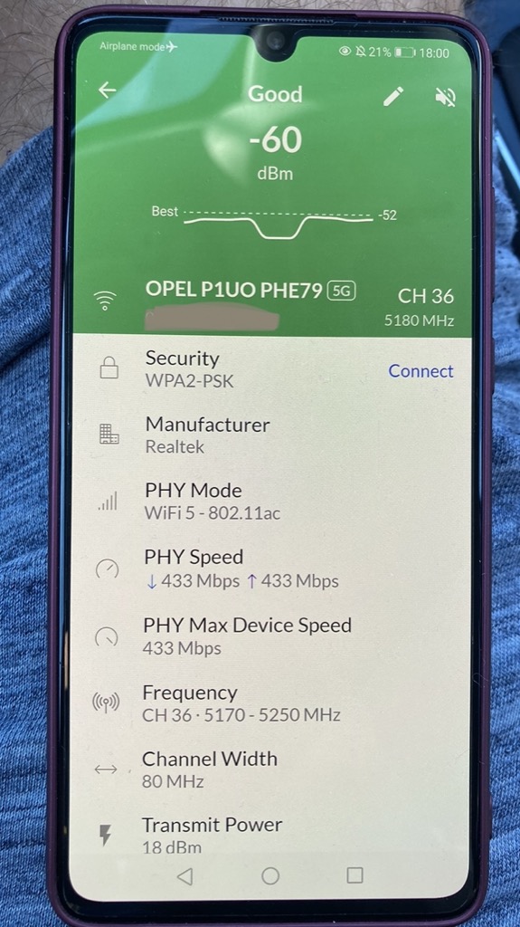

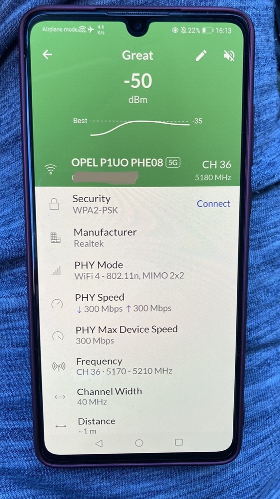

so, after owning both v2 and v3 i can confirm the following:
(both realtek chips, same channel 36)
- V2 uses WiFi 4 - 802.11N, 40Mhz width, PHY 300mbps
- V3 uses WiFi 5 - 802.11AC, 80Mhz width, PHY 433mbps
- V2 transmitting power mid-low 50s
- V3 transmitting power mid-high 50s, even 60-61dBm (seems less powerful signal)

Now the interesting part: I can swear that prior to 24.08 FW (i fired up the android wifi analyzer while on 2021.07.05 i think, just before updating to latest 24.08) the PHY was 867mbps. Now on latest FW it's settled to 433mbps. Could this be the "power optimization for less heat" mentioned in the 24.08 FW?

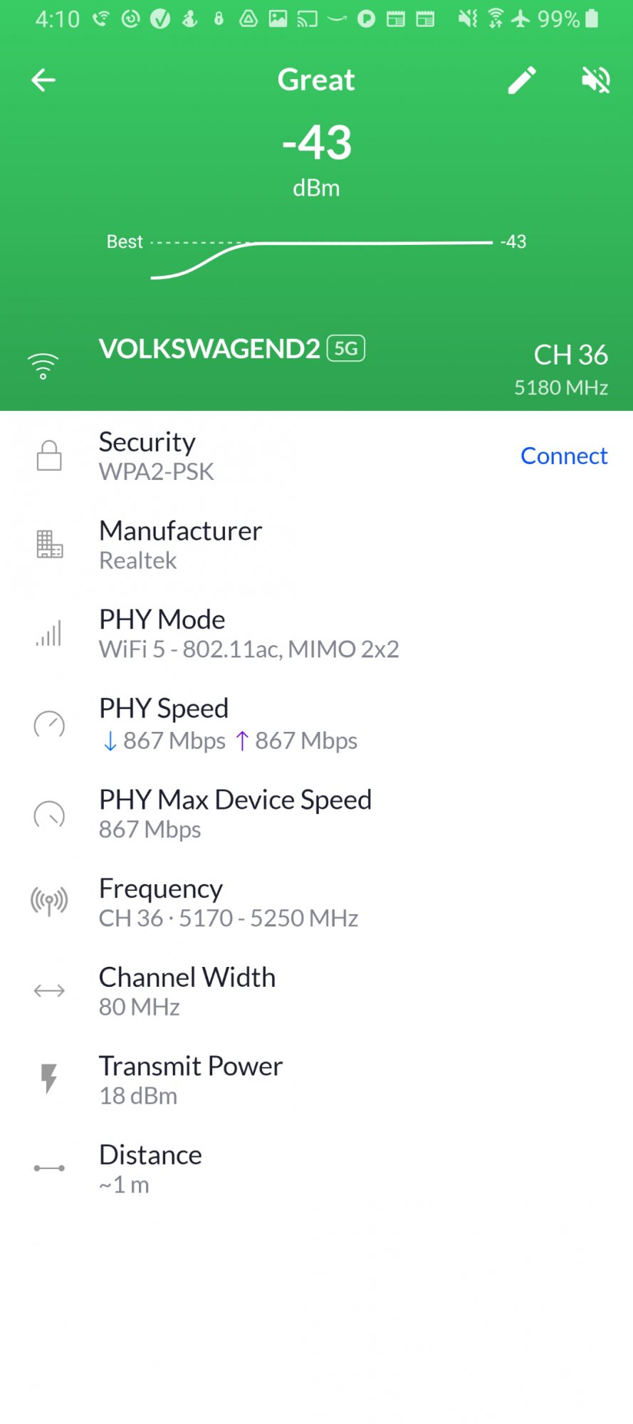

OK -- received my V3.0 dongle (red interface), confirmed it's running at 802.11AC -- this is out of the box (says volkswagon).

Also - confirmed it's running at 802.11AC -- this is out of the box (says volkswagon).View attachment 1826234View attachment 1826239
That's interesting. Based on your screenshot compared to the one above (the one above w/ 2021.08.30); it looks like they might have disabled one of the radio spatial streams. This would explain the drop in bandwidth; and could actually hurt some performance. The screenshot above w/ the latest update shows 433mbps and no longer 2x2MIMO...
I wish they would give control over the radio, e.g. allowing users to set the channel, width, etc... I would imagine a 20MHz channel on 165 would offer a more stable and reliable connection, compared to the lower channels. When I drive through radio-busy areas, my connection will often cutout, sometimes to the point of my phone disconnecting. 2x2 @ 20MHz would still offer ~170mbps link-rate//~100mbps usable throughput.
