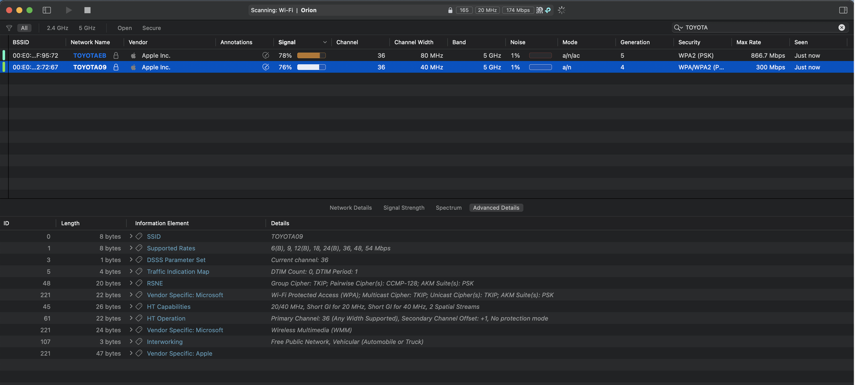

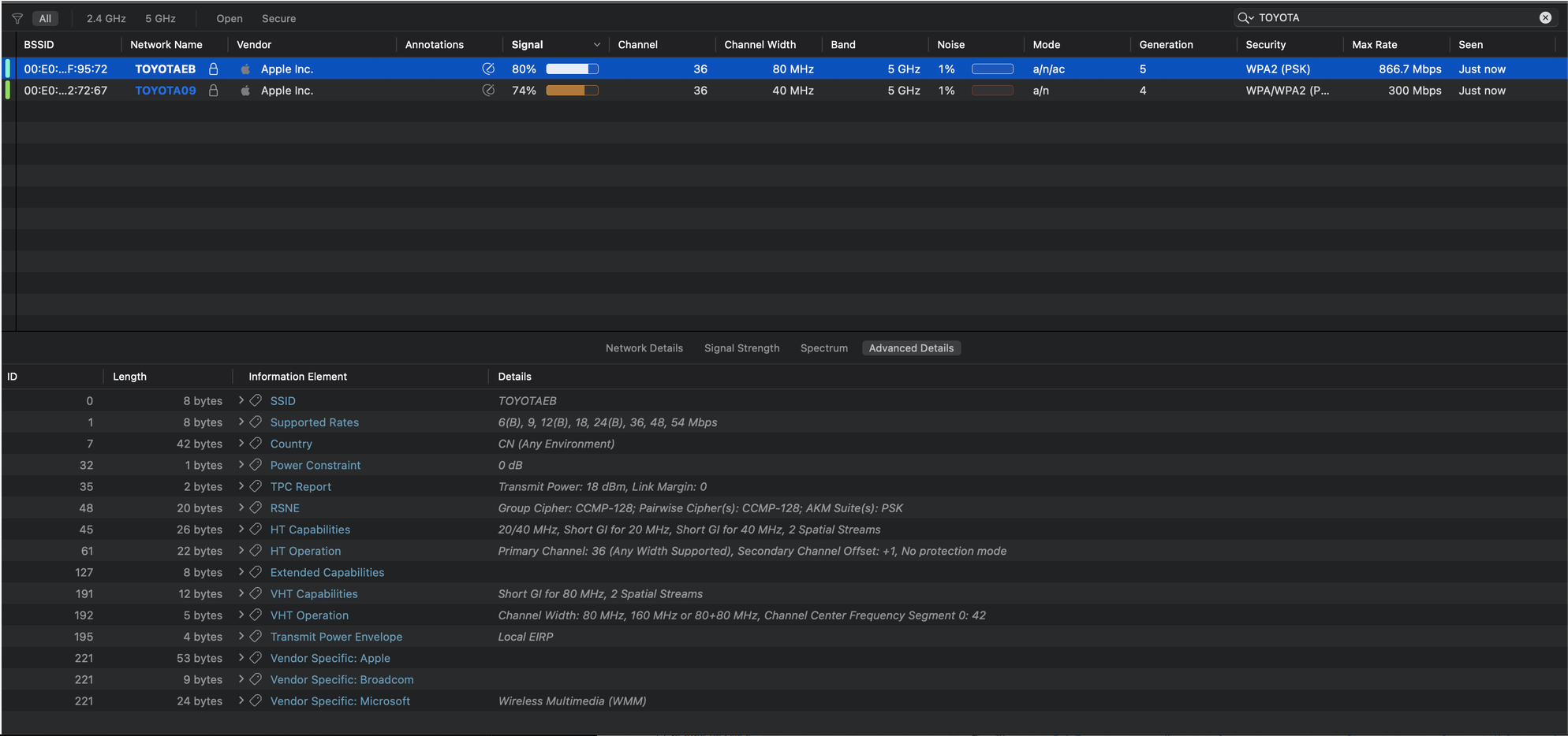

I believe this is normal. If you pull up the webpage 192.168.50.2, under the gear, you'll see a media delay section. I believe the default is 1000ms, a lot of people are dropping it to 500ms. Results may vary, but yes it's delayed on my 3.0, about the same as my 2.0...
With the very minimal testing I did, the v3.0 seems to connect a little bit faster that my 2.0... Haven't timed it at all, so I could be wrong, it's just my first impressions. Other than that, audio delay and screen responsiveness seems the same. I haven't been able to test a phone call yet to tell if there's any lag or delay when answering the call, etc... I know my 2.0 struggled at times to connect calls, and would sometimes freeze up completely; usually saw that once or twice a week.

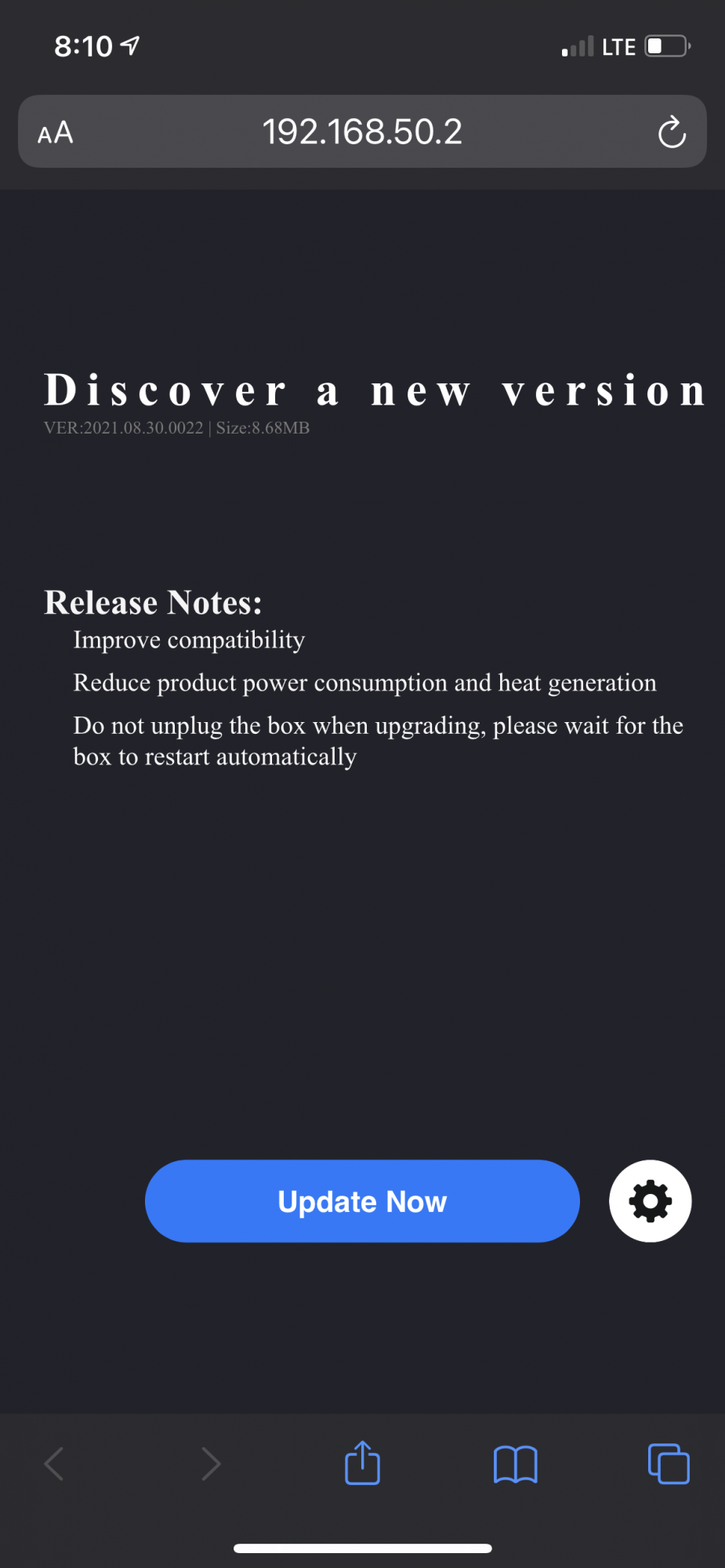

Just saw this new OTA update. Will update and see if things run smoothly
Reactions: Pau1ey
Just updated my Carlinkit ver 1.0 (original USB-A with the 10MB rootFS) from vlud custom 2021.02.02_BASED
to 2021.08.24_BASED.
Good news the mic on my Sony XAV-AX5000 finally works wirelessly - 2021.02.02 (or any earlier ones) didn’t work at all for calls, messages or any Siri.

Update on Podofo:
But first... a mention that my CarLinkIt 2.0 running AutoKit 07.05.2021 keeps rebooting after an hour or so, and although the web interface keeps telling me there is an update that I download and try to apply, nothing ever changes. This despite emptying the browser cache etcetera as I always counsel others. So I was happy to return from a lengthy road trip on Friday to find the Podofo had arrived.
Plugged it in and it was straight up and running, firmware version 43.0.7... and connected to CarPlay. A short test and a drive later, it seemed to work only every second time of starting up. When working correctly the Wi-Fi network was ConnectBoxWifi... and when not connecting the Wi-Fi network had a suffix of Debug or Dbg. I am vague on these points because I did not have time to take proper notes. The car is a 2021 Mercedes C-Class (W205) with NTG5.5, and it may be total coincidence but the multimedia (COMAND) also locked up in CarPlay at one point, the first time this has ever happened. Not totally encouraging.
Next step therefore was to upgrade the firmware. I could not at this point remember the IP address for the device in order to try an Over The Air update. By the time I could look it up it was just as easy to register on the cheerrdriving.com website (it's free) and download the update image 43.0.9.0.0.4.2.0-2.8.6. The Cheerdriving / Podofo image file is named ISPBOOOT.BIN (this is not a typo). I copied the file onto a blank microSD card and inserted into the Podofo then powered it on from a USB charger. I waited a couple of minutes after the flashing green light turned solid then powered off and tested in the car. All good. Repeated testing out of the car with an Android tablet using the CarLinkIt AutoKit adapter also seemed fine.
I made one short drive today with a brief stop, and the unit connected fine both times. I will make some longer journeys tomorrow (Monday) and update further.
EDIT: I have not yet had time to try unpacking the ISPBOOOT.BIN file
According to the tech I was working with this is normal operation.
My unit never connects so the Debug network is the only one I ever see.
