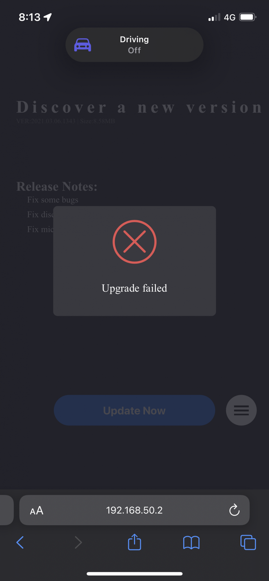

Still having an issue where I can't upgrade my Carlinkit firmware... fails OTA, and have tried via USB multiple times, following multiple instructions in this thread, on both a Mac and PC... nothing. Is this just permanently stuck on its current firmware? It works fine, but about 50% of the time I get a disconnect after ~30 seconds or so. All okay after I unplug and replug it, but a tad inconvenient.

No, 2021-07-05 actually produced more issues with Mazda 74.00.230. In addition to the black screen that I've been talking about, the 07-05 caused Mazda MZD to reboot several times last week.

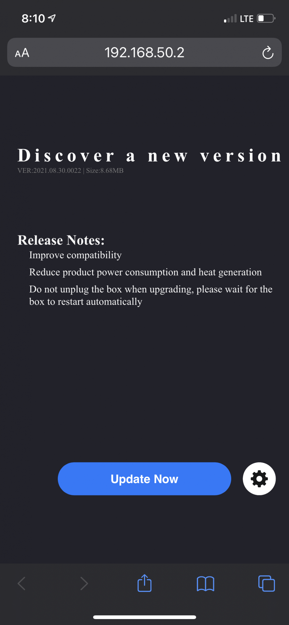

Just saw this new OTA update. Will update and see if things run smoothly
I use the Carplay2air and got the same update. It ran and reported that the update completed successfully. Now the device does nothing. No power to the device whatsoever.
