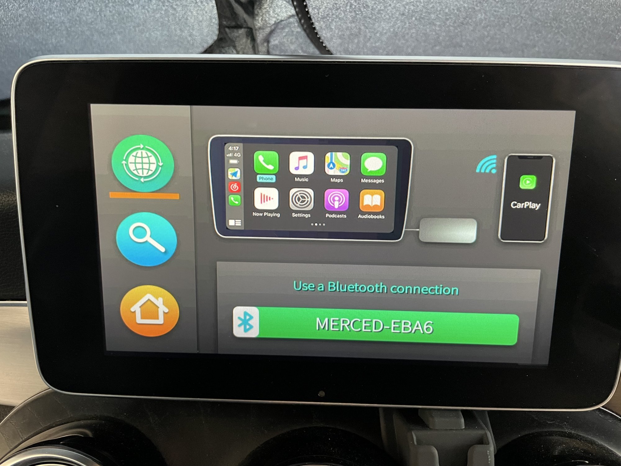

Today I got my Podofo Adapter from Ali. I made the update on 192.168.0.1
But after that I had some issues to connect any device using Carplay. I had to restart my car unit (Mercedes C Class 2019). But after that everything connected again! I also tested Airplay, this is awesome. It worked perfectly with pictures and YouTube videos.

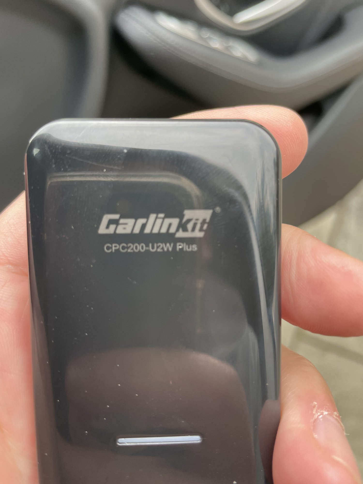

2021.08.30.0022 is finally stable at 350ms latency on both the newer CPlay2Air V2 (glossy case, silver logo, green UI) and older Carlinkit 2.0 CPC200-U2W-Plus (detachable cable, green UI)

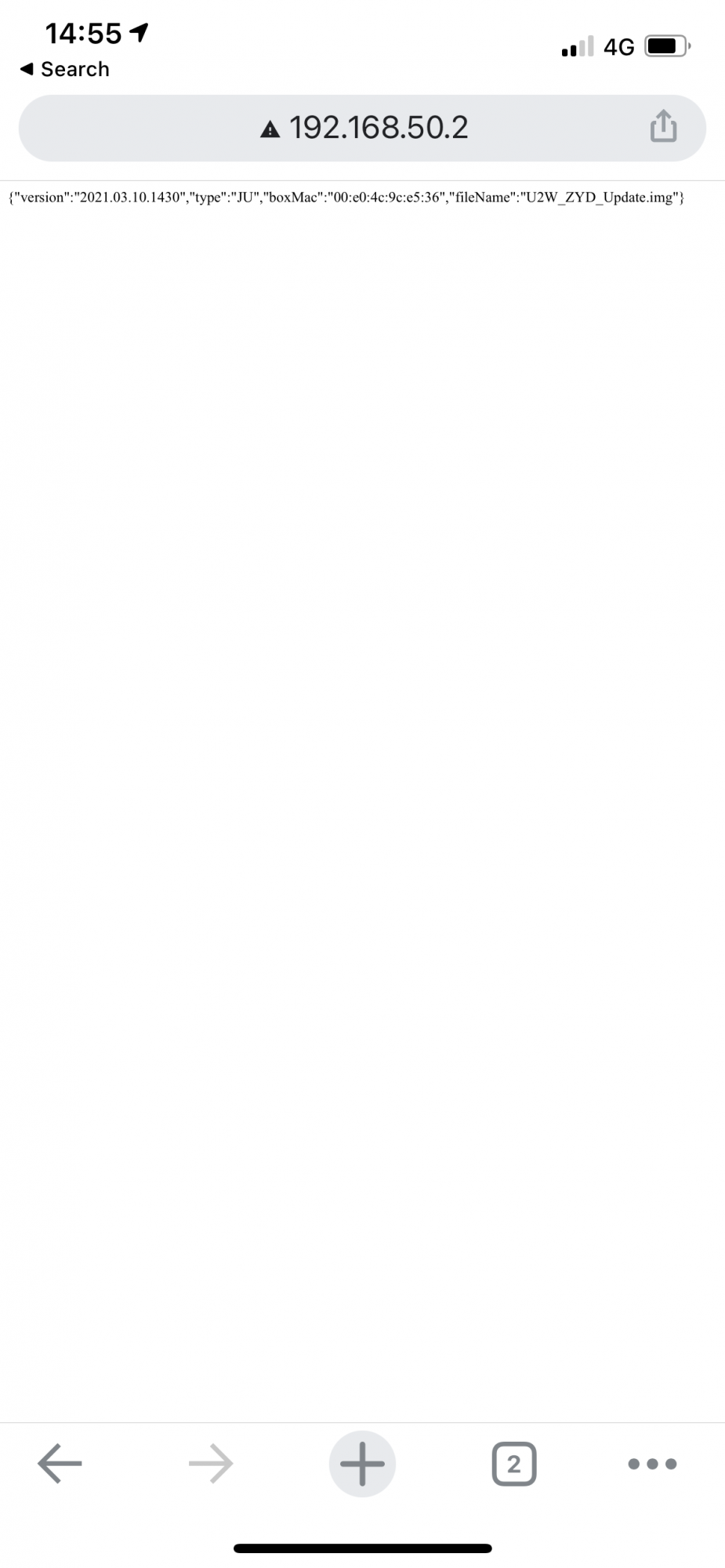

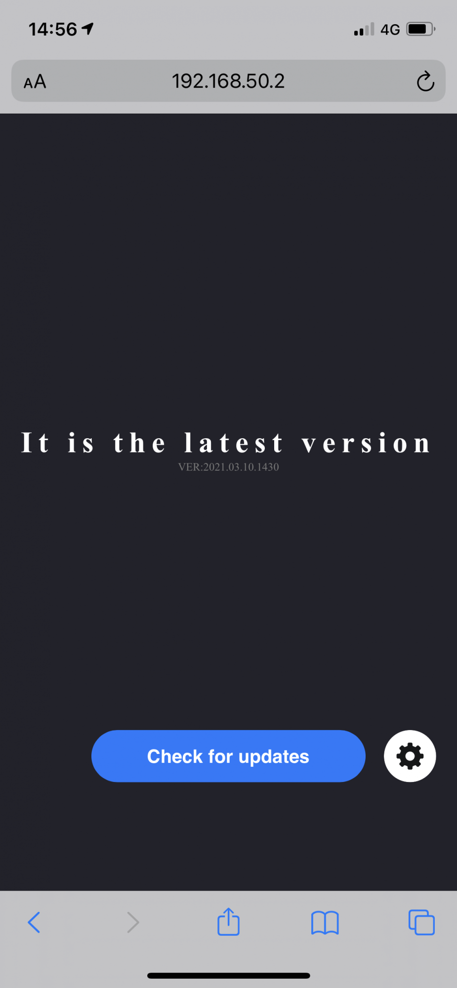

hi, I previously updated my carlinkit device to a custom firmware (2021.03.10.1430) that I can't seem to update/rollback, it has an issue where it doesn't always connect. I would be grateful to know how to return it to the stock firmware. Thanks

Just put the Custom Firmware or any version prior 2021.03.06 and rename the file to U2W_ZYD_Update.img and you will be good to go.
