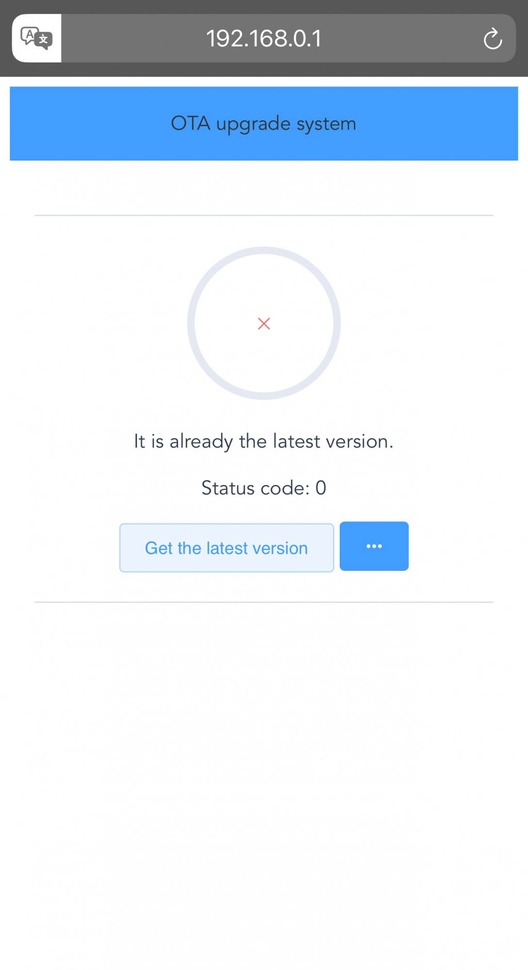

I’ll check my version, but I got one OTA and now says up to date, or there’s nothing there, or this version can’t use OTA?
Did they tel you what the other versions fixed etc?
**edit** actually can’t see what version I have, it doesn’t show on the webpage. How do you check?

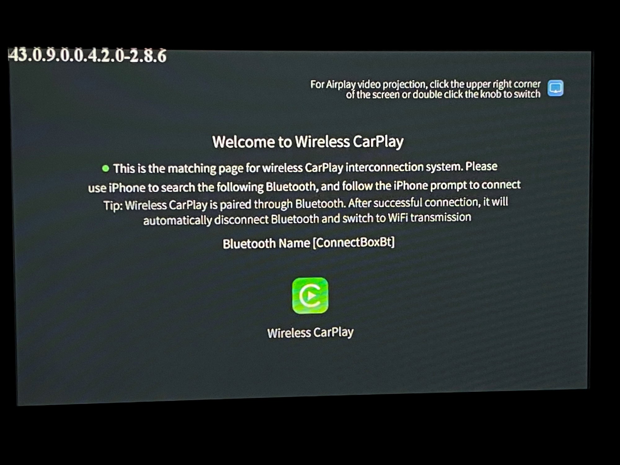

Version can be seen when podofo is plugged in car and CarPlay not connected on phone, on head unit in upper right you will see FW version.
I am now on version 06 and 09 seems to be the latest.

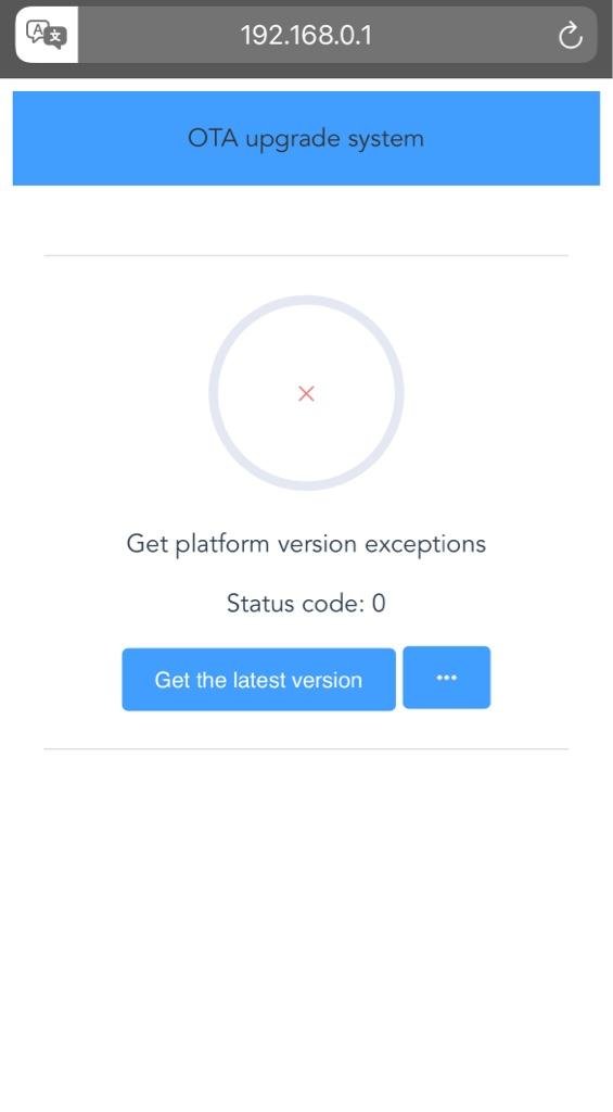

09 is the latest and then shows as error on the web interface. This is normal and due to no newer update available (confirmed by cheerdriving).

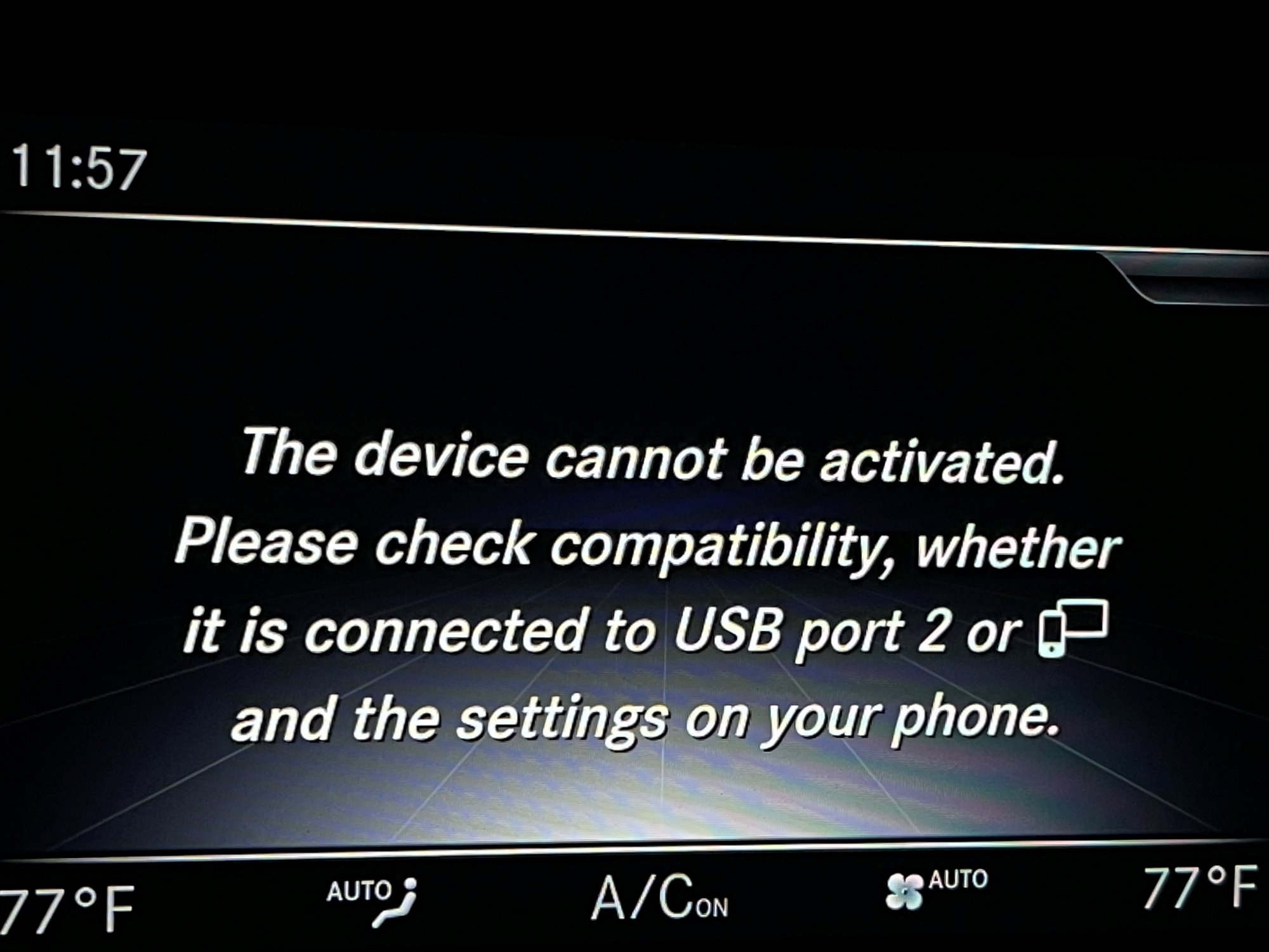

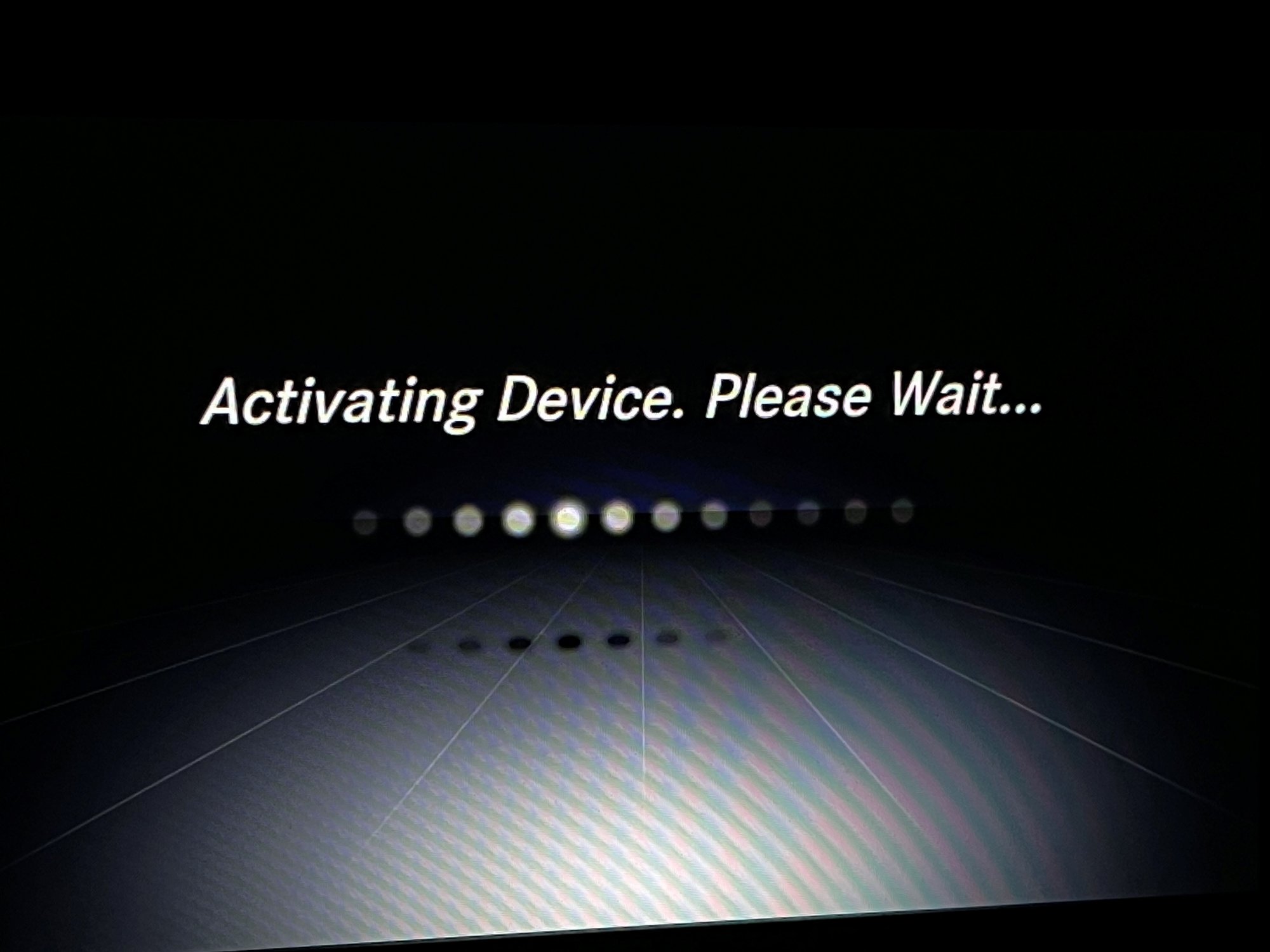

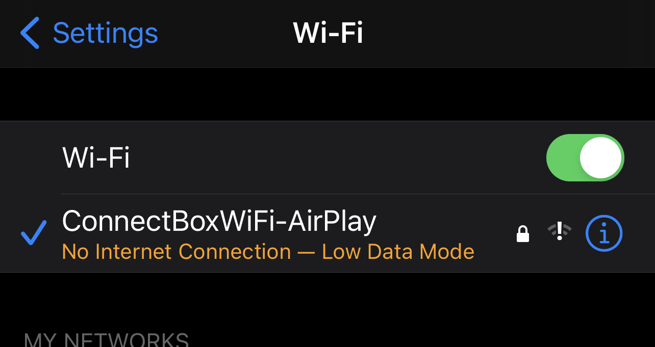

I would recommend not trying AirPlay on ConnectBox yet. I can connect and AirPlay but it completely locks up to go into a reboot loop and car cannot activate the device anymore - no BT, WiFi broadcast either.
I'm guessing some kind of corruption occurs which can only be fixed by reflashing either 43.0.3 or 43.0.9. This could also be because my 2018 car (NTG) is not on the compatibility list.
Here are screens for 09:

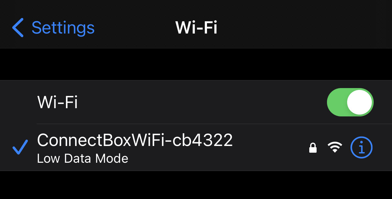

I can’t seem to get to the 192.168.0.1 address at all when connected to the Connectbox WiFi.
