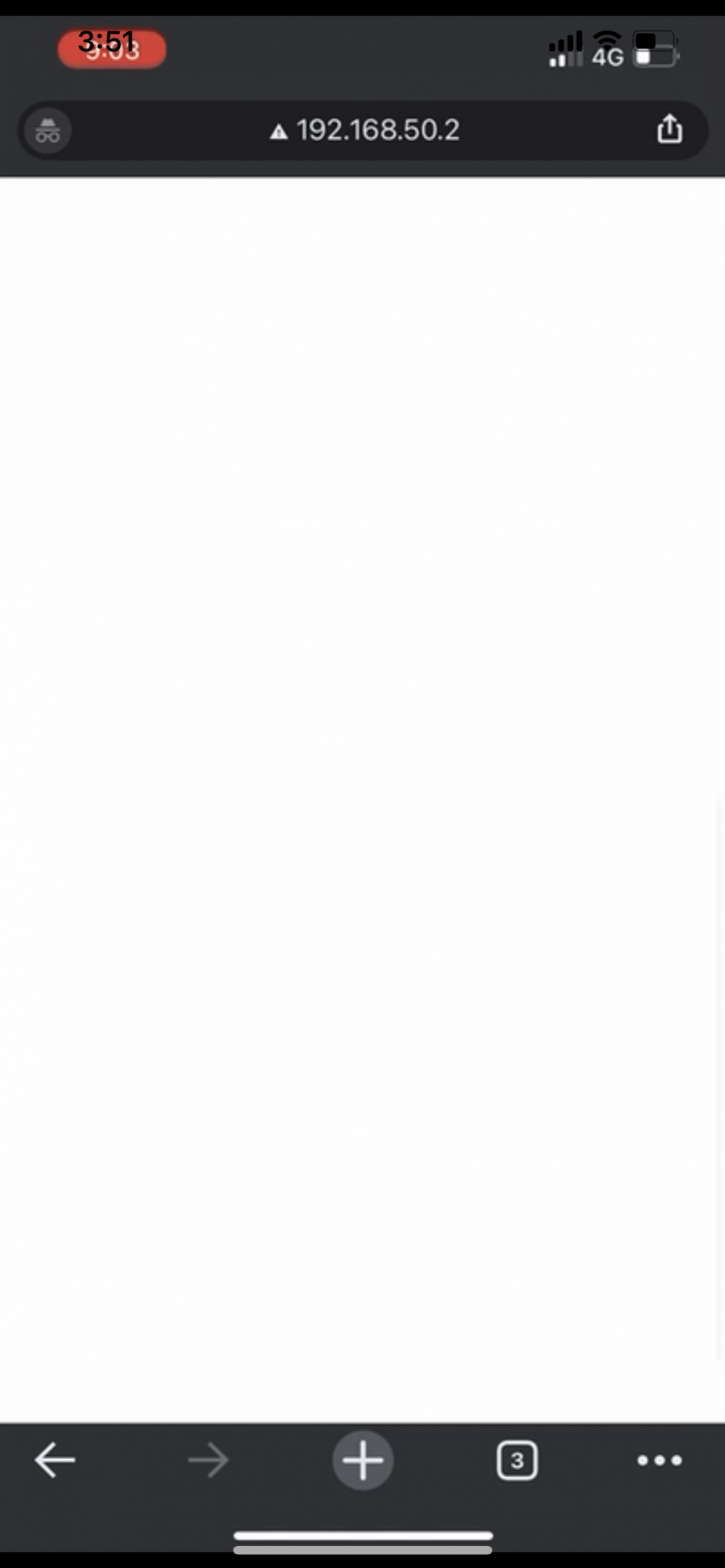

can anyone help with this please we’ve tried the latest firmware and the previous version it is a red ui CarPlay adapter v2 and it won’t let us even check for updates or send logs.
we only get this white screen, any help would be greatly appreciated.

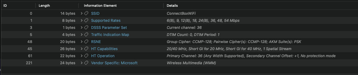

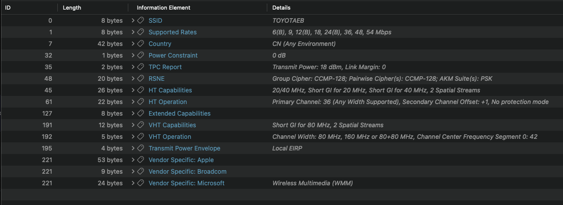

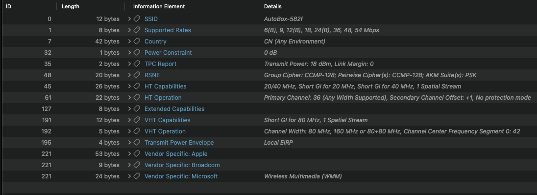

Just sharing some wireless detais/comparison TOYOTAEB==CarLinkit v3.0 & ConnectBoxWiFi==Podofo.
Podofo seems to be running fine on my test drive. Just a bit warm as mentioned earlier compared to the Carlinkit devices. The Carlinkit devices do appear to have better hardware internals as far as I can tell... But obviously both meet the requirements for CarPlay.

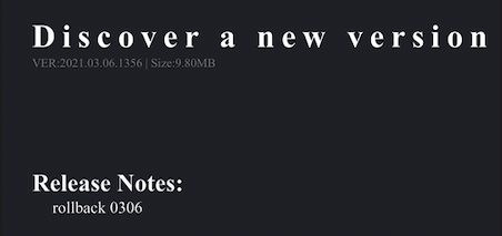

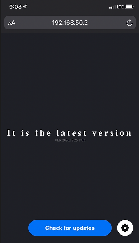

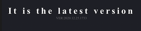

Another update on the rollback... my coffee is finally kicking in a bit.
Here's the play-by-play...
I was able to upgrade using your stock firmware repository to "Firmware/U2W_AUTOKIT_Update_2021.08.24.1817.img" (confirmed as spatial stream reduced to 1, interesting enough, throughout this entire process, the spatial streams remained "1" even after rolling back to the 2020.11.10.2139 firmware).
Per all of the online readme, I tried to use the "Firmware/U2W_Update_2020.11.10.2138_ROLLBACK.img"... No dice. Does absolutely nothing while running the "U2W_AUTOKIT_Update_2021.08.24.1817.img".
Tried your post above @VLud , "VLud said:
Try U2W_AUTOKIT_Update_2020.12.25.1732_ROLLBACK.img instead then. You can't install CFW straight away due to new encryption, nothing new."
-- This sort of works. I loaded it to the flash drive, inserted it... and no blinking red/green... however, the web interface does how the firmware version changed from 2021.08.24 to...
That said, it did this all within maybe 5-10 seconds? No flashing, no reboot... and it also shows the update available:
Disconnecting the USB flash drive after ~5 minutes of sitting, it did reboot.
Post-reboot, it still shows v2020.12.25.1733...

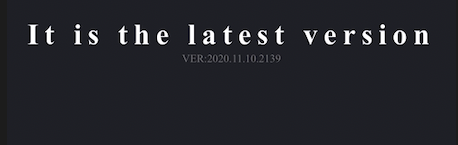

Cleaned off the flash drive and downloaded the "Firmware/U2W_Update_2020.11.10.2138_ROLLBACK.img".
This time, after about 5-10 seconds, the version changed to v2020.11.10.2139... No flashing, no reboot, etc...
I waited about 5 minutes (to give it time to finish any processing/flashing) before disconnecting the USB flash drive.
It rebooted after the flash drive was removed, and shows:
Checking for updates does nothing at this point... No rollback option within the settings...
I tried jumping over to the custom firmware "Custom_Firmware/2021.08.24_BASED/AUTOKIT/U2W_AUTOKIT_Update.img". Does nothing, still shows the 2020.11.20 version...
Power-cycled the device and tried loading custom firmware: "Custom_Firmware/2021.04.26_BASED/AUTOKIT/U2W_AUTOKIT_Update.img"
Tried renaming it to "U2W_Update"and power-cycled the device again.
Did nothing, still shows v2020.11.10.2139...
Downloaded "Custom_Firmware/2021.03.06_BASED/AUTOKIT/U2W_AUTOKIT_Update.img"
Kept the filename as the same... (did not remove AUTOKIT).
Did nothing. Renamed to "U2W_Update.img" and again no dice.
This time I thought I'd try doing the latest file again, including the two script files...
Downloaded: "Custom_Firmware/2021.08.24_BASED/AUTOKIT/U2W_AUTOKIT_Update.img"
as well as the two script files:
"Custom_Firmware/Scripts/Downgrade_2021.03.06/ARMimg_maker"
"Custom_Firmware/Scripts/Downgrade_2021.03.06/U2W.sh"
placed all three files on the root of the flash drive... and no luck, no change. Power-cycled the device and still nothing.
I'm a bit out of steps to try. I'm open to testing more if anyone has any input... but I cannot get it to switch over to the custom firmware. Maybe I am missing something (hopefully not obvious)?

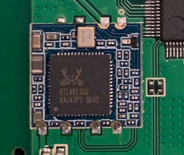

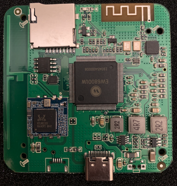

The v3.0 I purchased has the red interface. My original v2.0 had a Green interface (that unit got bricked about a month ago doing an OTA update)... I know I have the v3.0 as opposed to a v2.0 device since the new unit is now wireless AC/WiFi5. My previous v2.0 as well as my original replacement order (which arrived with the Red UI same appearance as the v3.0-WiFi5) both had Wireless N/WiFi4.
I did all steps being powered off my MacBook Pro charger. I was messing around for so long, I didn't want to keep my truck idling for that long, not to mention, I wanted to keep my WiFi Explorer open so I could watch that status of the SSID as it changed, disconnected, rebooted, etc. Because it wasn't powered/connected to my head unit, I couldn't actually see what the device was doing... Just relied on the LED/status light, and some courage... hahaha
If there's a certain step or update between two versions where it would be beneficial to watch the head unit display, let me know. I'd be more than happy to get some screenshots of the updates from the head unit. I just want to stage it before doing all the steps. Likewise, if it would help -- I can crack open the case to verify chip components, etc..
My simple definition of the two devices:
v2.0 == WiFi 4/Wireless N w/ 40MHz, RealTek chip. v2.0 can be upgraded to run the same Red UI, although my original unit never switch UI, always had green even with the 2021 OTA updates.
v3.0 == WiFi 5/Wireless AC w/ 80MHz, Per @VLud it's a Broadcom chip. I also believe these units are shipping with the Red UI only.

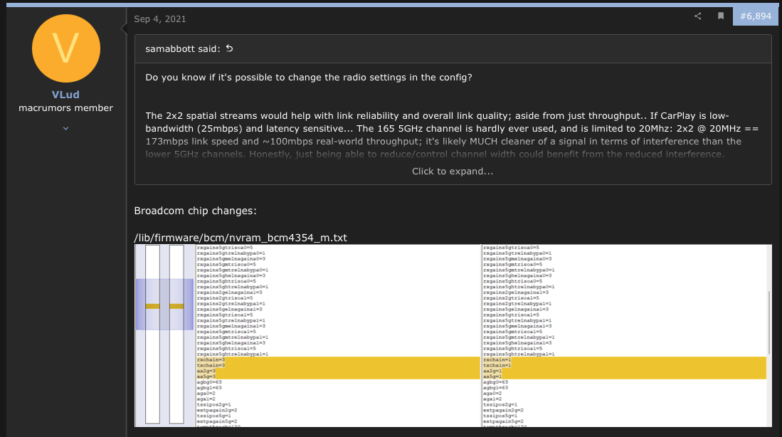

My motivation for switching to CFW w/ my v3.0 (Broadcom chip, Wireless AC/5) is simply to mess with the script files @VLud posted previously. I really would enjoy tinkering with them, and figuring out how to switch the radio width to 20MHz, channel to 165... Just to see if it resolves any of my perceived 'interference' issues. During my commute into the office, I can perfectly predict when my music will start stuttering, sometimes dropping to the point that my phone disconnects from the Carlinkit all together... It happens in the exact same spots on the freeway. Likewise, it happens out in the parking lot of my work (we have some outdoor Cisco Enterprise Mesh APs, so I know the 5GHz band is pretty busy). Using "Network Analyzer" on my iPhone, I can run a constant ping to 192.168.50.2, and watch as the latency increases and packet loss in these specific areas.
Reactions: Mavro
