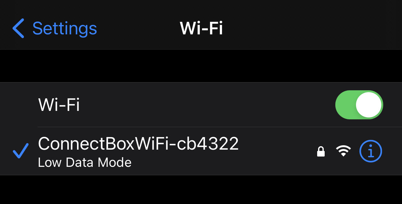

Strange, it only took a few seconds for my updates. While plugged into a non-CarPlay USB port, can you check if it's broadcasting ConnectBoxWiFi-Debug SSID few minutes after power up? If so, you can connect to it with 88888888 password. This should be on 43.0.9 firmware.

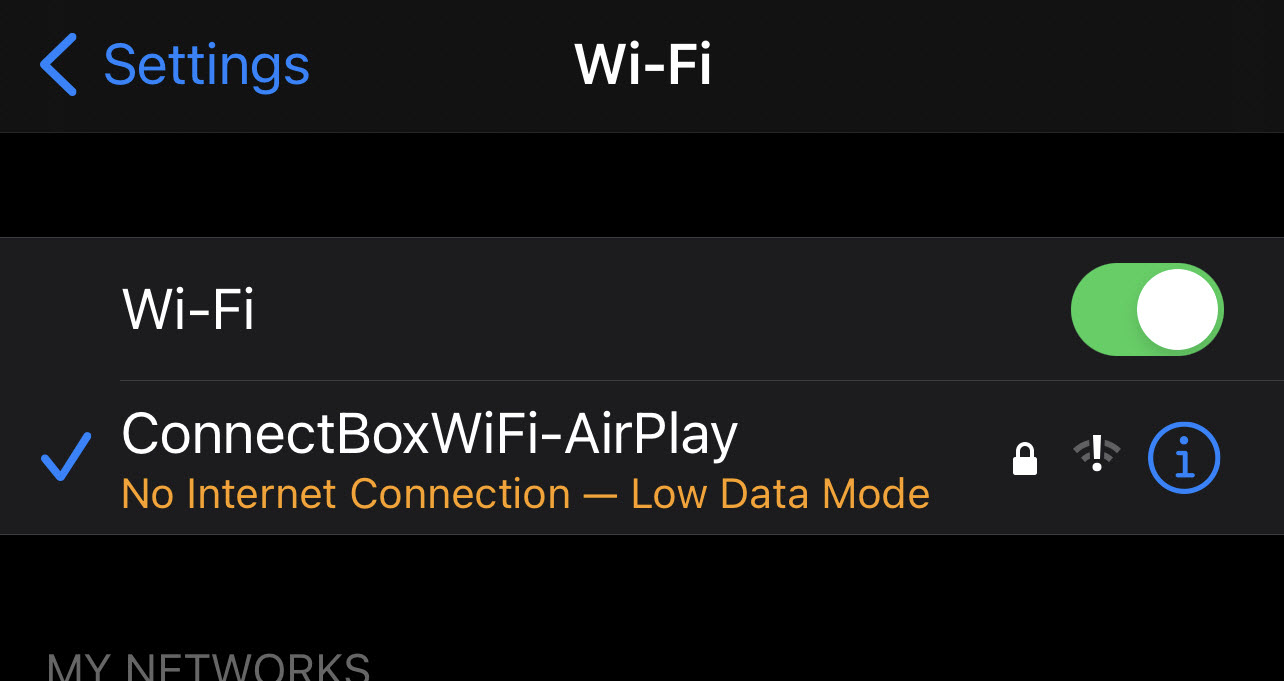

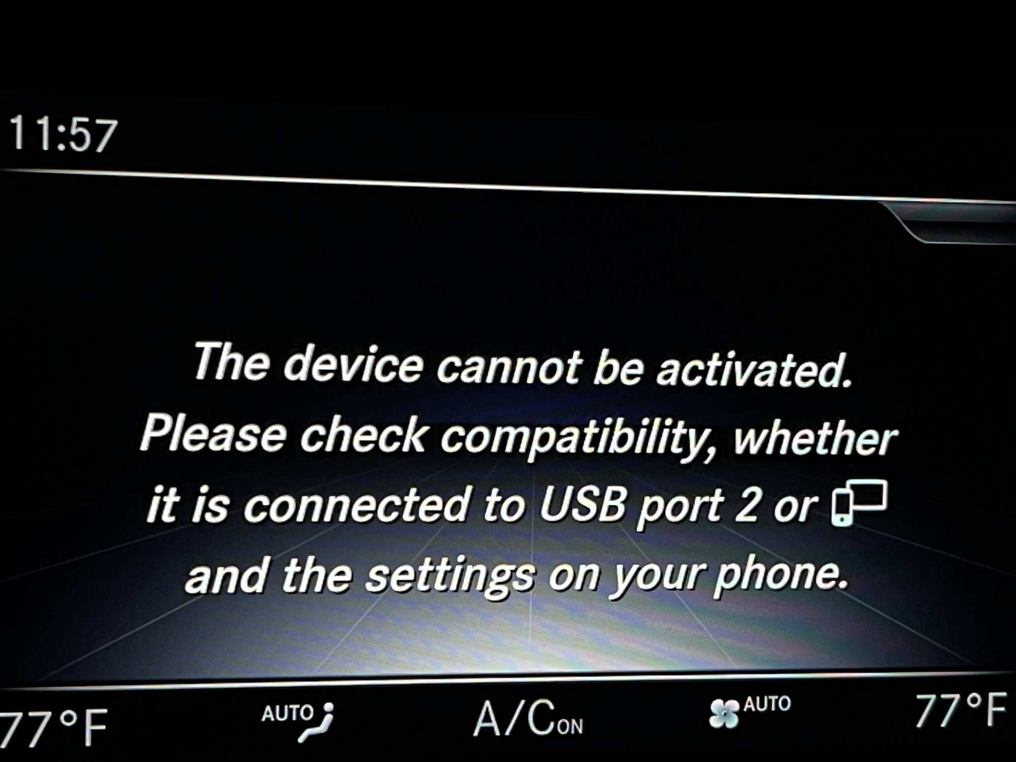

I would recommend not trying AirPlay on ConnectBox yet. I can connect and AirPlay but it completely locks up to go into a reboot loop and car cannot activate the device anymore - no BT, WiFi broadcast either.
I'm guessing some kind of corruption occurs which can only be fixed by reflashing either 43.0.3 or 43.0.9. This could also be because my 2018 car (NTG) is not on the compatibility list.

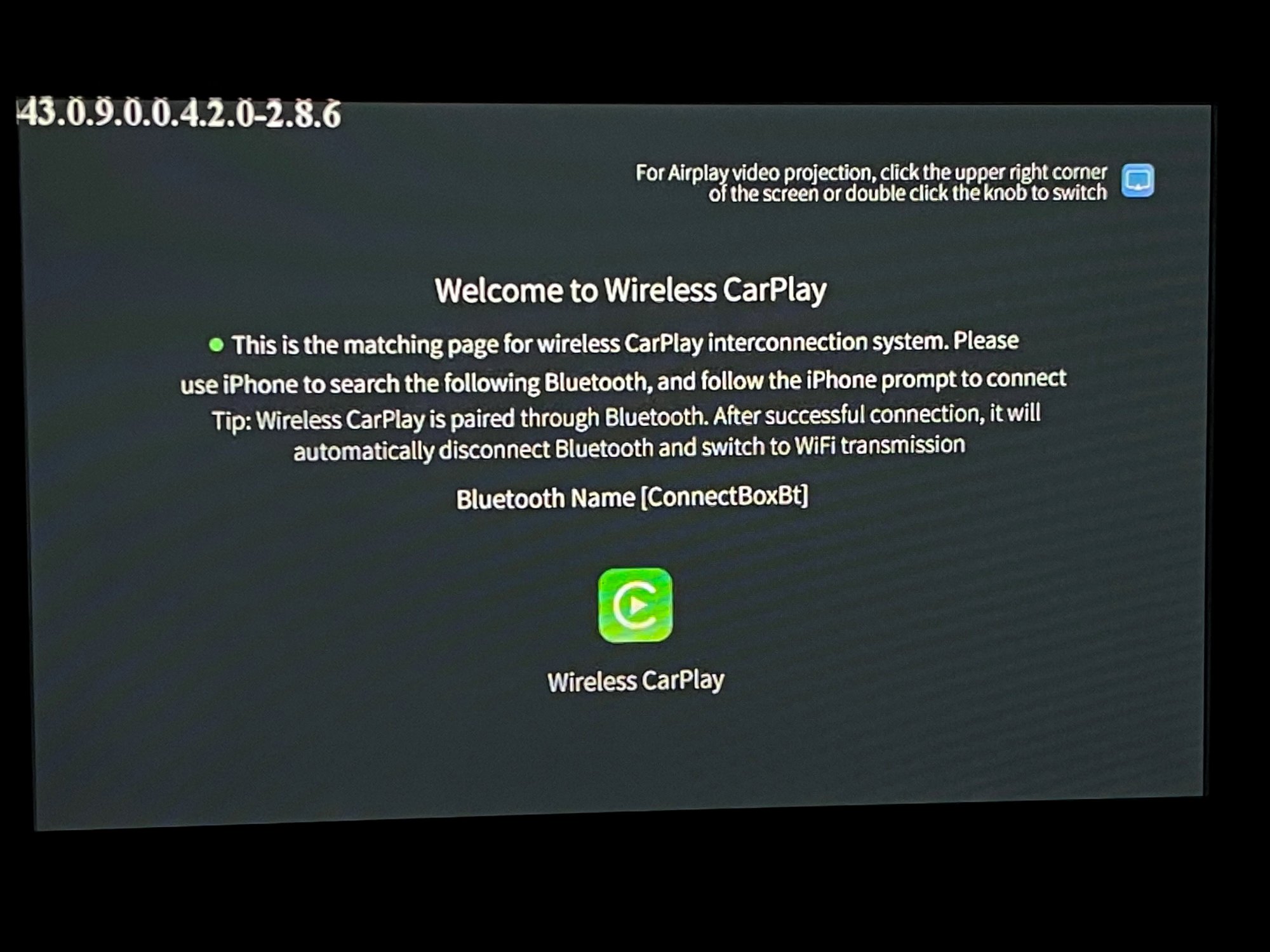

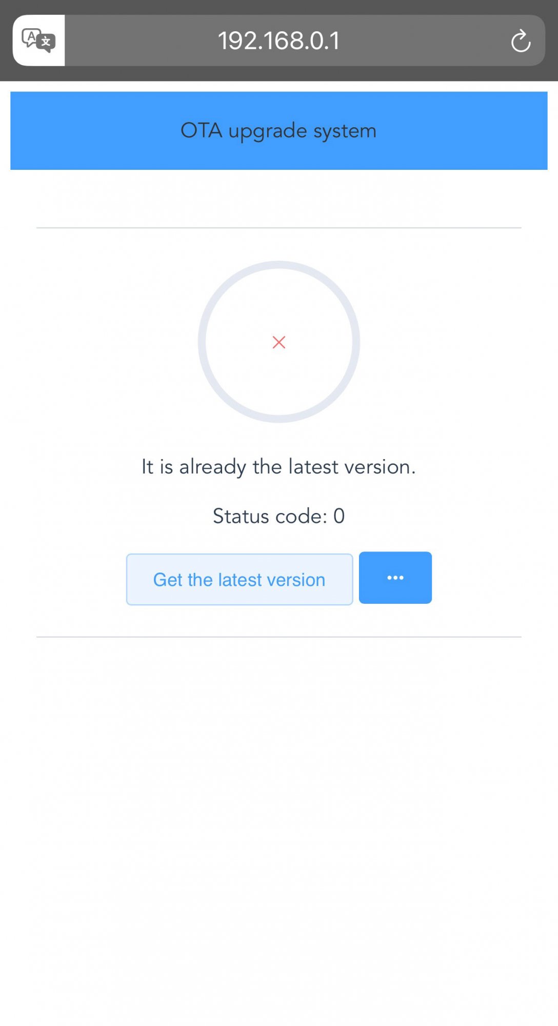

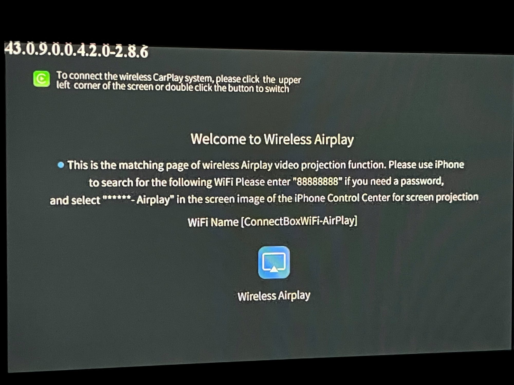

Here are screens for 09:
View attachment 1832256View attachment 1832257View attachment 1832258View attachment 1832259View attachment 1832260View attachment 1832261
How do you get the OTA update menu in English ?
mine is Chinese

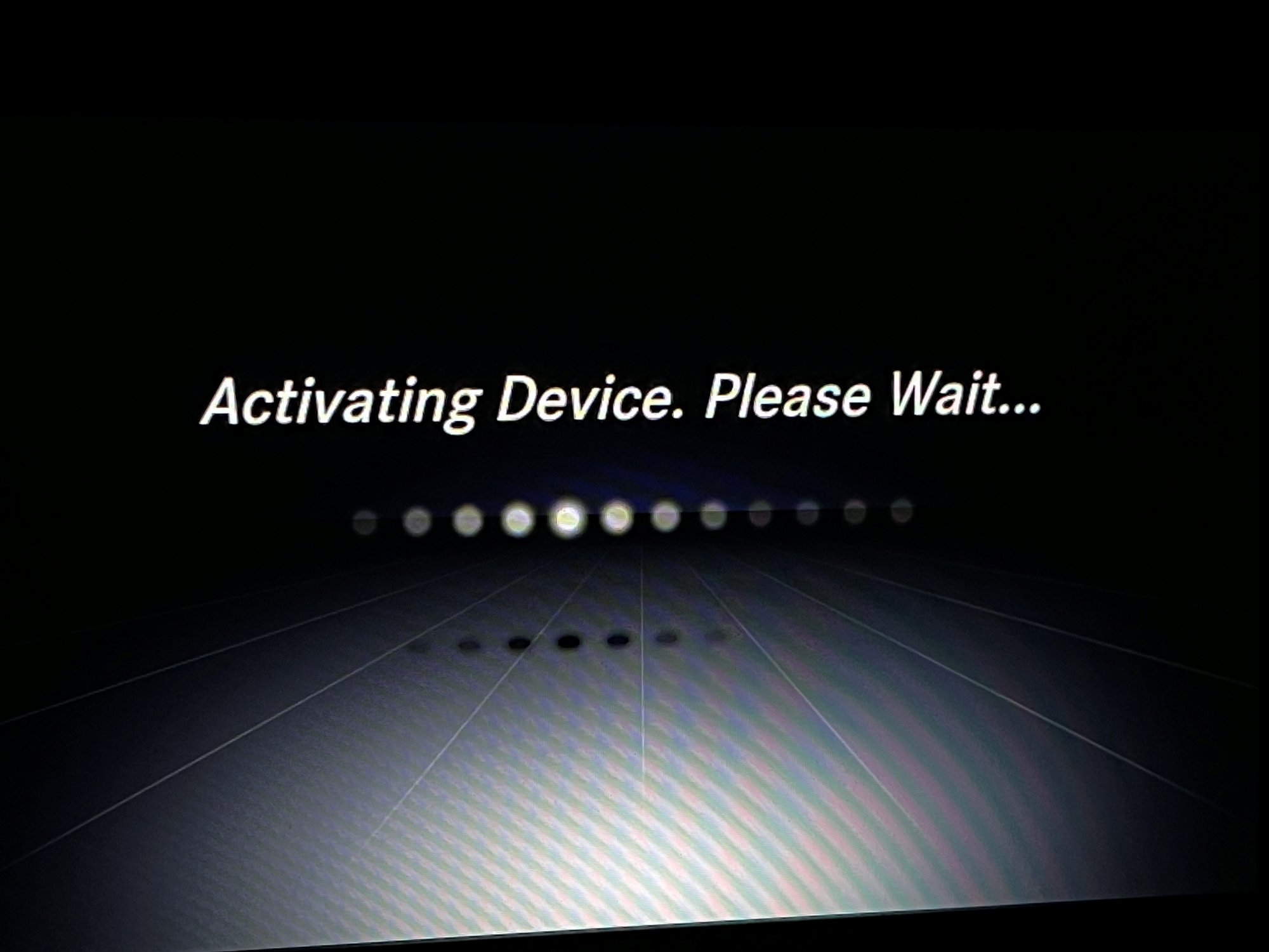

Mazda CX9 with MZD on 70 version (Wired carplay) - doesn't active the splashscreen, bluetooth never shows up 🙁
