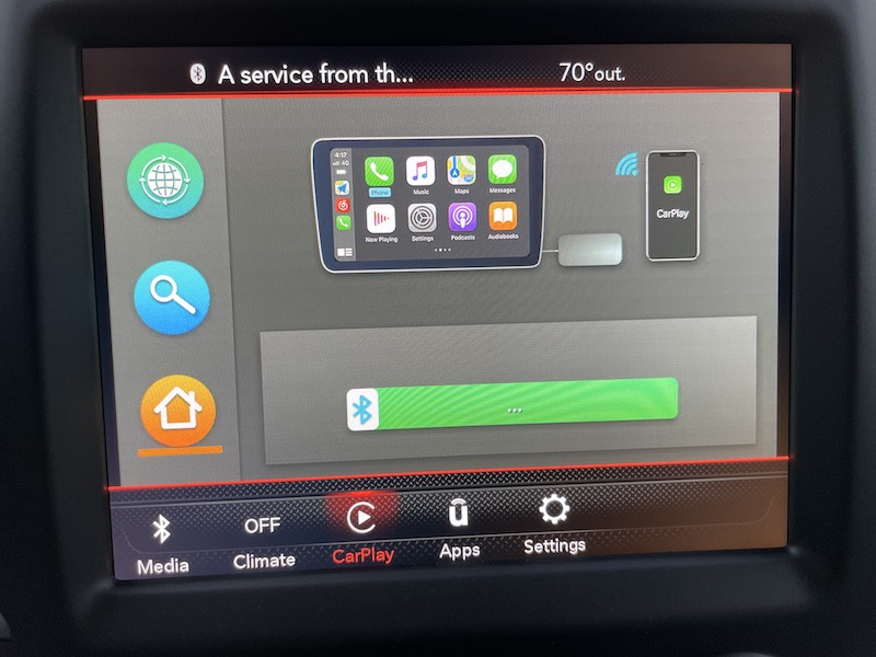

I've been using a Carplay2air (integral USB-A, green interface) for just under two weeks, and until a few days ago, it was reliable. Connection then became hit-or-miss when I'd start up, and as of yesterday, it won't connect at all. I OTA updated the firmware right after installing it, and have not updated again until this afternoon as part of troubleshooting.
When I start up (or plug the CP2A into a wall wart), I now only get a red LED, no blue/green LED indicating Bluetooth. The radio (Uconnect 8.4 in a ‘21 RAM 1500) displays “Media files not found.” I can connect to the WiFi on the unit, but Bluetooth never shows up. I've OTA flashed, as well as with a USB thumb drive, with no change in Bluetooth function.
I've read through a lot (>50%) of this thread, and may try the rollback files via USB thumb drive tomorrow. Just posting this here to see if anyone has suggestions on how to get it working again.
UPDATE
I was able to roll back to 2021.03.06.1355, but still have no Bluetooth (no blue/green LED, either). Was unsuccessful in OTA upgrading from that - it hung at about 30% and now will not re-flash via USB, nor is it presenting a wifi or Bluetooth connection. It appears, for all practical purposes, to be well and truly bricked after less than two week's use.

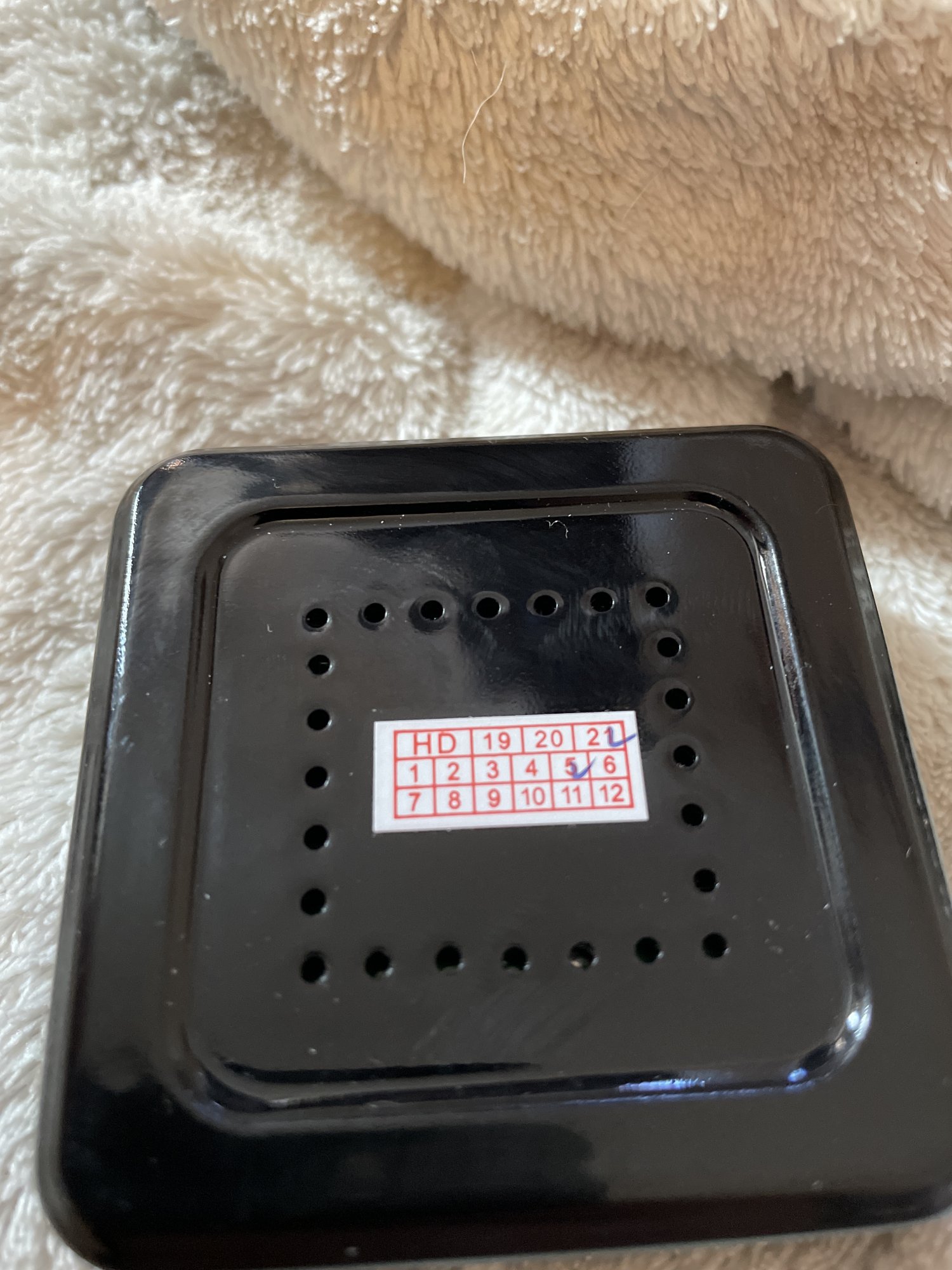

I wonder what number they mean.
the Podofo I got has a red and white inspection sticker but nothing that looks like a serial number
The back of the box the device came in has some numbers. I used that and they approved my request to join the group. Honestly no one has realt posted in the group and you’re not missing much. This thread is more useful.
