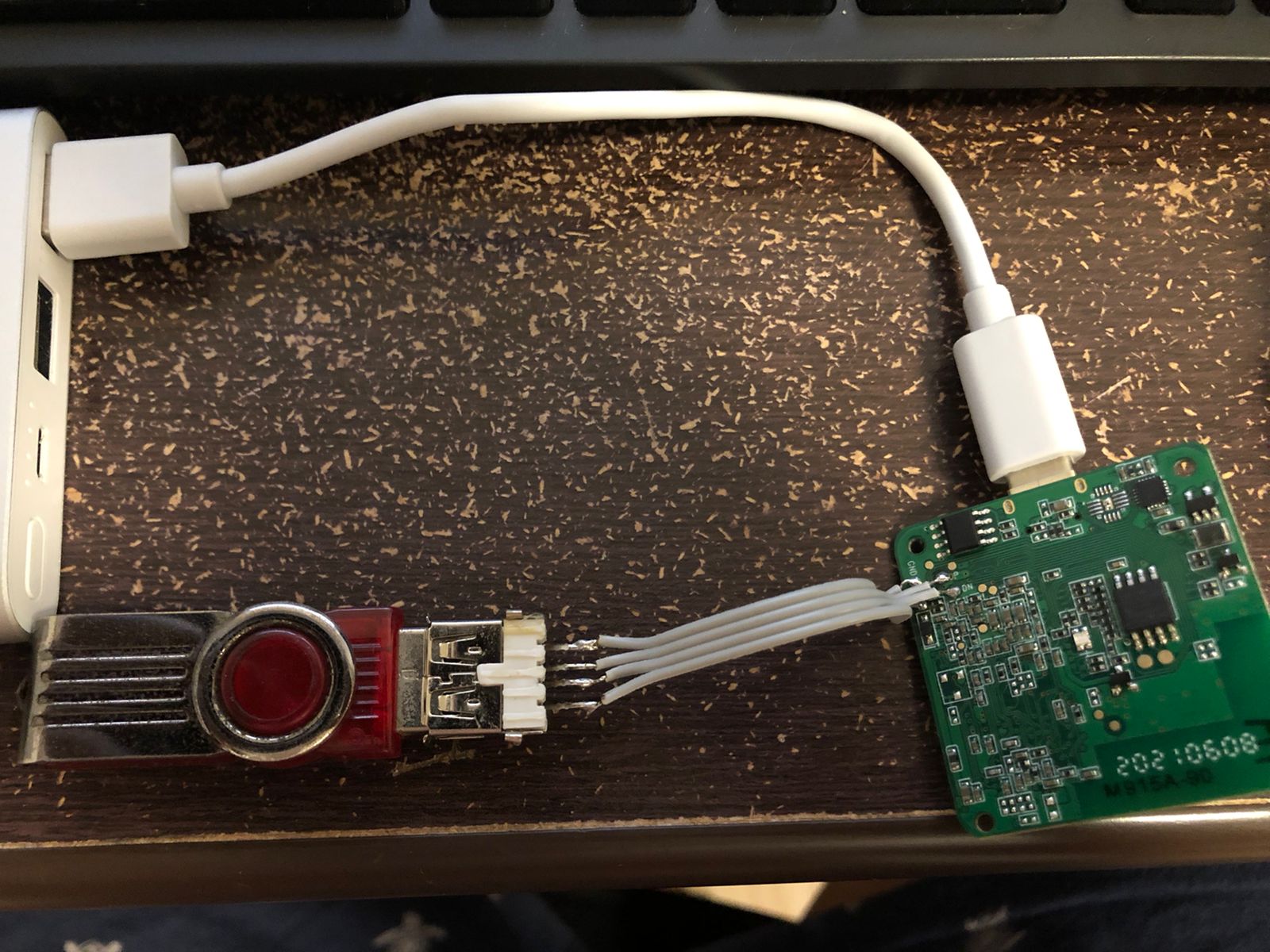

Hey guys!
Does anyone use Carlinkit Mini? I tried to update the firmware and the device stopped responding. It doesnt even turn on the LEDs! Since I'm an electrical engineer, I opened the device and found an USB interface. Then, I soldered an USB A female connector and I tried to upload a rollback firmware. I didn't work tho.
Does anyone have any suggestions? Thank you!
