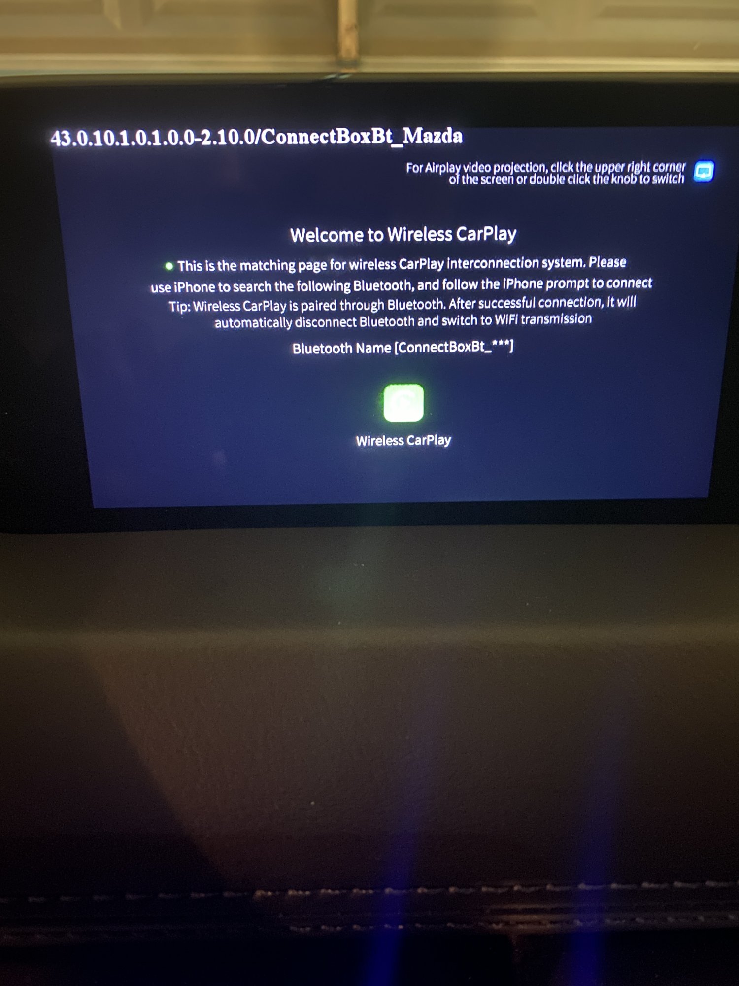

Just wanted to chime in my praises with the Podofo unit in my 2019 Mazda CX-5.
After following all the success stories (with the latest firmware version) with the notoriously fickle Mazda infotainment, I took a chance and ordered it to replace my Gen 1 CPlay2air box (worked, but only after unplugging/replugging every other engine start).
After only a two week wait from China, it arrived and thanks to the link graciously provided here, updated the firmware and with a short test, I’ve been blown away with the night/day difference between the two boxes.
They’re not lying when they say how fast this sucker is.
After the initial setup, once I turned the car off and let the box power down and then restarted, it took about 15-20 seconds to reconnect.
My old unit, once it decided to play nice with my car, would usually take about 45 seconds to a minute to connect.
Only played with it for a few minutes, but will test it out thoroughly on my commute tomorrow for any issues.
Note, that if you have a Mazda and you’re running the latest infotainment version 74.xx (pre Mazda Connect vehicles) you’ll need to downgrade the infotainment firmware before the box will be recognized (I downgraded to 70.00).
Thanks to everyone who has tested this box first and shared their success stories (and failures).
I would never have bothered without your feedback.
Cheers!

Glad to hear another success story. It’s worth noting that the 74.0 firmware Mazda was rolled for 2021 cx5s with wireless CarPlay’s and was never meant for our older models. That being said I know 74.0 made both the carlinkit and podofo incompatible with our vehicles. 70.0367a should be the working version.

Sadly, after a day and half, my unit has bit the dust (well I at least still get the connection screen, but no longer pops up under Bluetooth on my phone).
Oh well, you get what you pay for.
Back to the slower CPlay2air.

Strange. Maybe you can try deleting the connectbox from your carplay and Bluetooth and then try to pair it again?

Yeah, it was very strange.
One minute it worked and after a quick stop, only the connection screen would come up.
Deleted the CarPlay and Bluetooth profiles to start from scratch and it now refuses to be recognized.
Spent over an hour troubleshooting, before ceding defeat.
It was nice while it lasted (just believe I got a defective unit).
