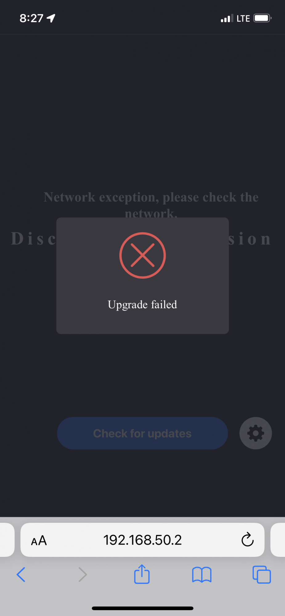

Latest Update Fails on the original version 2 cplay2air device. Upgrade worked on version 3 device. 🤷‍♂️
