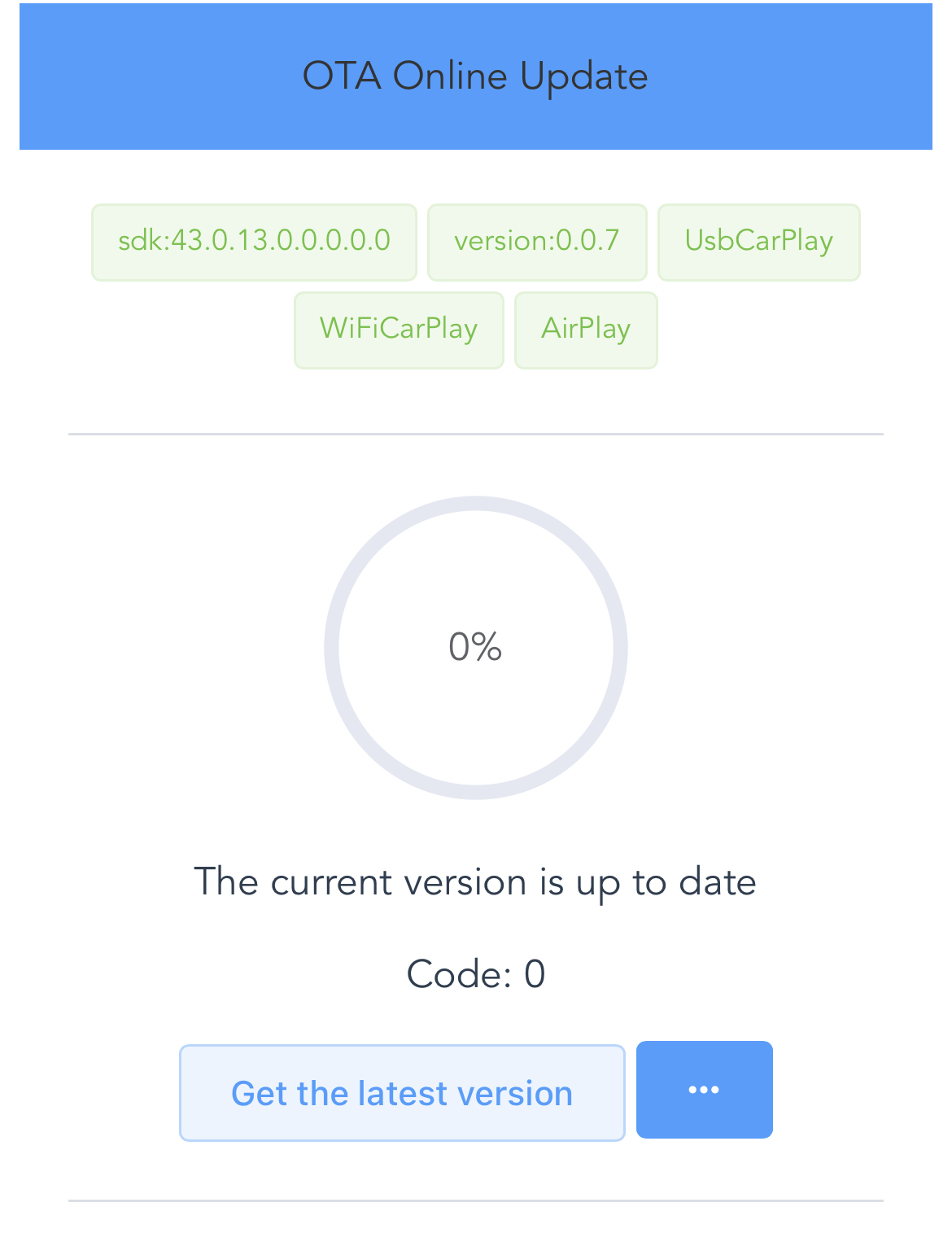

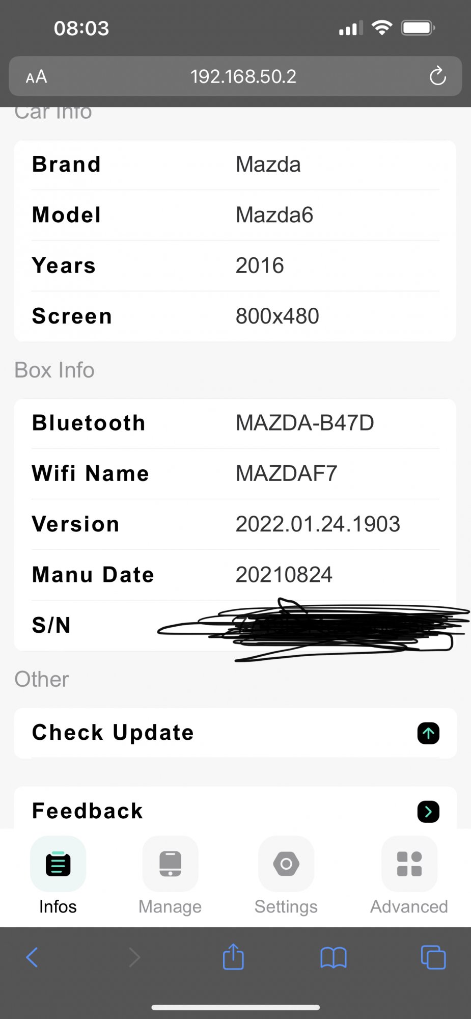

Does your firmware page look like this?
Yeah this is the update page for both the Amazon and Ali express device. Other than the serial number sticker on the bottom of the device they are identical. Both of them have now booted with no video only audio several times from both my and my wife’s 13 Pro. Additionally I haven’t figured out how to switch from one phone to the other, I sure hope it’s possible. I’m on Mazda firmware 367 but might try changing that to see if there is any improvement.

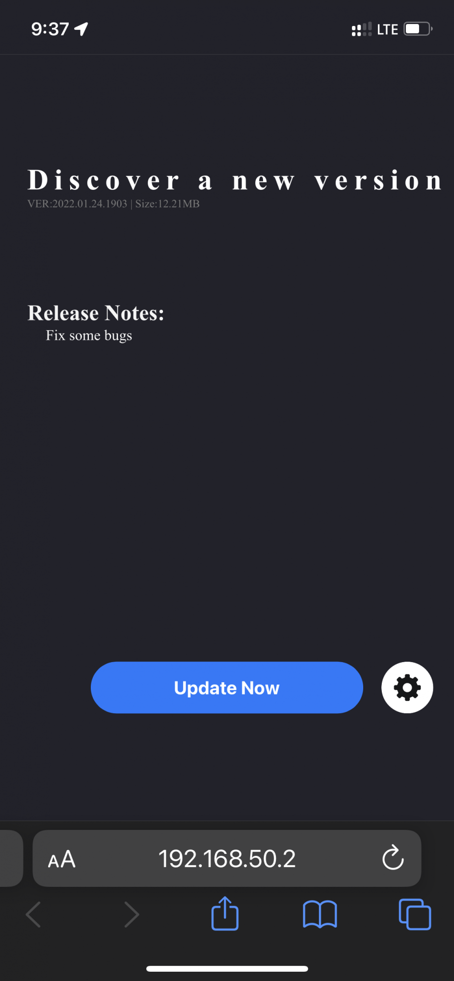

Carlinkit has a new update that completely overhauls the web UI. I am likely to return the Cheerdriving adapter due to the frequency of it not working. Hopefully the Carlinkit will work beyond 70 minutes now or in the future.

All versions of CarLinkIt? Any screenshots to show us?
It killed my V2 just now. It took about a minute flashing red and green but then I got nothing. No LED light what so ever.
Scanned Bluetooth and WiFi, nothing.
