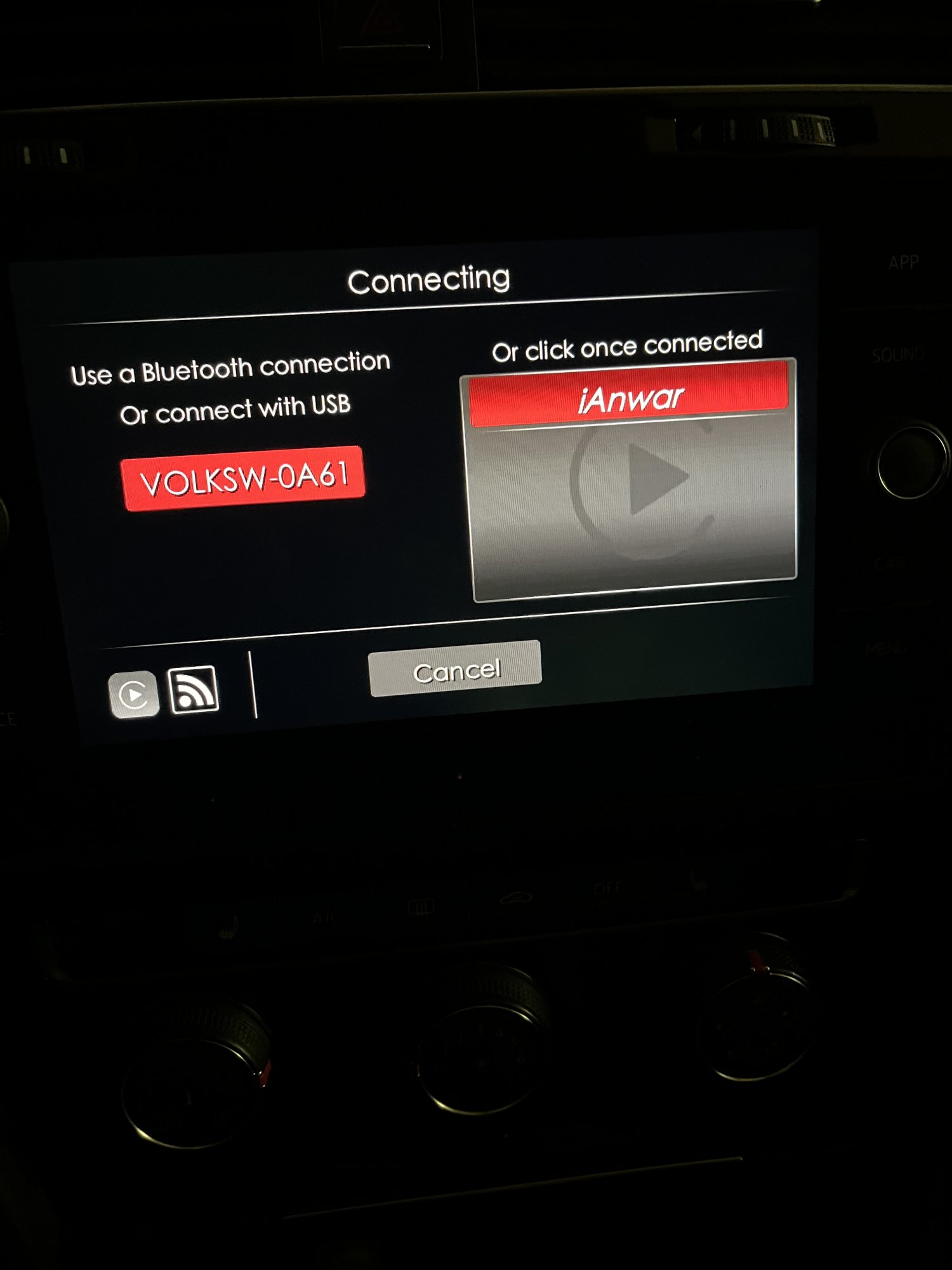

I bought a Carlinkit v3 adapter with red UI. Unfortunately, it doesn't work with my car (Golf MK7) and stuck on connecting mode like shown on the pic below (iPhone 13 on iOS 15.1.1 / I have tried an iPhone X and same issue)
There is any fix for this ?
Thanks in advance

Well, your car is detecting the adapter. Issue seems to be the connection between adapter and phone.
What does BT & Wi-Fi status show on your phone?
BT should connect initially until the phone's Wi-Fi connects to the adapter's ad-hoc network.
Thanks for ur reply.
The phone connects to the adapter's BT but can't connect to the adapter's wifi automaticly! And when i get the connecting message on the car interface (like shown on the pic) the red light flashes on the adapter
Then I tried to connect the phone manually to the adapter's wifi (password 12345678), the green light flashes but it shows the same interface on the car (connecting...)
When it's connected to the WiFi, can you pull up the webUI in a browser and see if it has any pending firmware updates?
If you cannot connect, you can manually upgrade/downgrade with a USB stick to the offical 'AutoKit' based firmware first from ludvig-v's repo.
Yes i can
I upgraded the firmware but still the same status...
