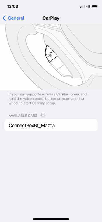

Today, I have received CheerDriving. then tried to install to my MX-5, Results is failed at this moment. Ummm.
- Version is shown, 43.0.11.0.0.0.3.0-2.10.2
ConnectBoxBt_MAZDA is appeared on my iPhone BT screening, then select it. but ”Paring Unsuccessful" is show up.
and not move to WiFi connection.
My Mazda connect is 70.00.351. JP M
and I confirmed my iPhone SE and Xs. both were same situation.
I appreciate if you post any advice for my situation.

Try to go to the iPhone settings then CarPlay and leave it on that screen, turn on the car and wait for the cheerdriving to show up in the other cars section. Select it there to see if that makes the connection.
Thank you very much for your comments.
But I'm still failed.

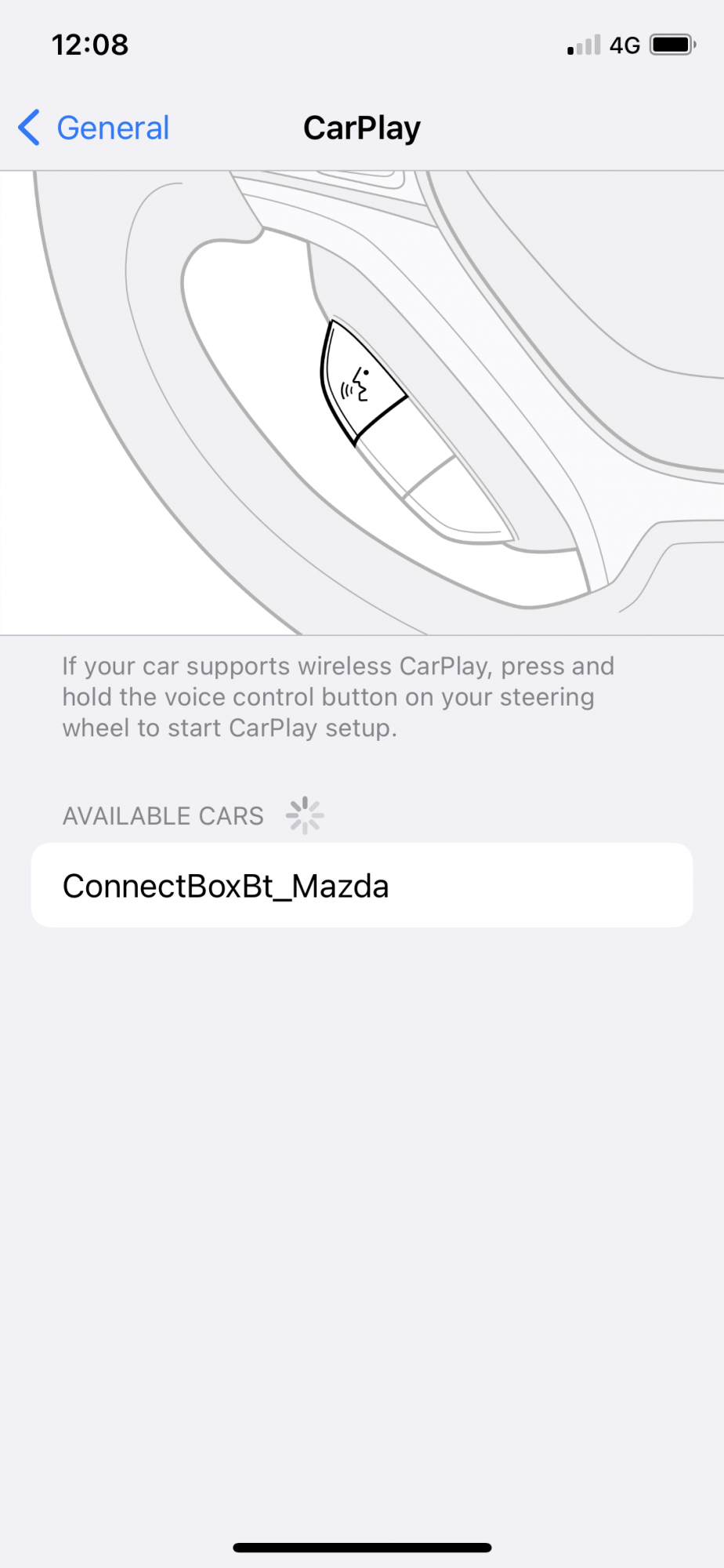

I tried it with in settings, then move to CarPlay, and wait. then turn on my MX-5.
As I attached. "ConnectBoxBt_Mazda" is displayed, then I selected it. but nothing happened for my iPhone. and no change display on my MX-5 as well.
Hi MAZDA users

Hi, Thank you very much for your information.
I did firmware updating by memory card. It is same revision with 43.0.11.0.0.0.3.0-2.10.2
But unfortunately, I didn't resolve my issue. It is no changed to wifi connection from Bluetooth selection.

Hi, Thank you very much for your advice.
I have tried with my spare iPhone. This iPhone have cleared all of settings.
However, Bluetooth connection was failed unfortunatelly. I suppose an issue is coming from Cheerdriving adapter side.
it might have physically broken, but Bluetooth menu show up "ConnectBoxBt_Mazda". so I'm guessing it is software issue. So I'll try it again if new FW is released.
I appreciate your information if you have MX-5 (4x3 display) and CheerDriving adapter.
