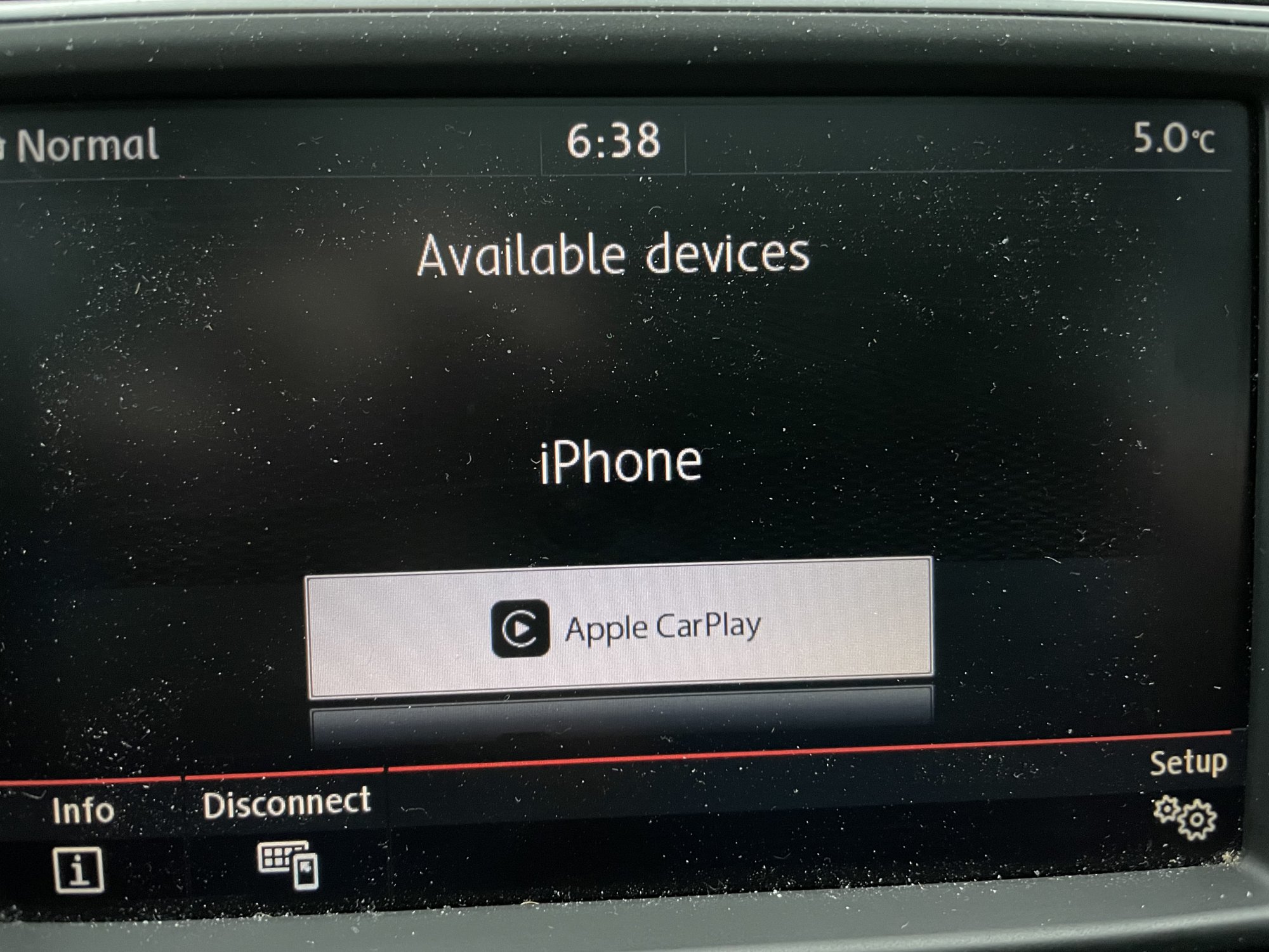

Brand new carlink 3 since I bricked my last one with their ota update. It shipped with the January update but…. Every time I receive send or read an sms this screen comes up and have to press it to get things back to normal. Anyone experienced this ? Tried resetting but no joy. Thinking 🤔 maybe to roll back to august 21 firmware as that’s the only option provided to see if it works without that annoying glitch.
What car model are you driving? I have that issue before as well with my VW 2017 MK7.5 Golf GTI, what I did to solve this issue was to delete both bluetooth, Wifi and CarPlay on my iPhone setting, and reboot the car infortaiment system and reset it to the factory mode. and then repaire it again, that should be fine. Let me know if that helps. Good luck!
2017 Golf GTI.
Ugh I hesitate to reset the info system, reinputting all my radio stations etc. But sounds like it worked for you with similar vehicle. Thanks for the input.
Are you on the January Firmware for the carlink as well ? want to make sure as I think issue is from that update perhaps.
2017 Golf GTI.
I have a 2019 Golf GTI; you almost certainly don't need to reset the entire infotainment, just start with AppConnect (CarPlay) and Bluetooth. You can reset them individually in the Settings menu towards the bottom. I'm on the January firmware with the Carlinkit 3.0 and it works flawlessly for me.
Thanks I will give that a try tomorrow and see what happens.
2017 Golf GTI.
Yes, i have the January updated firmware as well, it works fine with me so far. Try it out first with Kurt871's approach and if its still doens't work, try my approach(it's a bit annoying indeed to have all the settings redo again,lol)
And it might be also worth trying with redo the firmware update on the dongle to see if it's properly done.
same with mine as well, it works just ok. The biggest prb for me now is that i need to wire another cable to charge my iPhone, we intended to eliminate wires by using the dongle but somehow it makes the situation a bit more complicated as we need to wire another cable from another USB port to charge the phone, lol
If you're feeling adventurous, it's not impossible to retrofit the wireless charging cubby in there 😉 https://www.golfmk7.com/forums/index.php?threads/oem-wireless-charger.378650/
