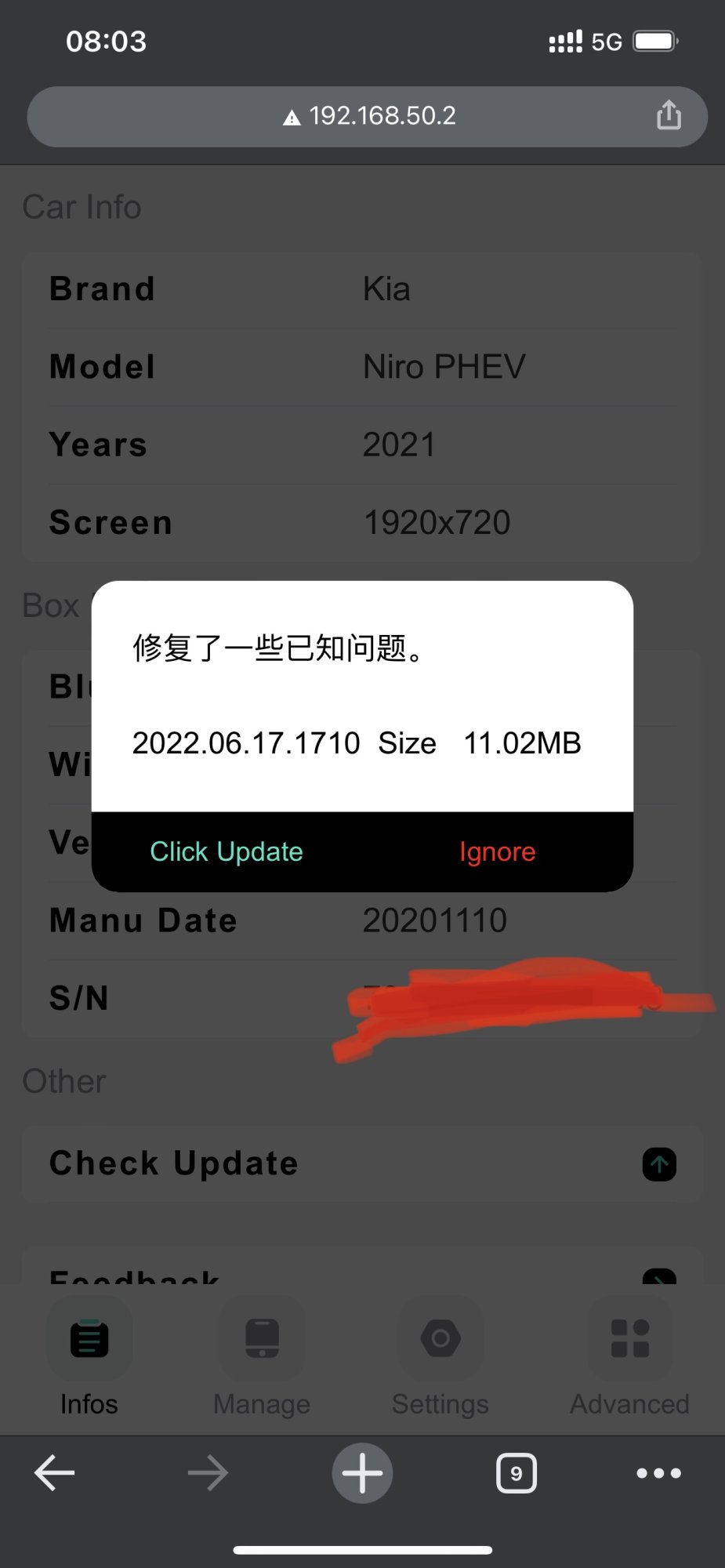

There is a June 2022 update available for the CarLinkit. Just writing to report that I went on a 2 hour long drive with a Carlinkit 3.0 that didn’t freeze on me. Around half way through I did leave the vehicle so CarPlay probably reconnected without me noticing, but maybe this is fixed?
Edit it is not fixed, still crashes on a clock.
Yes my carlinkit 3 received an update yesterday too. It seems to be a little more stable.
So hopefully any time soon also for the Cay2air dongle.
I updated my Carlinkit (red UI) with the June 2022 software. Now I get the message that Carplay will not be supported. I have a Mercedes with MBUX.

Try reset the adapter in the advanced menu and check if it works after that.
