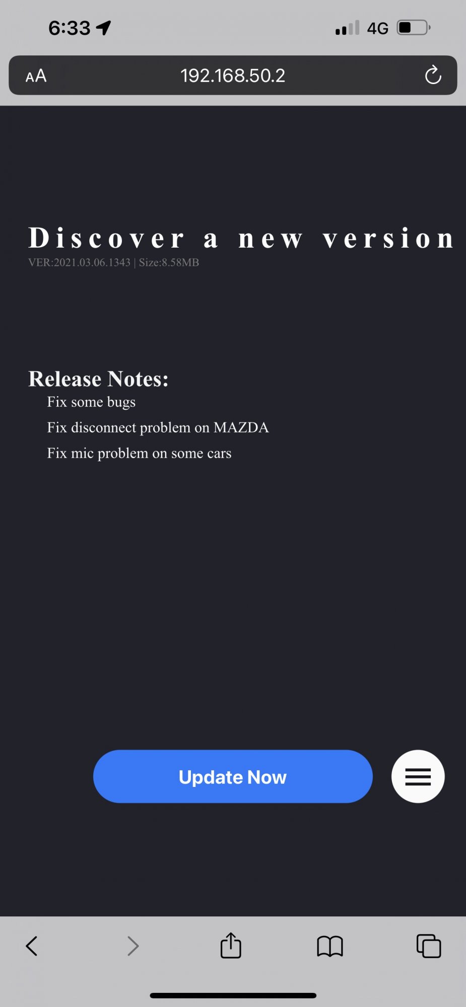

Hi All,

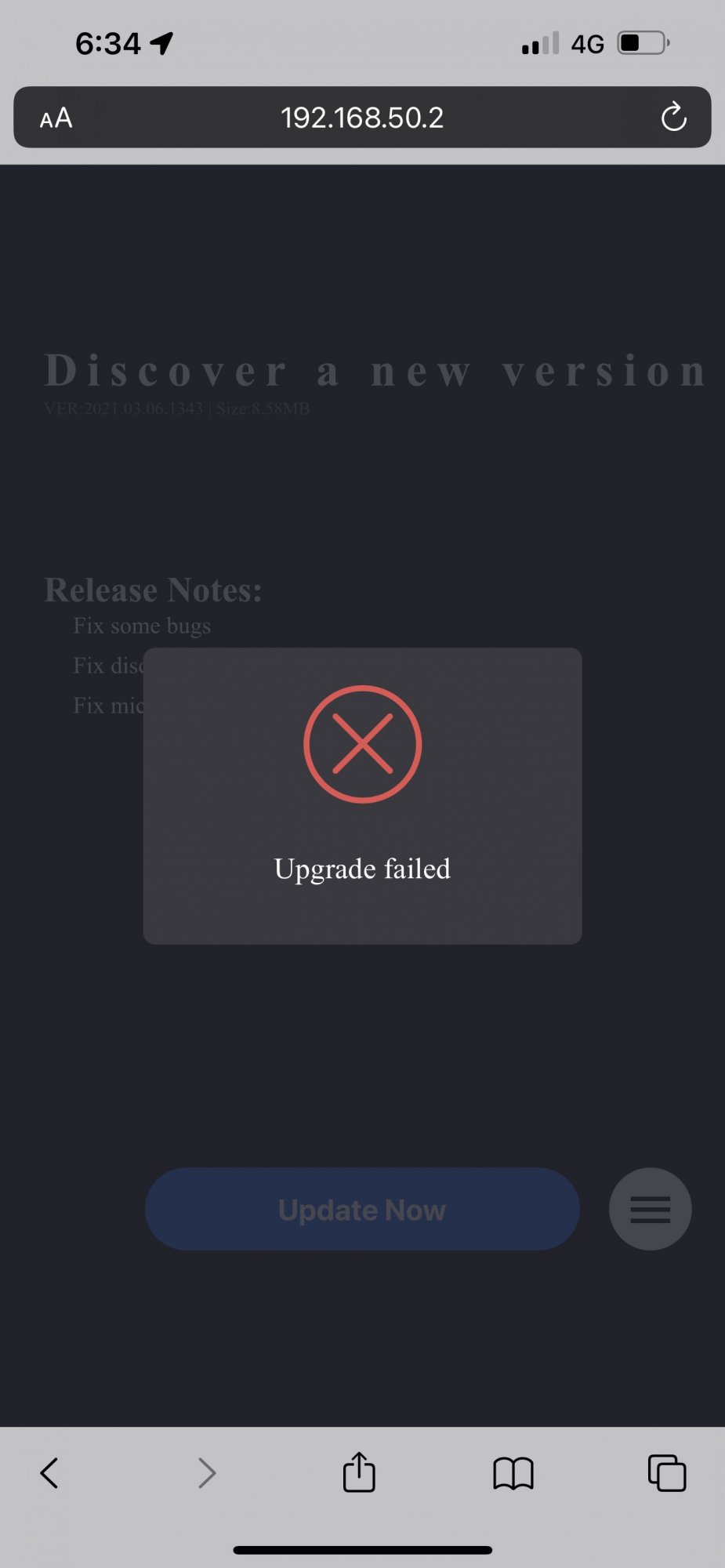

I have a really old v2 USB-C CarPlay Adapter, it won't allow any OTA update to complete it shows a new version available being 2021.03.06.1343. I have tried literally every USB firmware update, tried them as U2W_Update.img (was a Green UI). I have even tried renaming the rollback to U2W_AUTOKIT_Update.img and also tried U2W_SYD_Update.img with no luck.
I just don't understand why it isn't accepting any firmware, just shows red light when connected to AC power using a 10W USB wall adapter. Every time doing the OTA update it says Upgrade Failed.
Any advice would be greatly appreciated.
In terms of the file name, all that matters is what the UI is now. So if at some point you upgraded it to the new-style red UI then you must use "U2W_AUTOKIT_Update.img" as the file name. Conversely if it is still on the green UI then the only file name that it will recognize is U2W_Update.img"
Try a different USB stick (small capacities like 8GB or less seem to work better for this) and make sure it's formatted as FAT32 using the MBR scheme. It can be helpful to use a flash drive that has its own activity LED, so you can see at what point in the boot process the Carlinkit accesses it (if at all). You should also try a different USB power brick. If you have an authentic Apple iPad one those are known to work well, but lots of others should be fine too.
Also, you can experiment with putting the USB stick in the adapter before connecting it to power, or letting it boot up until you see the red light and then inserting the USB stick. I've had it work both ways, but depending on how quickly your USB stick mounts maybe it matters in some situations.
If you continually strike out then you might try flashing VLud's custom firmware (plenty of links to his GitHub earlier in the thread, or you can just google it).
I've been able to take my v2 USB-C Carlinkit all the way up to the most recent January 2022 firmware. My old v2 with the captive USB-A cable is orphaned on the the August 2021 firmware, but I think that's because it has the smaller rootFS partition. Any USB-C Carlinkit should be able to go to the current firmware revision.
Reactions: DeanCorp
Thanks for the reply.
Unfortunately, it won’t accept any update, tried using two usb sticks. I’ve confirmed it is correct formatting as I have another dongle and it accepts the upgrade/downgrade. This one in particular shows the red light (and Wi-Fi) but won’t let me downgrade regardless of what firmware version I try.
I tried the roll back, 2021.03.06 and vlud original firmware version which was 2020.08.04. I renamed as U2W_Update.img and U2W_AUTOKIT_Update.img neither started the process. It’s a shame the OTA version doesn’t have a rollback option, as that’s all I need to get it working. It is a usb-c version.
Rollback:
And the update it is trying to load on but fails OTA:
Any help would be greatly appreciated.
Rollback:
Hi, what FW are you using right now ? Is it vlud custom fw ? , then you would like to use official fw ?. if so it is required to use script. #6323 is my experience.
I believe it would have 2021.XX.XX before the 2021.03.06 as it keeps showing that update available. It’s definitely a green UI, but I have been unable to load any firmware or even custom, because no firmware file will be accepted. That is why I even tried the U2W_AUTOKIT_Update.img and none worked.
Happy to try anything at this point. If only the OTA version had a roll back I would be able to sort this out as the wifi still works. Won’t connect in any car just red light.
