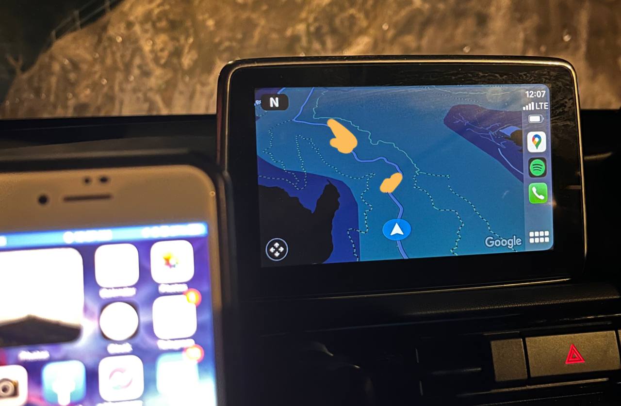

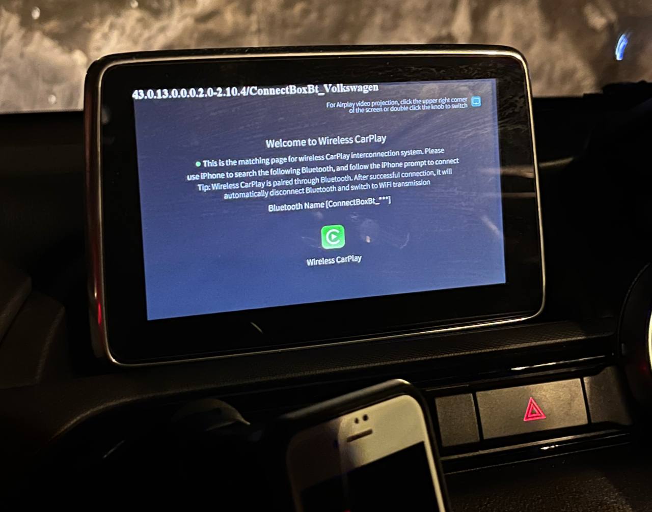

Hi bro
my mx5 running 70.00.367 4AN.
my box is working.
running 43.0.13.0.0.0.2.0-2.10.4
latest fw in
CheerDriving ConnectBox Version20220429---All models except Mercedes-Benz with original touch screen
Are you in japan? because you use the JPM firmware?

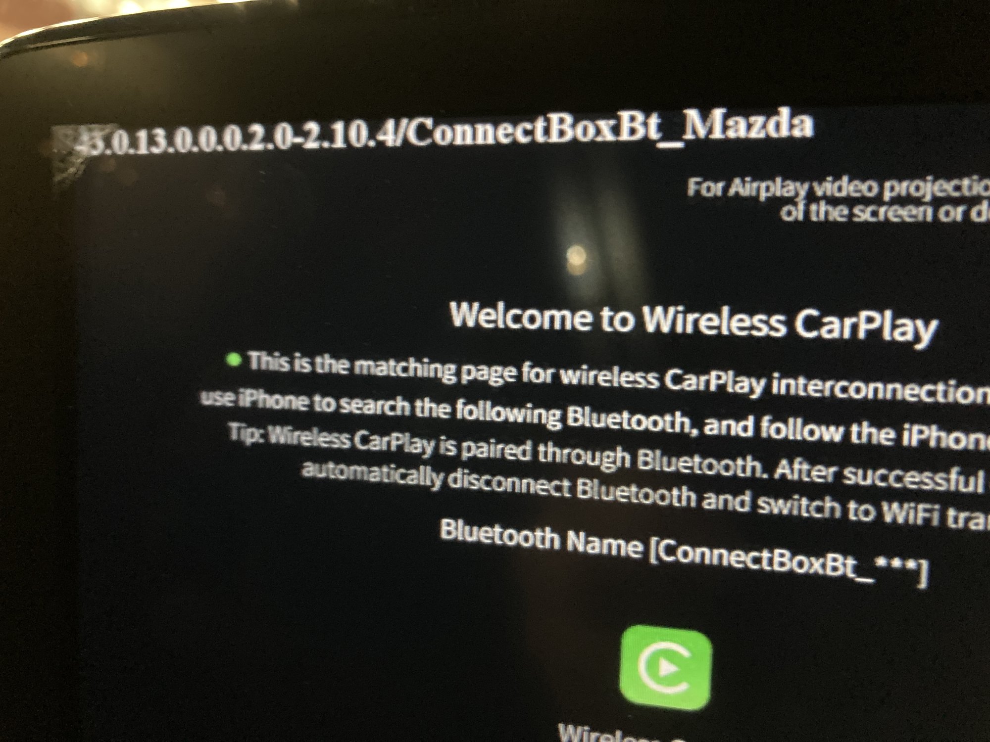

Hi nikkotsoi,
Thank you very much for your information.
Yes, my MX-5 is Japan. so my Mazda connect FW is 70.00.351 JP M
I have confirmed my CheerDriving Connect is 43.0.13.0.0.0.2.0-2.10.4, It is same with your ConnectBox.
but I found small difference between your box and my box. I believe it doesn't matter.
My CheerDriving is shown 43.0.13.0.0.0.2.0-2.10.4/ConnectBoxBt_Mazda,
and your CheeDriving is 43.0.13.0.0.0.2.0-2.10.4/ConnectBoxBt_Volkswagen.
I'm not sure this is a reason for my issue or not. but I still have issue for Bluetooth pairing phase. so I can't connect to CheerDriving.
If I have a chance, I would like to update for my Mazda Connect to 367 instead of 351.
Sometimes I have issues with the Bluetooth pairing phase as well, disabling Bluetooth on the MZD might help.

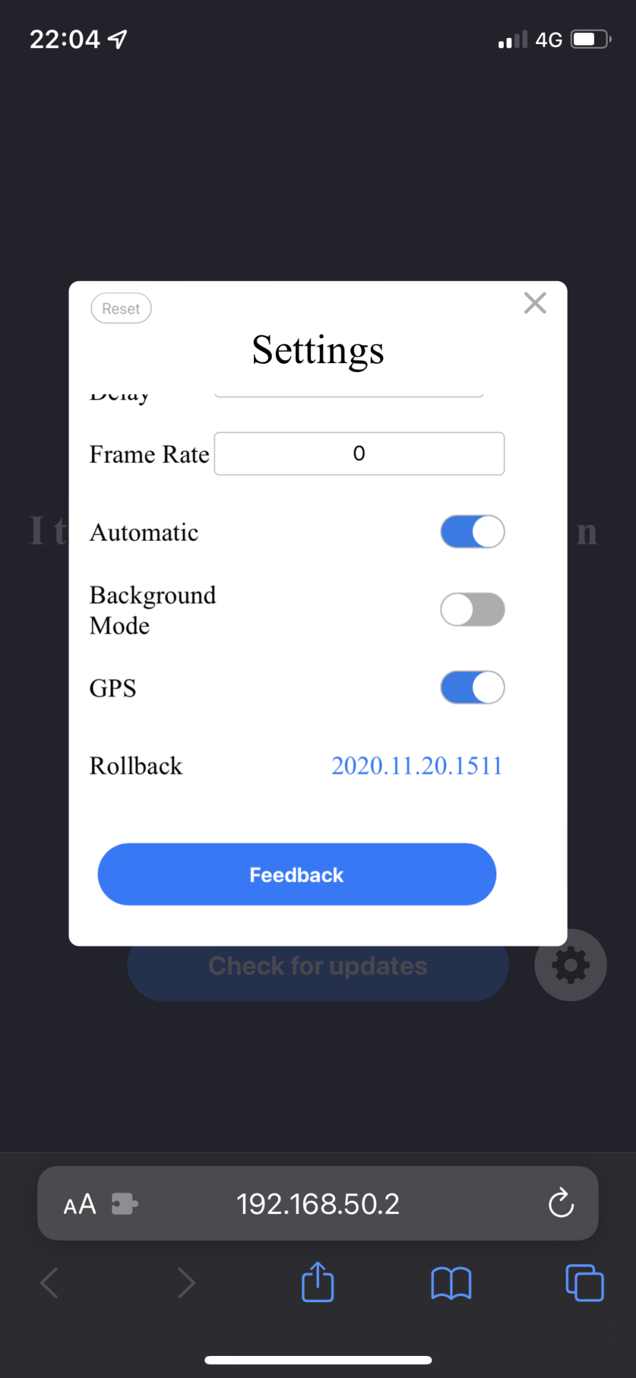

Strange but... I can't! Nothing occurs when I load that Rollback firmware to the USB Drive. Is that normal?
In the settings I can see a Rollback option, maybe I can try to do that from there. But it's to 2020.11.20.1511. What do you think?
Try that. I just want any firmware other than that 2021.03.10. It isn’t an official version.
It starts to download but when arrives at 100% it shows a message: "Upgrade failed".
