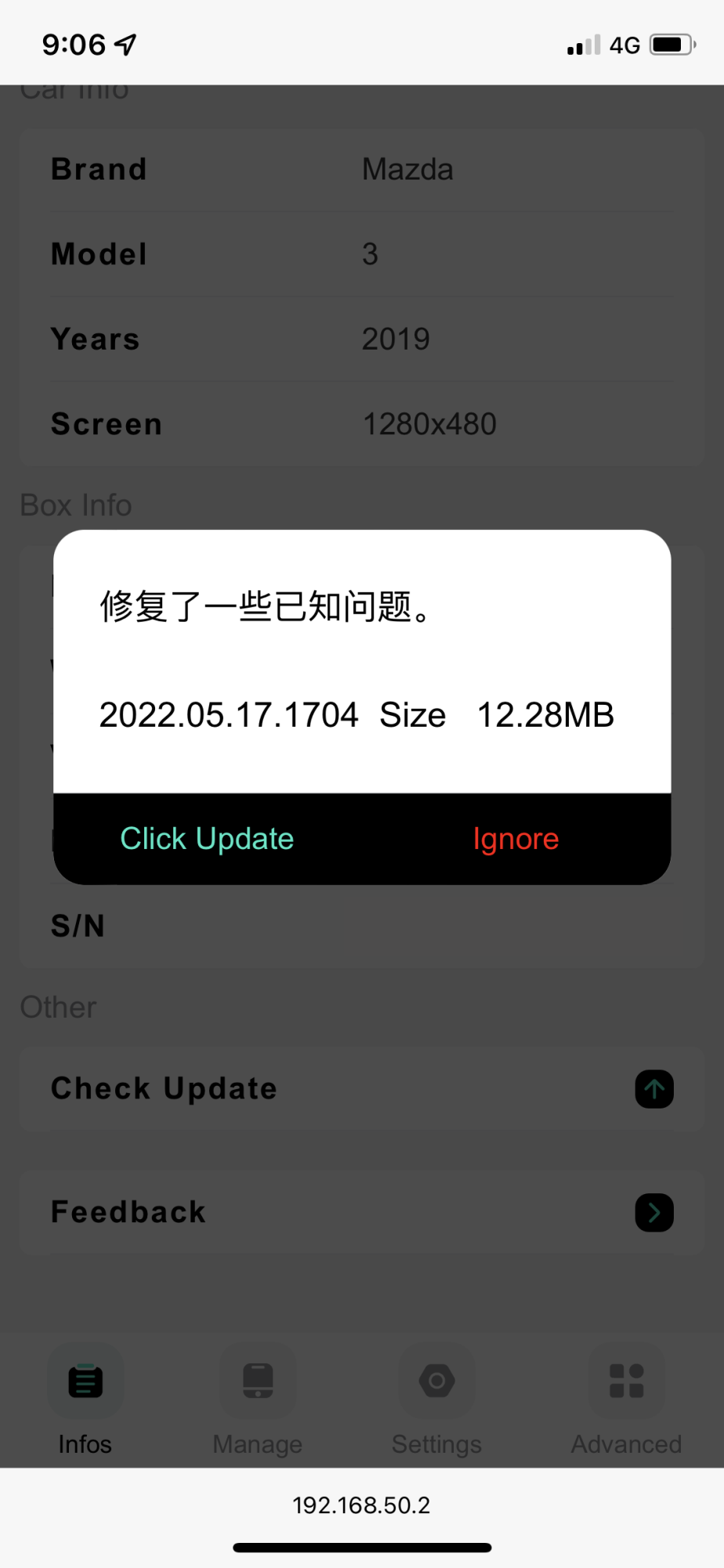

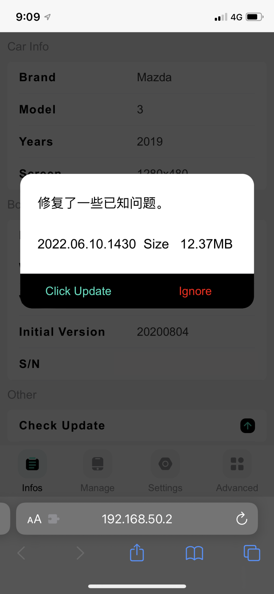

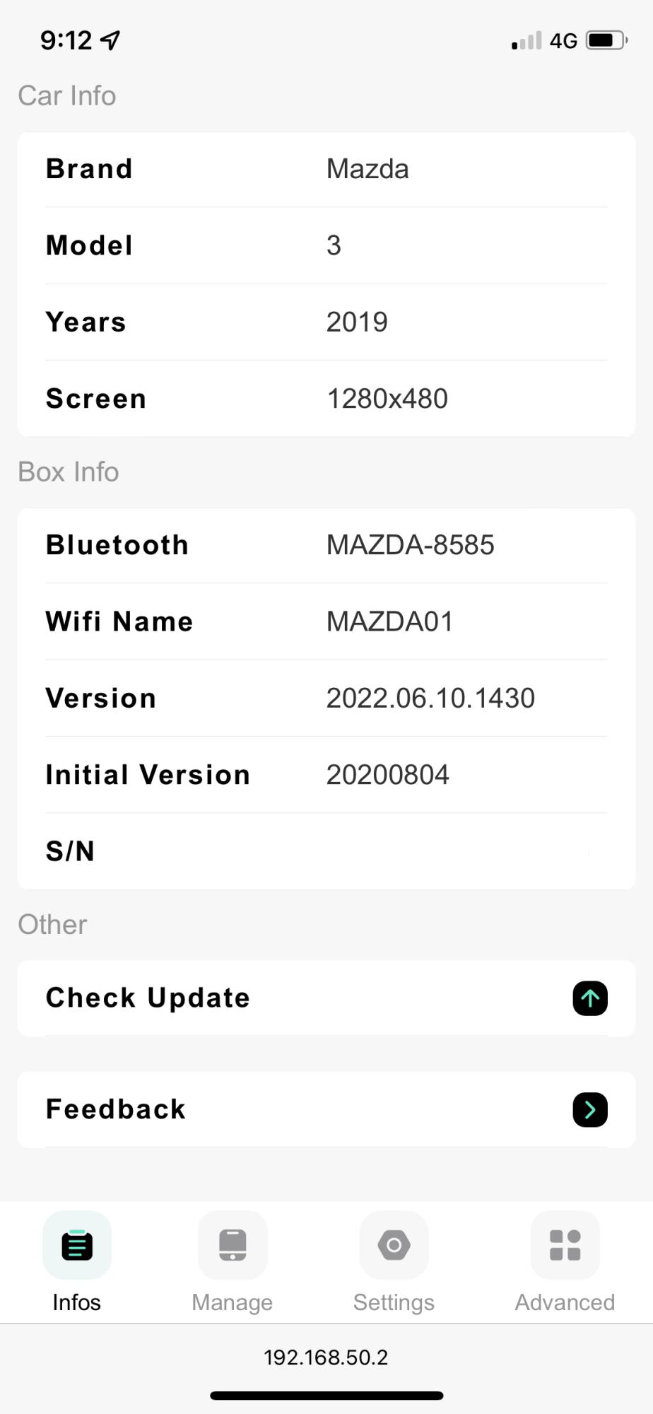

Today appeared 2 new updates, when yesterday it said it was up to date. This are the 2 new updates I installed this morning 2022.05.17.1704 and later 2022.06.10.1430.
Oh, yes that UI was updated in 2022.01.24. I have a newer version 2022.06.17.1710
The boot loader is new. Can I please have that firmware file?

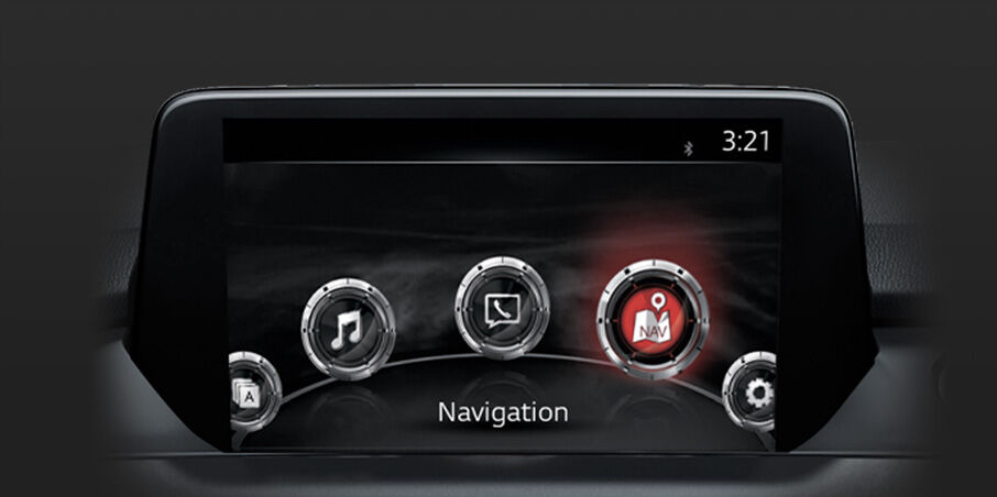

Yes, my MX-5 is Japan. so my Mazda connect FW is 70.00.351 JP M
I have confirmed my CheerDriving Connect is 43.0.13.0.0.0.2.0-2.10.4, It is same with your ConnectBox.
but I found small difference between your box and my box. I believe it doesn't matter.
My CheerDriving is shown 43.0.13.0.0.0.2.0-2.10.4/ConnectBoxBt_Mazda,
and your CheeDriving is 43.0.13.0.0.0.2.0-2.10.4/ConnectBoxBt_Volkswagen.
I'm not sure this is a reason for my issue or not. but I still have issue for Bluetooth pairing phase. so I can't connect to CheerDriving.
If I have a chance, I would like to update for my Mazda Connect to 367 instead of 351.

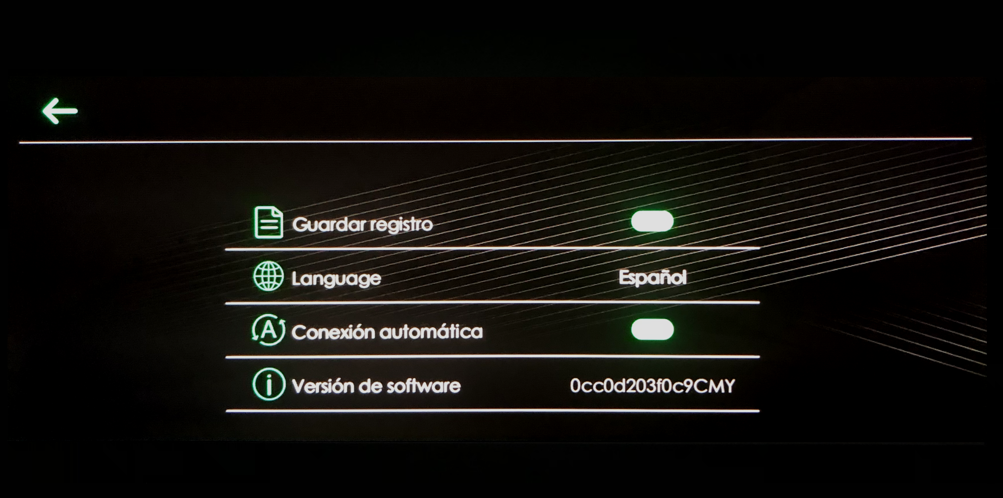

Hi guys,
I’ve updated my CLink 3.0 (GREEN UI) with latest firmware 2206XX, now my car doesn’t recognized it anymore and led i red 🙁
Any suggestion?
My car is a Peugeot 3008 My21
