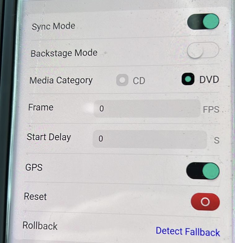

Can you please try resetting the adapter and then ensuring sync mode is turned on in advanced menu on 192.168.50.2. With latest firmware on current Green UI

Any idea of what sync or backstage modes actually do?
Synchronous mode (normal, compatible):
Standard: normal mode
Normal mode: Resolve issues with the instrument panel display.
Compatible mode: Fixes the problem that certain vehicles cannot connect to the dongle.
Background mode information: some cars go black after plugging in. So, turning on background mode may fix this. This mode means it skips showing you the connecting' screen. It connects in the background and once it's connected shows CarPlay interface

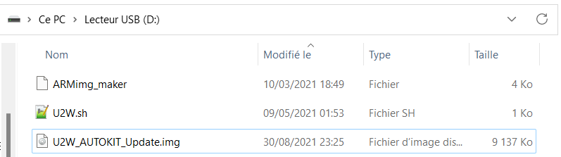

Hello, did someone from you solve the mic issue with Skoda Scala? I have U2W_AUTOKIT_Update_2022.01.24.1903.img from ludwig-v installed on cpc200-u2w-plus. The whole CarPlay behaves good, but no one can hear me during a call. I would really appreciate any help.
You’ll have to go back to original firmware.
Put this on a USB stick along with these two files in my image (same structure).
To get the two files use this:
