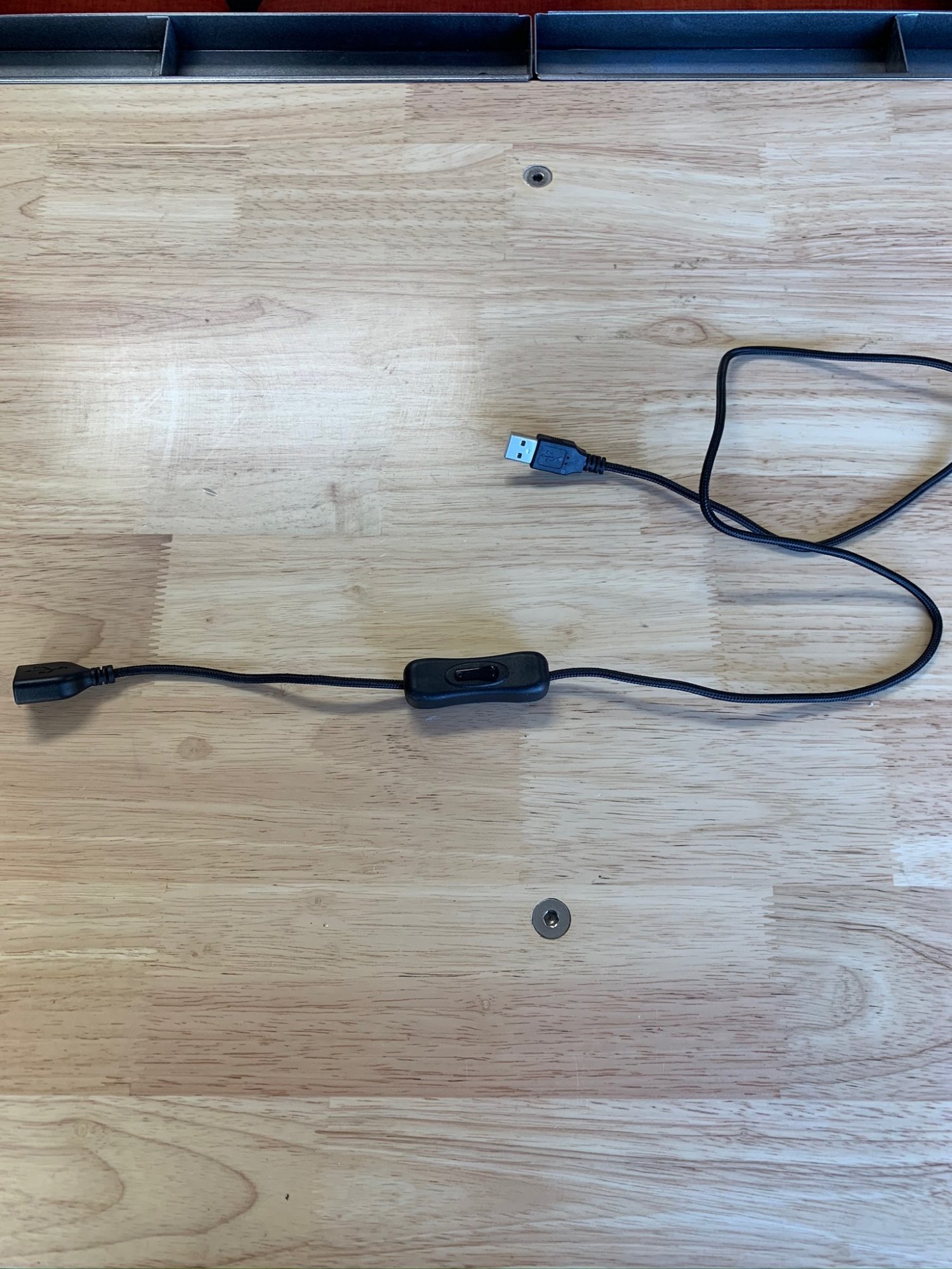

This is the problem. Your car is not cutting power to the USB port when it is turned off. Have you investigated to see if the USB power does eventually turn off (say, after 15-30 minutes) or does the red light stay on indefinitely? You may want to look in the manual or do some searches to see if it's possible to configure the ports to turn off with the ignition.
Check out these posts from back in 2020 from the user @2018 Denali. He had a similar issue and put together a small relay to ensure that power was cut to the CP2A when the car's power was turned off.
Or, if you don't mind a manual step I can very much recommend a small USB switch like this. I keep one of those connected to my Carlinkit so I can easily disable it without having to dig around inside my center console. I turn it off for instance if someone else is driving or if I've forgotten my phone.
Edit: Sorry, I misread your initial post. Looks like the suggestions above would not help in your situation. Have you tried changing any of the settings in the 192.168.50.2 page? You may also need to try rolling back to an even earlier firmware. Are you able to try your adapter in a different vehicle to see if the same problem exists? If it does then maybe your adapter is just defective.
