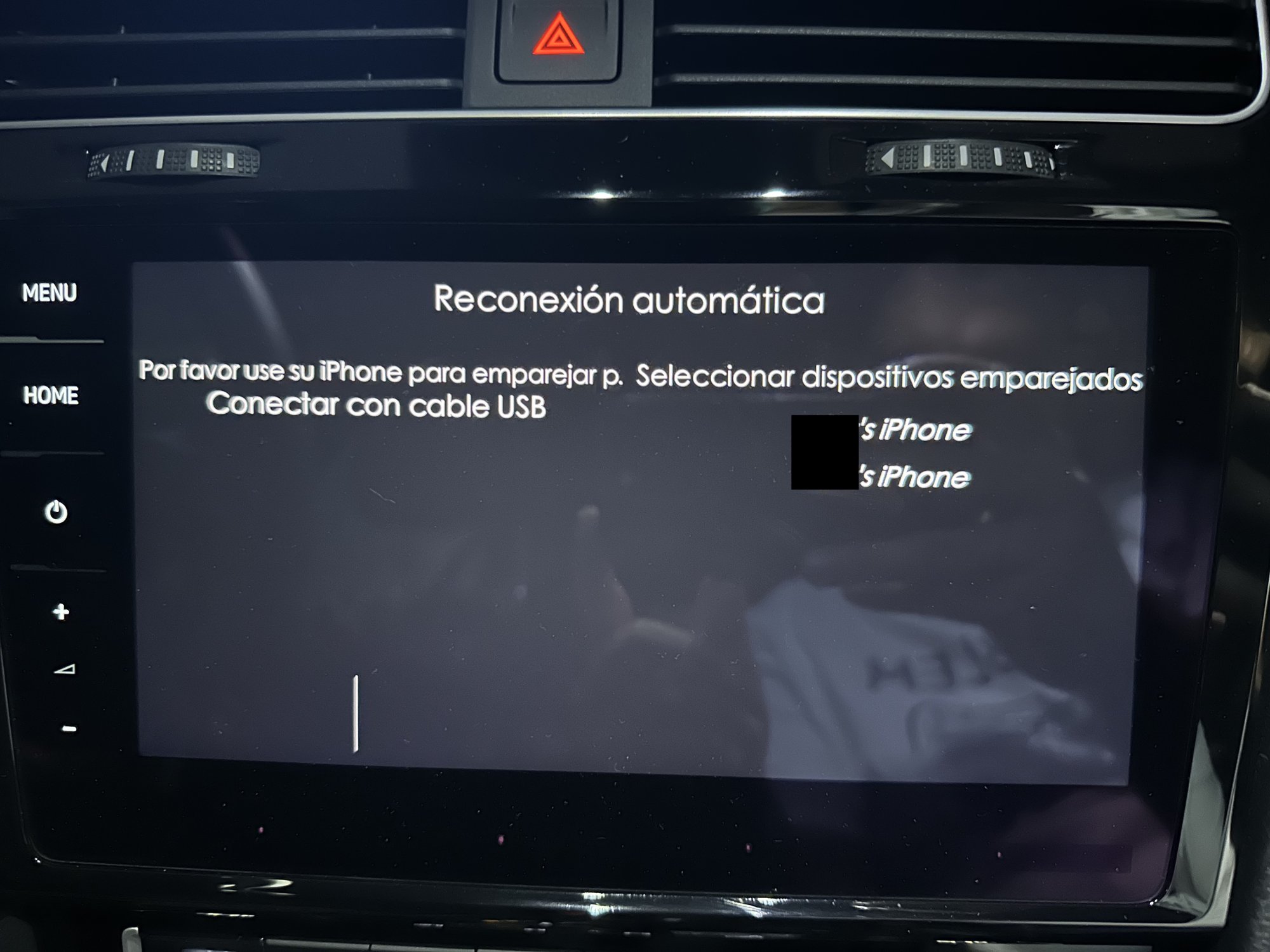

I upgraded my Carlinkit v2 to the latest firmware, but it was crashing every 20 minutes (my car is a 2020 VW Golf) so I rolled it back.
Now everything works fine (it’s running 2022.01.24.1903) but the connection screen does not have any color. Before the rollback there was the red UI but now the background is black and there are white words. As it connects very fast I can’t do any operation on that screen. I will see on Friday when I receive my new iPhone if I can delete the current one and add the new one.
I knew this will happen. I can't delete my old iPhone so now I have 2 iPhones with the same name. As you can see the interface has lost some colors and buttons. I have some panic about reinstalling the firmware as I had other Carlinkint in the past and it died.
I will assume you have U2W firmware.
Go to 192.168.50.2 and reset your Wireless Adapter. Hopefully that will reset it back to factory settings. Unplug Adapter.
Also delete all pairings from your iPhone Bluetooth & Wireless Settings, restart your iPhone.
Then plug in Wireless Adapter to your car’s USB and hopefully you can pair your iPhone & Adapter again.
