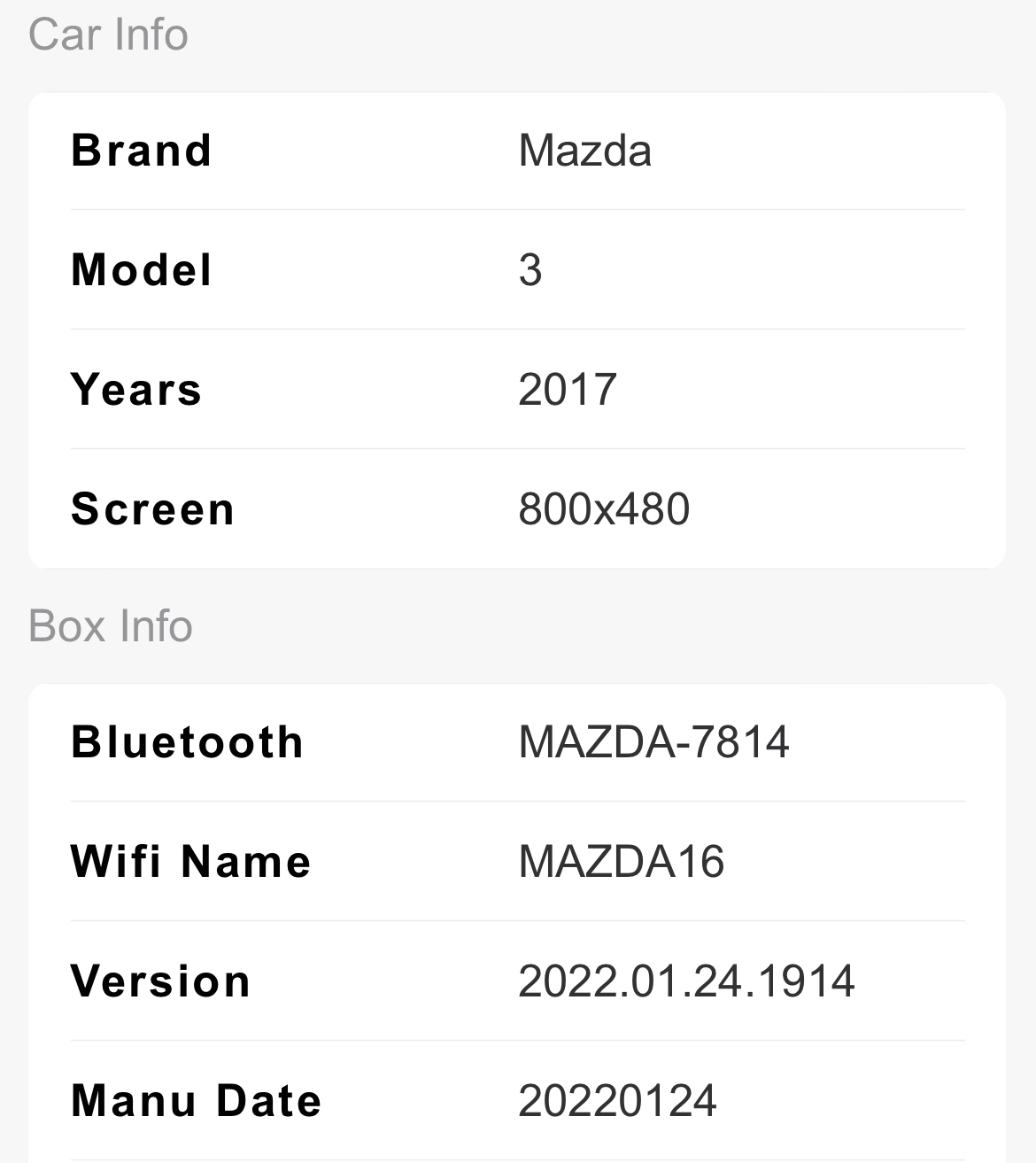

Carlinkit 3.0 with this C2P Air firmware has been working great in my 2017 Mazda 3 so far. No infotainment reboots or disconnects. Fingers crossed.

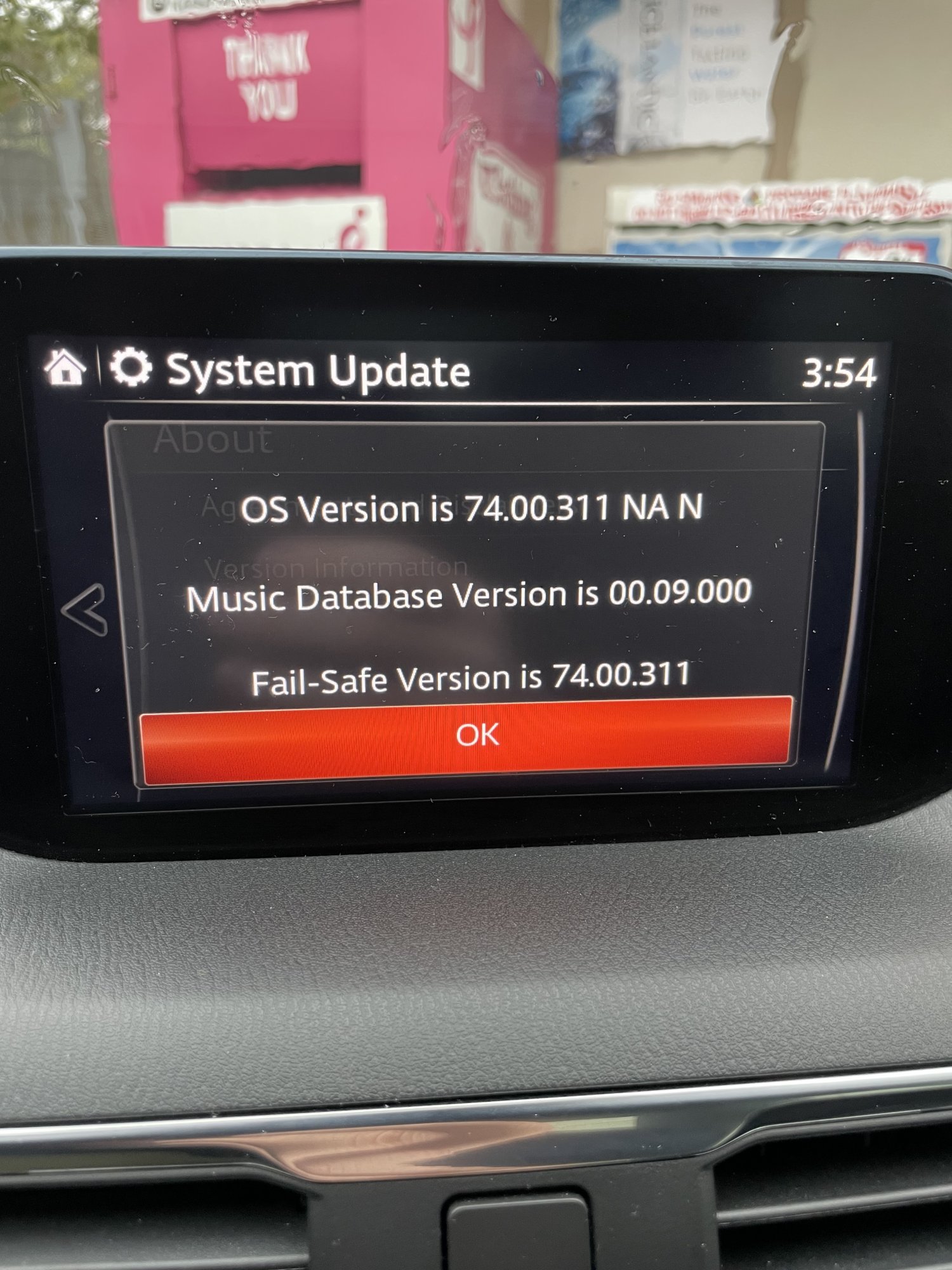

Which Mazda CMU version are you running that is working well?
74.00.311

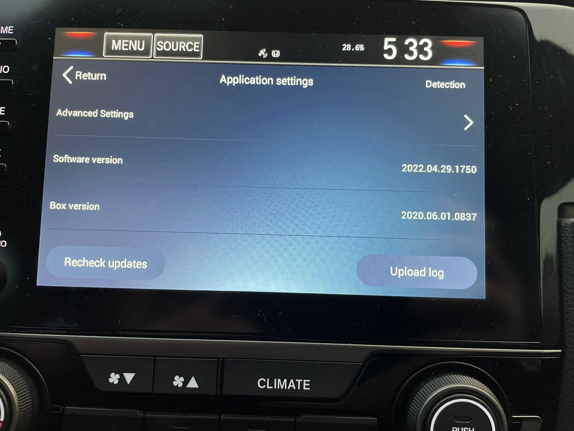

i bought a carplay2air a while back and it never really worked. I just got it back out and i am trying to update it to see if i can use it, but its the same. I cannot update it or use it.
it says it has 2020.06.01.0837 which i cannot even find any info about it!(see pic for more info)
when it get it to connect(after 10 or more tries) using wireless carplay, i cannot go into the local IP to update it. When i check the wifi IP settings on my phone with the box, for "router" space is empty.
I have tried multiple USB drives(2gb to 64gb), formatted it using windows and sdcard formatter and nothing.
I also tried changing the title of the files to U2W_ZYD_Update.img, U2W_Update.img, U2W_AUTOKIT_Update.img, and U2W_CP2AIR_Update.img and nothing happens.

update: this is still the best FW combo so far in my 2017 Mazda 3.
Note: I have the Carlinkit adapter but flashed the carplay2air FW.
