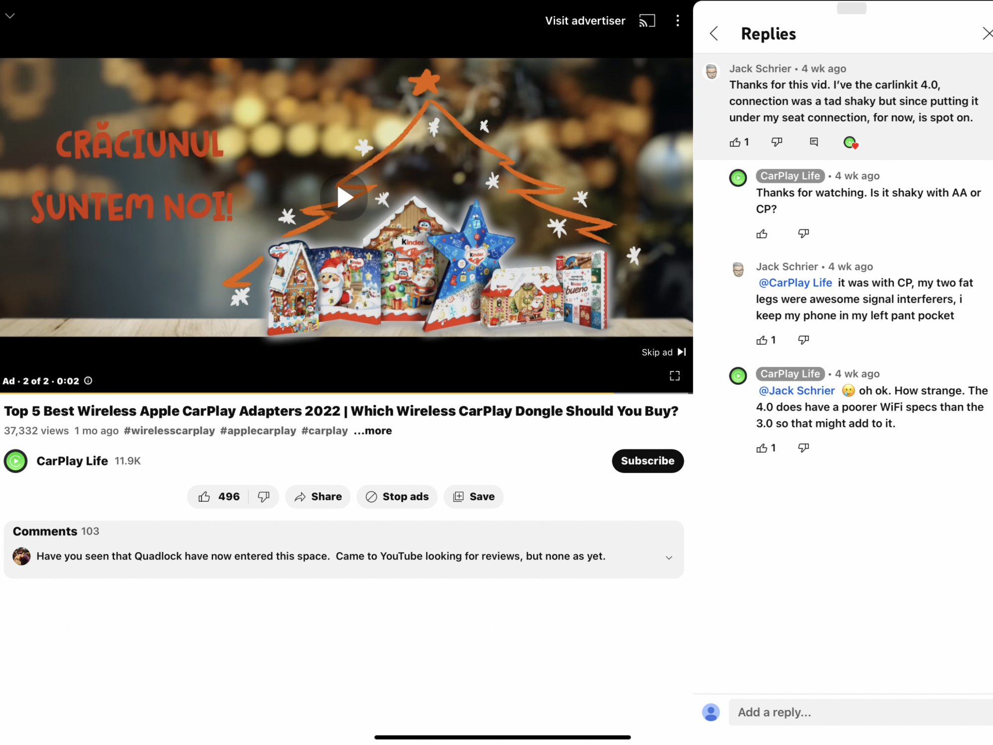

From CarPlayLife.com. Anthony states that v4 of the Adapters have a weaker Wifi signal so if you use only Wireless Carplay I’d stick with V3 Adapters for best Wifi coverage.
Thanks I’ll have a search for that video. Not sure on version that I linked to.
Strange that a newer version has worse WiFi as well. Although nothing surprises me with these dongles, although they are great for what they do have to say.
