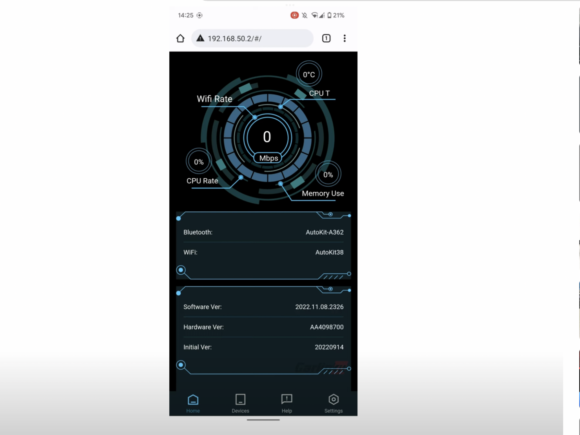

I noticed there is a 12.14.2022 firmware update for carlinkit 3.0. It has a totally new user interface and some new options. Anyone else on it and notice any difference?
I saw no difference between last fw and this in terms of reliability and quality, yet. I set call quality to HD.
Is this the interface you see. As I have not updated my Adapters.

Could Someone running the 2022.12.24 FW please post screenshots of the new interface/settings? I’m on 2022.01.24 and is the best version for my car so far (2017 Mazda 3). Just curious what the new FW has/offers.

Well well more surprises for me. I tested my Adapter with my Mitsubishi Eclipse Cross and the latest red UI version 12.14.2022 firmware update actually works perfectly with my car.
Also I have an Adapter with the green UI interface updated to the latest Dec 2022 of the firmware, but has the older UI interface.
Happy days.
I updated and it went smoothly although I had to reset some of my settings like the delay. One thing good is that the connection to my phone so far has been noticeably quicker. Sometimes it would hang there in the past for as long as 20 seconds.
I also like the new real time info in the browser UI, otherwise the new UI is functional the same.
