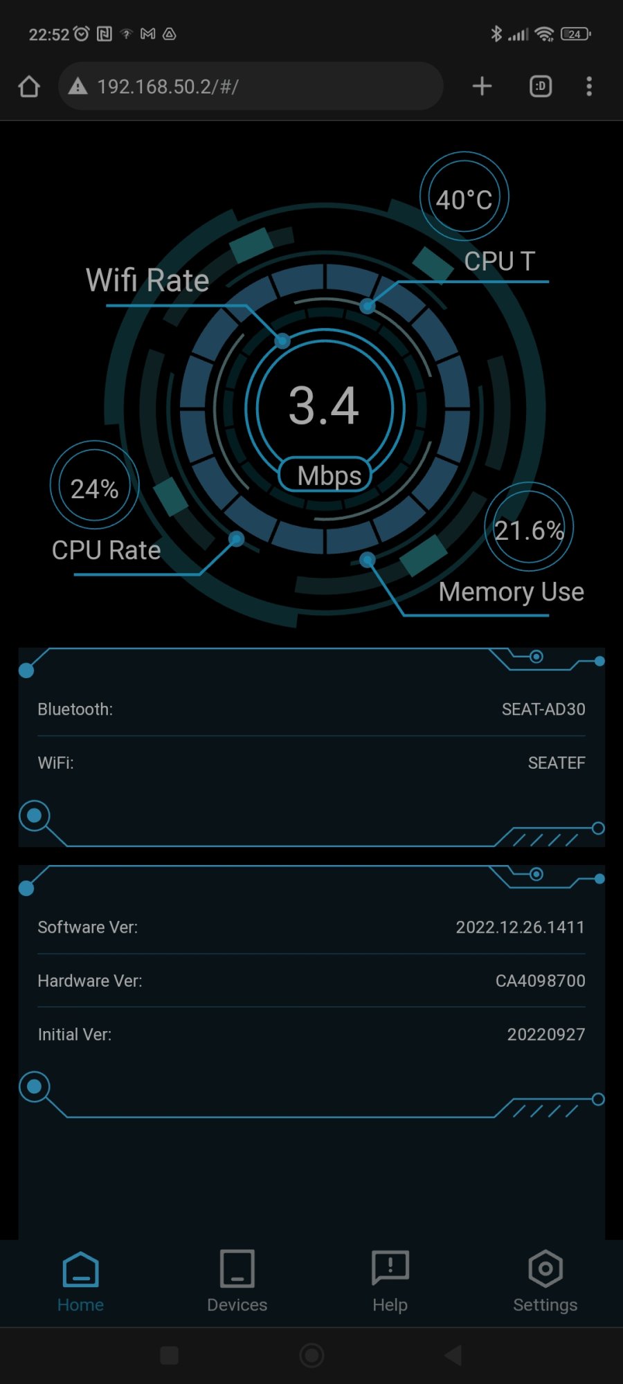

Hello I programmed Your v4 dump file but there's nothing no red LED only at first start it blinked red green. Any suggestions? Thanks!
My V3 is now a V4 🙂
Workflow:
Flashed my second dump of V4 (I updated to 2022.12.26)
My V3 booted up, got Wifi BT Hardware Error
Flashed largest FW (U2AW 2022.07.29) containing all Wifi drivers, waited for the LEDs to stop flashing (screen was still showing Hardware Error)
It rebooted
Got Activation screen, logged in on 192.168.50.2
Updated the FW
And voila !
