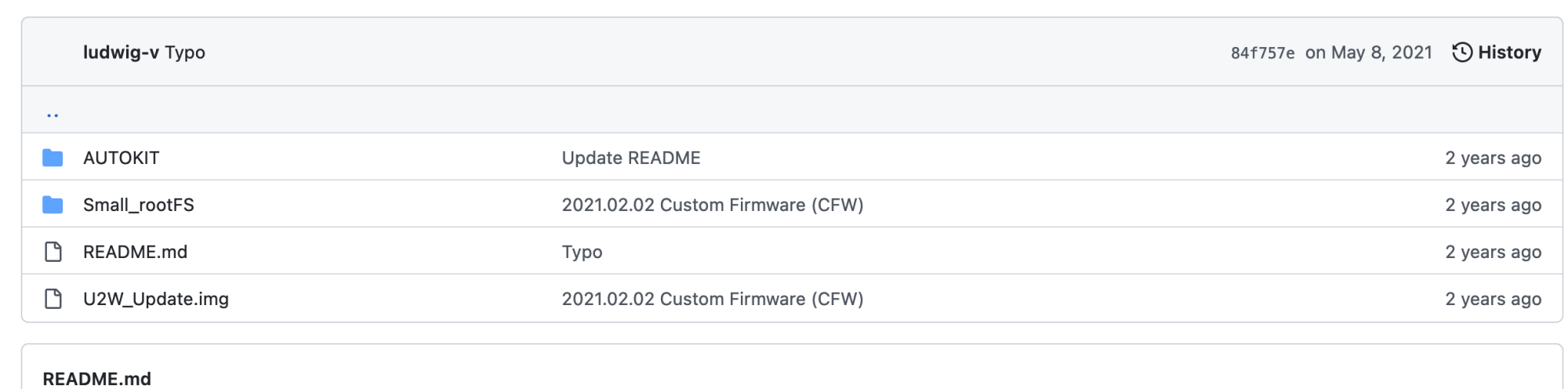

@VLud I saw the GitHub for the custom firmware.
Currently, I have the U2W stock version 1.24. Are the custom firmware fix the stability connection between iPhone, faster boot up?
What is AUTOKIT?
I guess I have to install in this order?
Autokit version is simply the RED UI Menu. It is faster to load because it does not have to render the UI every time it loads like the Green Menu UI does. (U2W = Green UI, U2W Autokit = Red UI)
Hope this helps.
Thank you for clarifying!

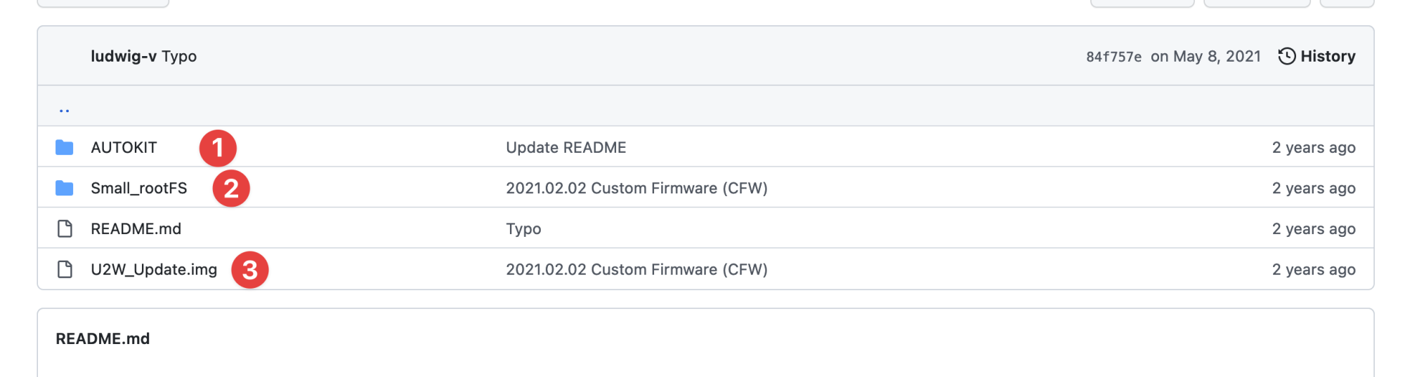

I have the C2PlayAir (bought it in 2021) here, not CarLinkit. All these numbers, which one I should go for? 2 or 3? I am curious what is 3 (green UI?)
Is the Small_rootFS actually for early adopter version of C2PlayAir? I am not the first adopter.
I was in contact with the C2PlayAir support last year, they sent me the original firmware to fix my bricked update. The firmware file is 12.5mb, so I assume I don't have the 10mb device.
Unfortunately I don’t have C2PlayAir. Please be very careful what you load because it is very easy to brick your Adapter.

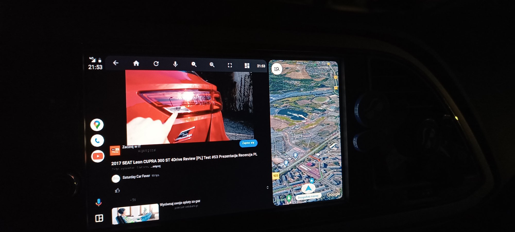

Wow what in the hell UI is that? My V4 just has the white interface on the web.

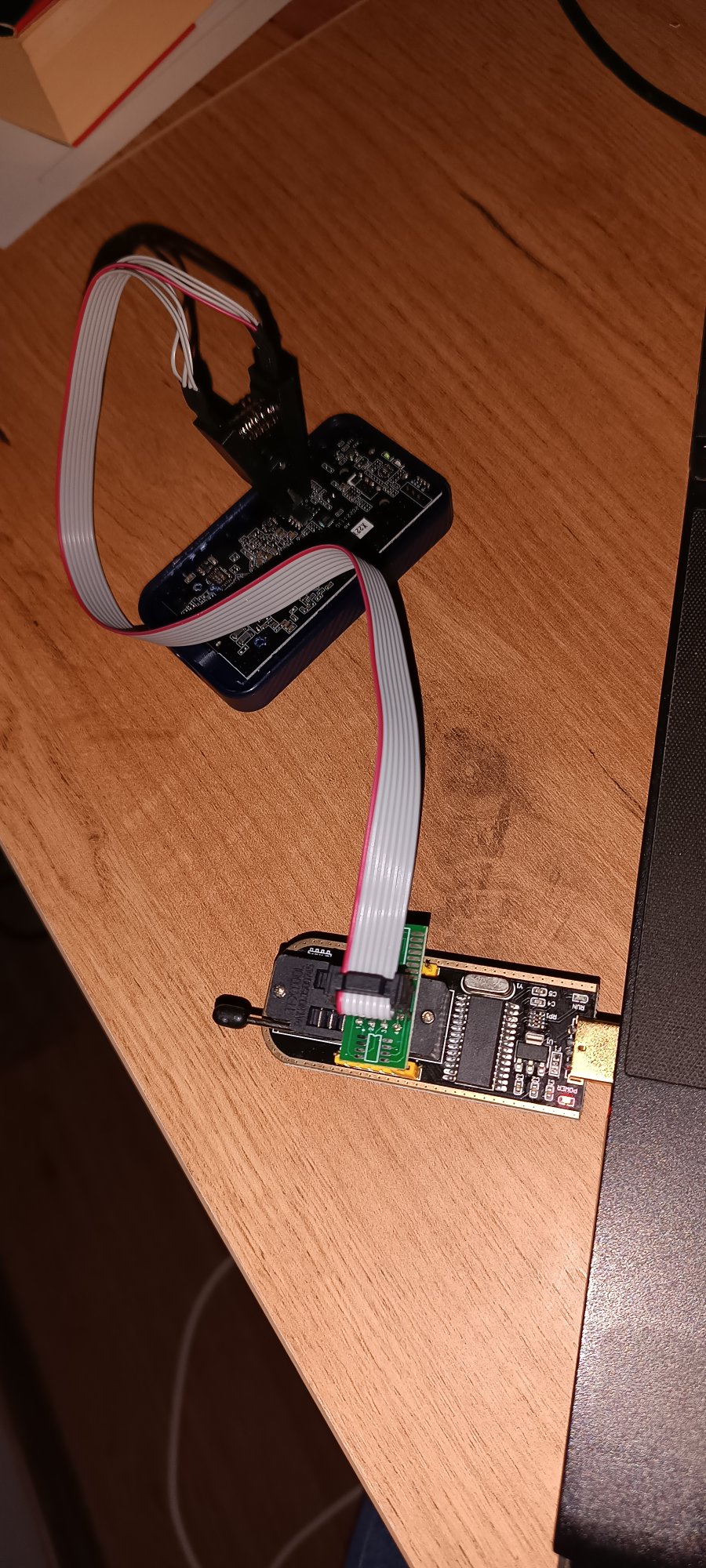

I'm understand You have carlinkit V3? Probably is there problem with flash u need reprograming it by dump. My v4 was totally dead (vLud helped me very thanks!!) I flashed dump file and now it works like new one. 😉
Interesting. I have the v2. I was able to connect to the web interface (192.168.50.2) last night and upgrade the firmware, but when I plug it in the CarPlay option still does not show up in my car. I know these things happen, but I always think it's interesting when I haven't changed a thing that technology goes so ridiculously awry.
So did you need additional hardware/software to reprogram/flash it?
Well looks like wrong firmware, You need hardware like ch341a with clip see photo need open case of Your V2 take a clip to MX25L12835F chip. I used software asprogrammer. Erase, then You should choose right dump file to Your V2. Reprogram it's simple to do. Quide how to reprogram is on YouTube. Goodluck 😉
