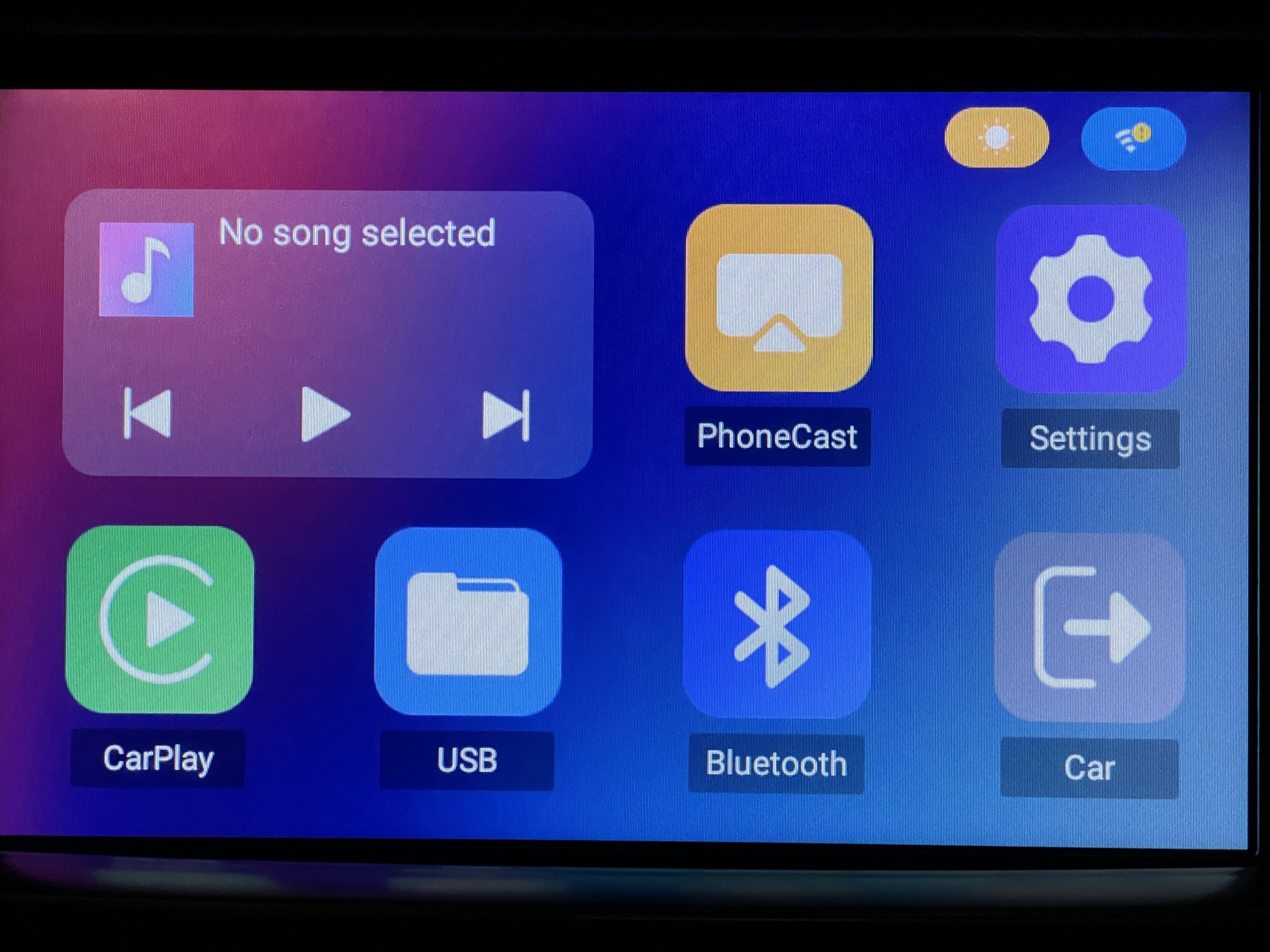

Has anyone who upgraded to the FW with the new interface noticed any improvements in call audio quality/volume or performance overall?
I’ve been running the FW Version 2022.01.24.1914 and it’s been working fine overall in 3.0 adapter but I’m just curious how the newest FW has been performing.
I know I know, if it’s not broken don’t fix it but again, just curious..
I did and for me it’s day and night.. the new firmware is far more stable m and faster. You can decide the call quality you want and the WiFi band.
“c47v3770 said
Has anyone who upgraded to the FW with the new interface noticed any improvements in call audio quality/volume or performance overall?”
I guess it comes down to the Adapter you have and the car head unit etc. My Adapter in my car has always been working correctly including call quality. The new UI works the same in my car, no discerning difference.
However the newer UI does give us more information including I think an important readout which is the temperature of the CPU. If the cpu gets to hot then the Adapter will freeze or not work reliably.
Getting a few spare Adapters is a good thing in my view, in case they do fail you have a backup Adapter that works. I have spare Adapters all setup with the newest firmware ready to go.
Had performance issues with the 12/24 FW in my 3.0 adapter. Screen would randomly go black while driving. Not pleasant.
Had to revert to the 2022.01.24.1914 version. It’s the release that works best in my 2017 Mazda 3 so far..
Just wish call microphone volume in this adapter was louder. Maybe it’s my infotainment. Who knows..

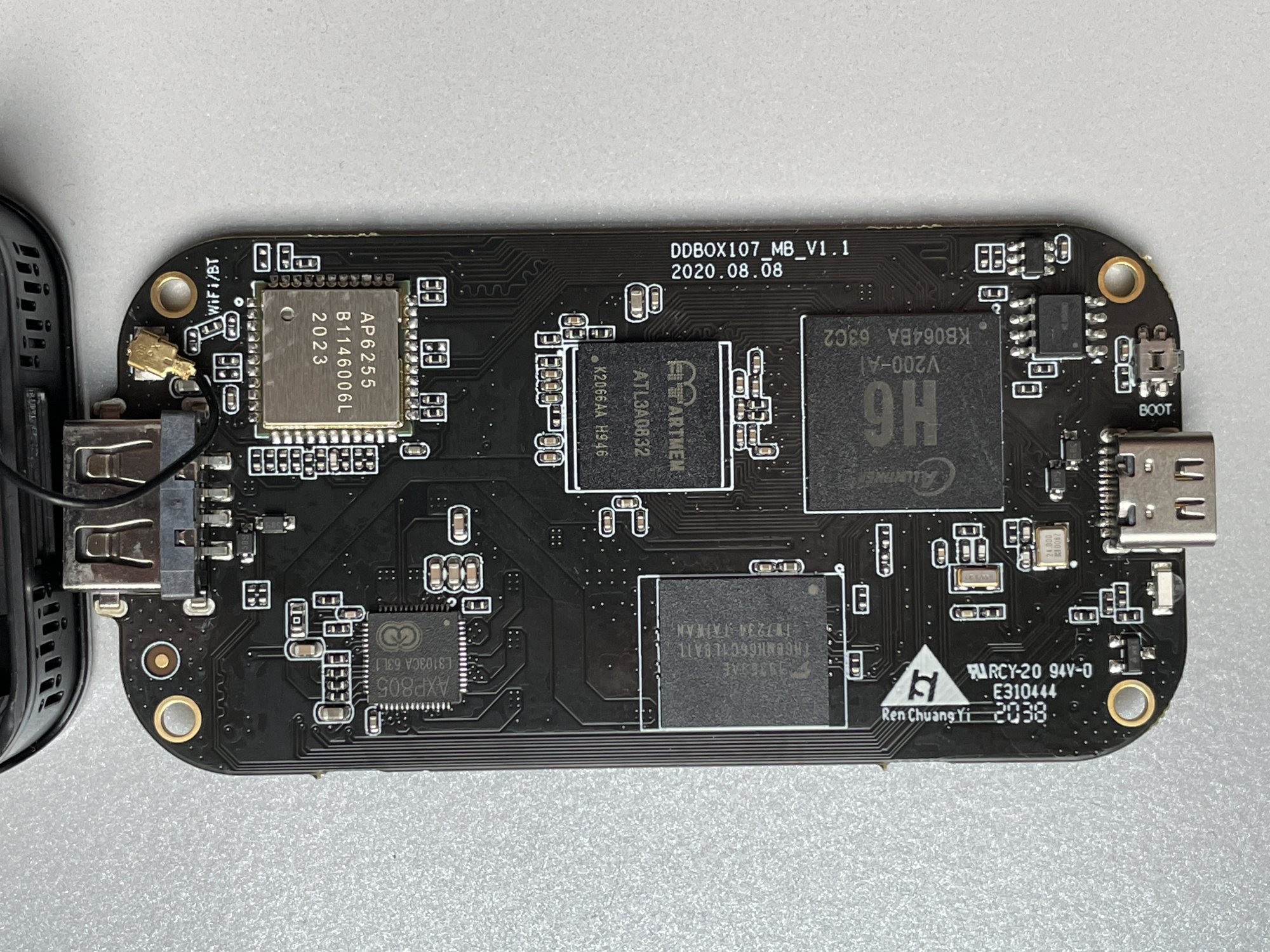

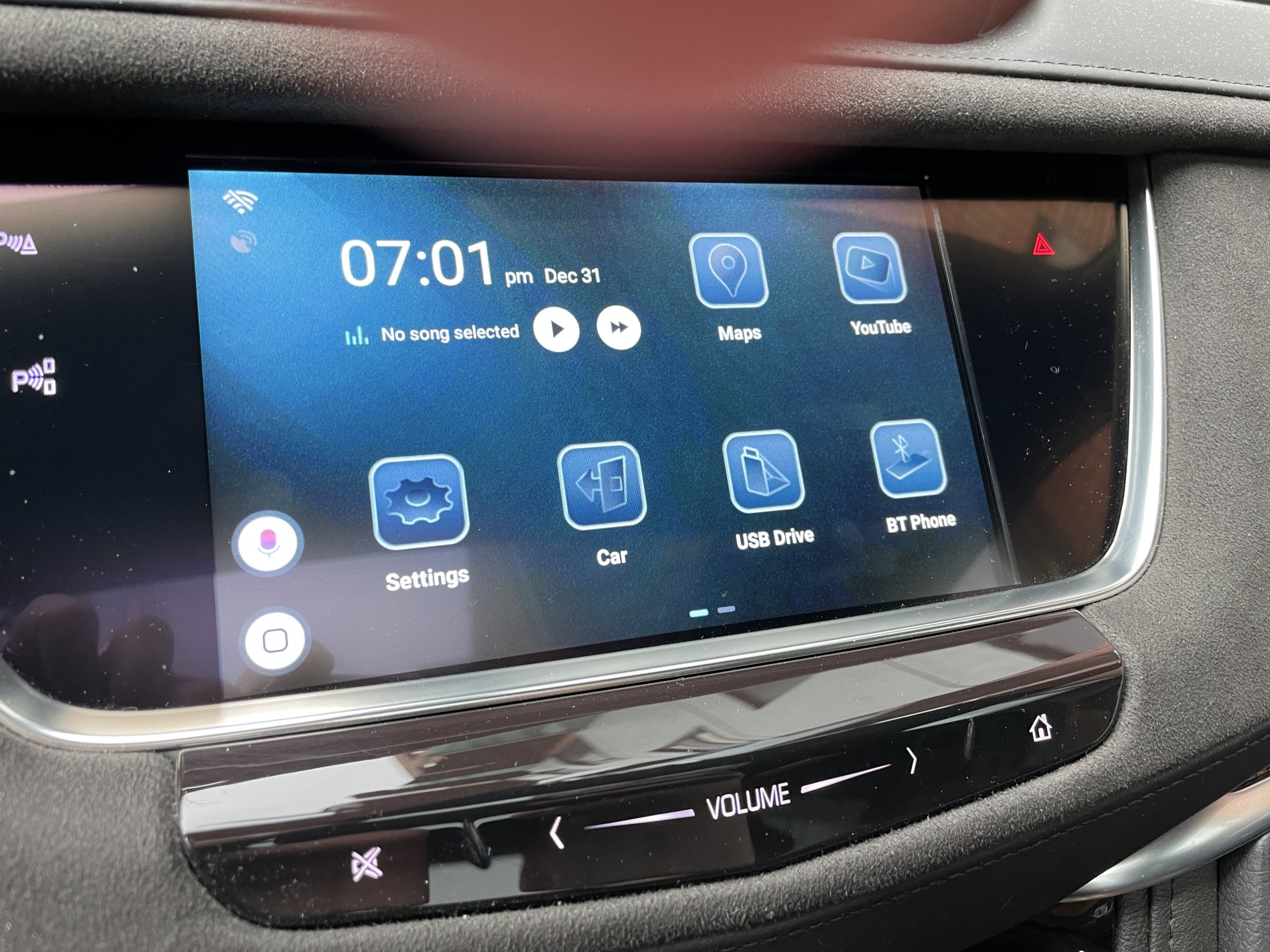

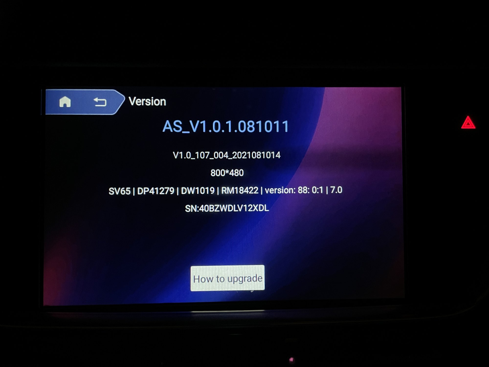

Hello! Please help me to identify my device board and find proper firmware to unbrick it after failed firmware update.
This is my old dongle, ordered from Ali but looks like MMB device (old one). Looks like it in boot loop or something. No any output, only leds flashing/breathing in a loop.
Following labels on the board I need v107, but dropbox links are all dead already for v107 there. Do you guys have it backed up somewhere?
I've managed to flash it with Phenix on PC with recovery image file but there is no Wifi/BT:
I've tried few firmwares and on v7.7 BT/WIFI start to work and I get UI like on original device.
The problem is that after basic setup (CarPlay autostart, disable warnings) device rebooted and stack in boot loop with BT on and CarPlay device name visible in my car media on boot time for few seconds before device goes to reboot again...
Will try to flash v8 next time...
Thanks!
Well, v8 report:
It works just fine now! The only problem - NEXT/PREV buttons on wheel doesn't work. God...
