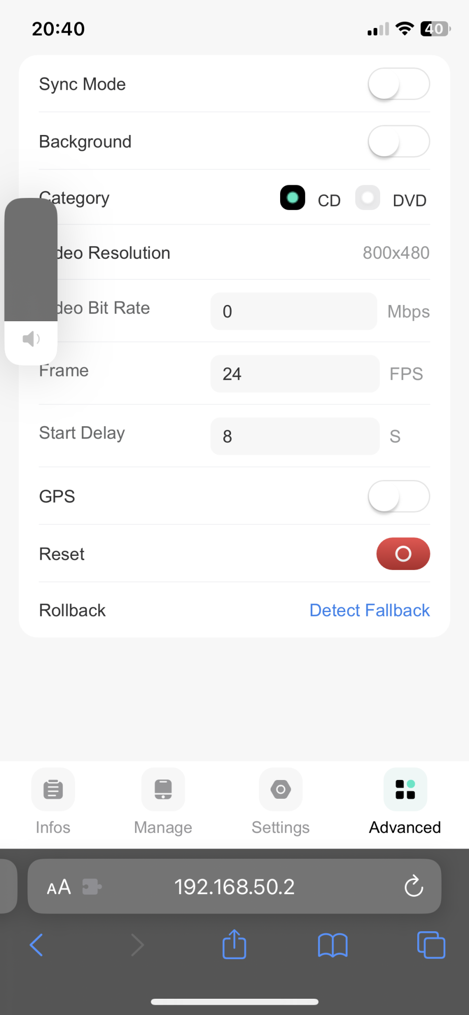

///Edit: I have downgraded to 2022.07.29 and made some changes. I attached a screenshot.
My background mode will not work. Sync mode changes nothing (on off).
Anyone have an idea what could be causing this?
I had to downgrade all the way back to 2022.01 to get background mode to work again. I did that using the USB stick method as the web interface only seems to allow two rollbacks only.
Thank you! At t he moment 2022.07.29 works good for me (Except for background mode, but is not problem).

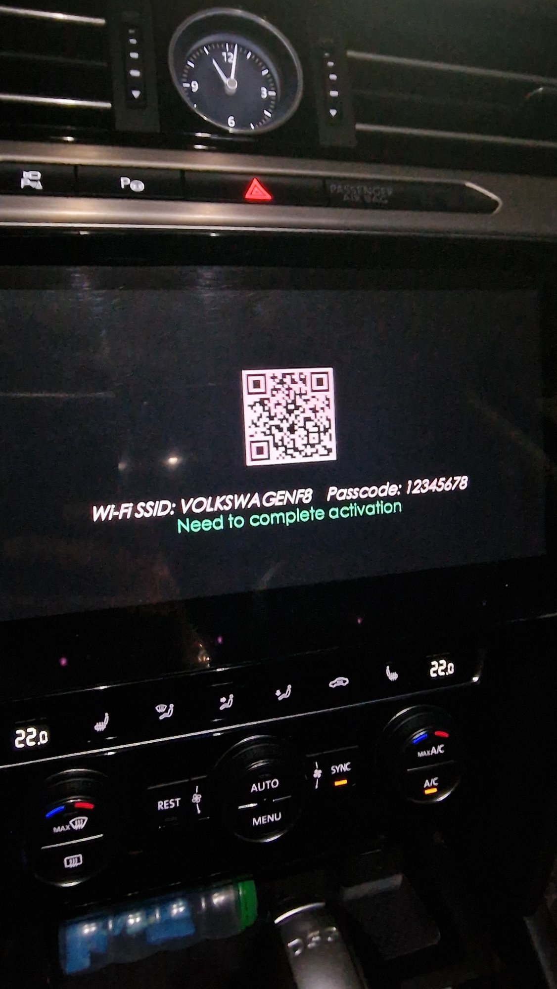

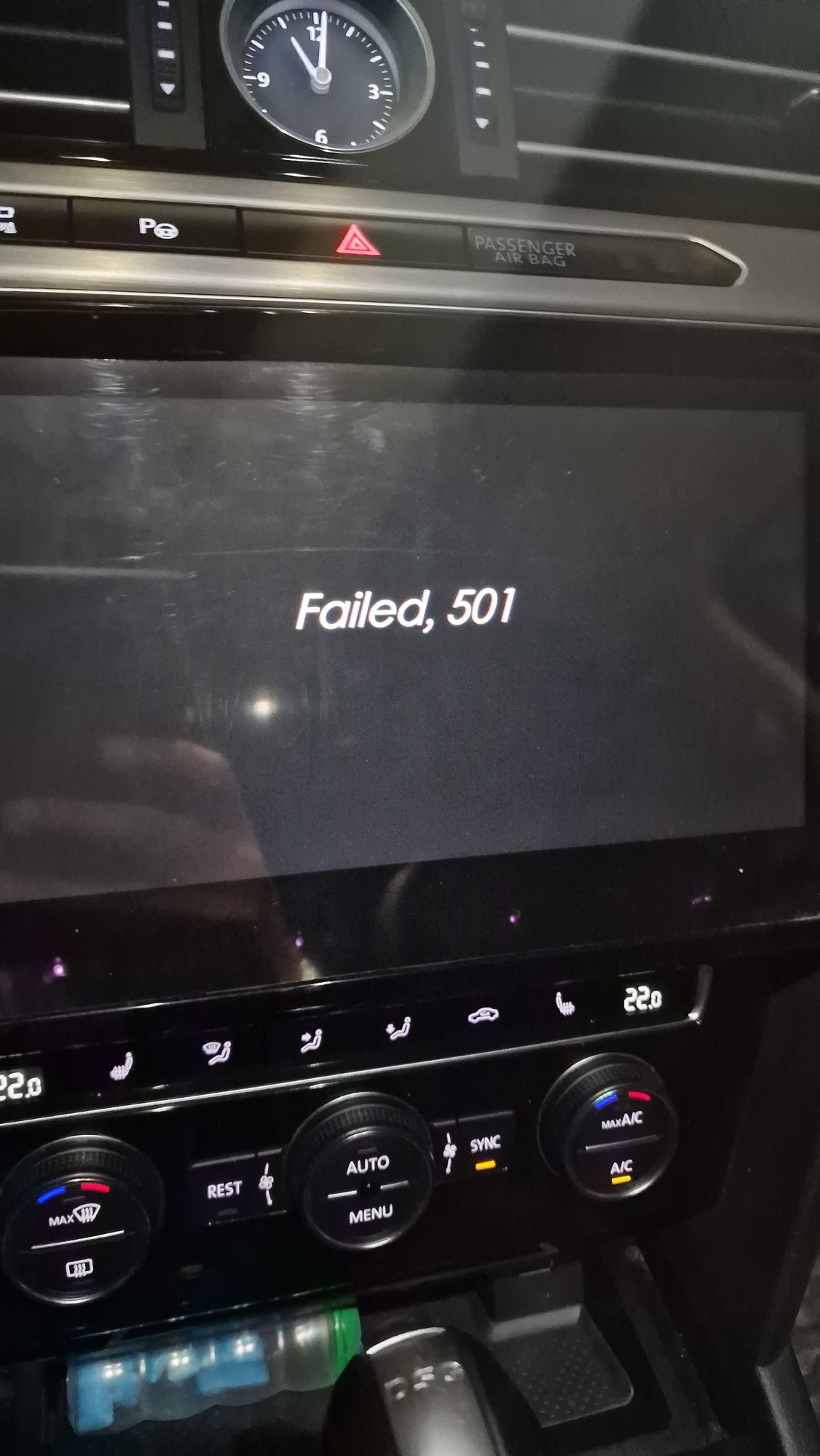

Hi, i have carlinkit v4. During update it just died, no red or green light, i used VLud
MX25L12835F_FW_20221226_V4.BIN
V4 Flash Dump from github
and flashed the chip. Now it is back to live and can update the software. BUT no matter which version i've tried from those which are available in github i'm stuck on "need to complete activation" screen. When i go into 192.168.50.2 there is no activation option and also i see "Failed,501" on the car screen. Tried update and rollback from the device same problem.
Tried using an iPhone, no difference.
The car is VW Passat 2018, my phone Samsung s22 ultra
Any ideas?
Thanks in advance

I'v tried, when i connect the iPhone it looks the same story, or at least i don't know what to do when i "enter the device"
Any advice where to find "active" option
Thank you

Did You try flash
MX25L12835F_FW_20220927_V4.BIN ? Bt&wifi works?

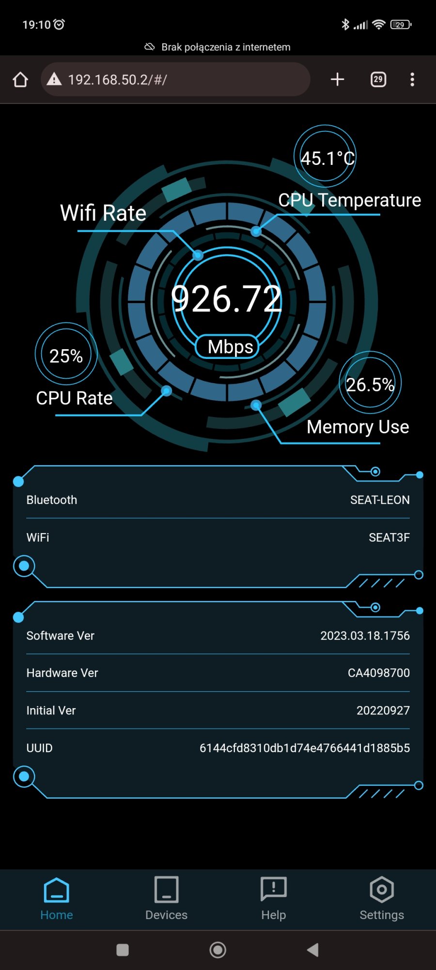

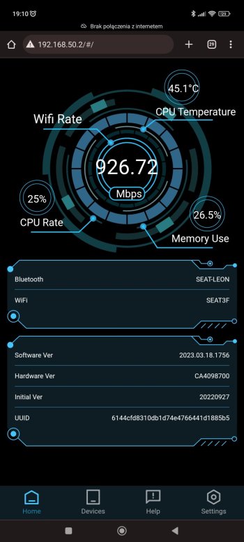

I got this and works pretty well look at picture
try this:
When wifi&bt works after flash log at the device get upgrade to the newest firmware (use wall charger no car system). Activate using iPhone (connect to device bt, mobile data disconected, connect to wifi device ssid write password 12345678 and get site 192.168.50.2) when connected to the car
