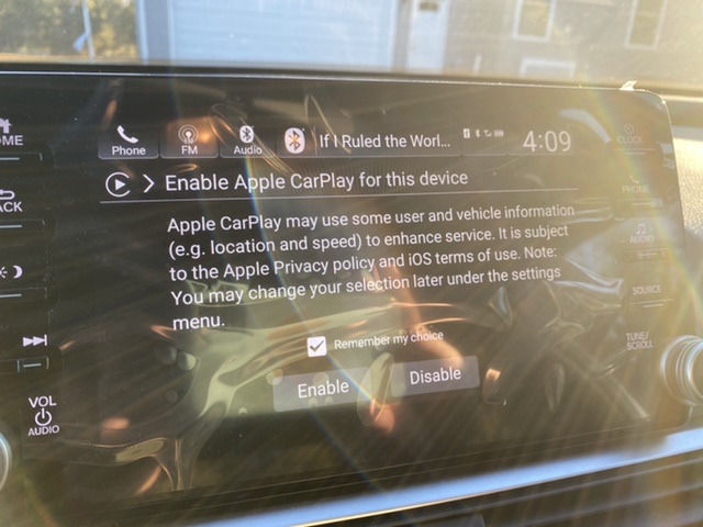

Adapter just came in 2019 accord sport. I get a message saying enable Apple car play for this device. Hit enable and nothing else happens. No Bluetooth connection shows up or anything after this message.
Solid red light is the only thing I see on the dongle the whole time.
What about your phone? You have to connect your phone to the dongle via Bluetooth . If it’s the old original firmware you may not get any other messages.
See if your phone can see and connect to it via Bluetooth
Yep, I get the same on my 2018 accord sport. Now I get to go through the return process because they claimed it’s supported when it’s not.
Try to apply the 2.0 update and check if that fixes your problem.

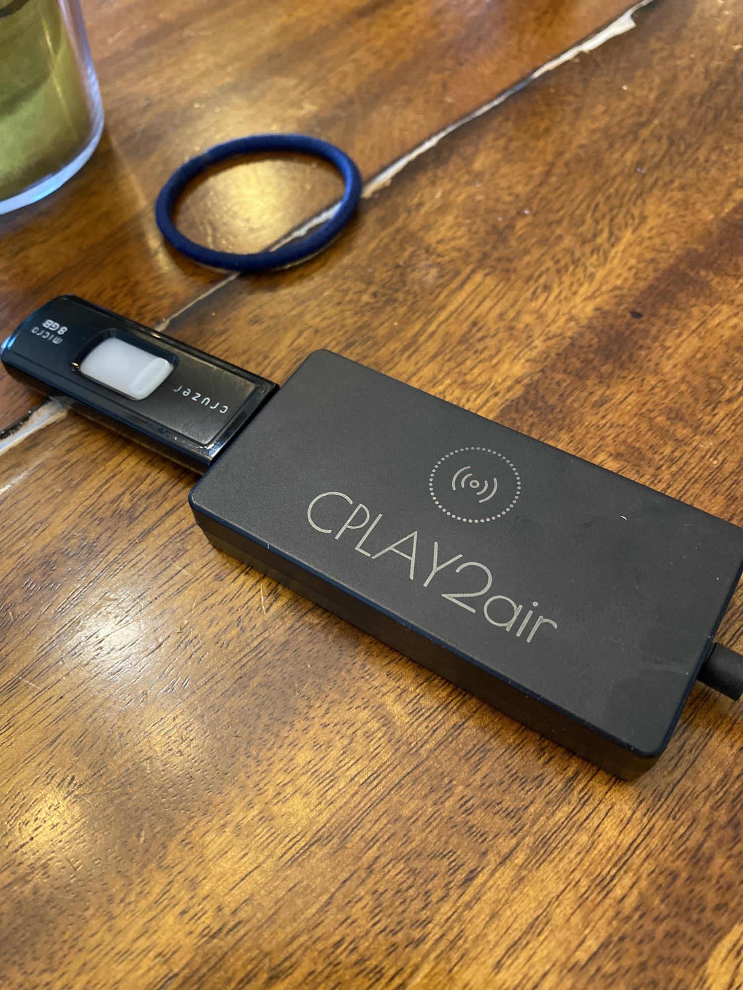

Do these updates actually apply to the CPLAY2AIR adapter too? See attached photo.
i have tried to update formatting my flash drive to fat32 and adding the disk image file to the root directory, but i never get any blue light flashing when plugged into the power supply basically the only thing that happens is I get a solid red light nowthibg else...
They should as it's the same device. However, you may already have 2.0 firmware installed (maybe they upgraded before shipping or it is a new batch). In that case, the usb update won't do anything 🤔
Sandisk Cruzer didn’t work for me either - try a different flash drive, smaller capacity ones seem to be better than larger.
I had to try 4 or 5 before I found one that worked OK

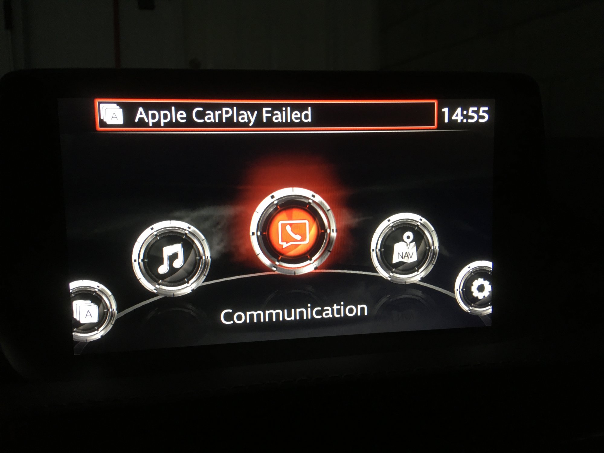

I bought a Carplay2air to use on my Canadian 2018 Mazda 6, the unit arrived and after a few intents I was able to pair my phone and the vehicle. Also I downloaded the latest software upgrade ver 2020.01.18.2149, but the problem is that the Carplay2air connects with my car randomly, for every 10 tries the dongle connected one or two times fine and it is usable (Music, Maps, Phone calls, etc).
The rest of the time just says “Apple Carplay Failed” on my car infotainment and never reach the Bluetooth connection page.
I removed all the phones paired with my cars’ Bluetooth. I rebooted my iPhone SE, the wifi and Bluetooth are "on".
Any suggestions on what else I could do to connect with my Mazda 6 on the first try, please?
Thanks,
I have the exact same problem with my Mazda 2017.
Frist i thought it was my adapter that was defective but now i have read about more Mazda owners with this problem.
Guess we will have to hope for an update to fix this problem, it is so annoying that it only works like 2 out of 10 times.
