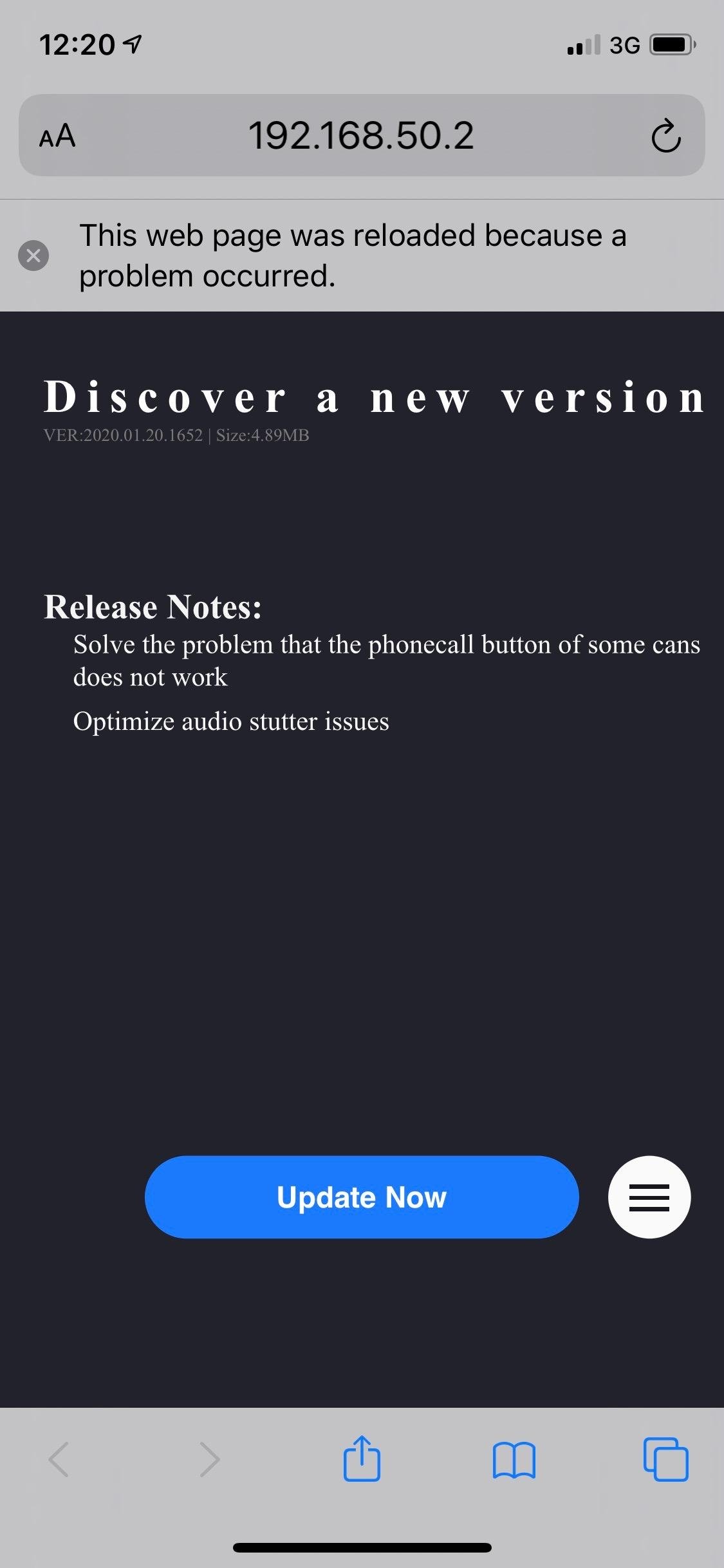

Maybe you can try to use some VPN on your phone.
I had problem to connect to their update servers, after using a VPN I was able to connect.
Great advice-- I used VPN and when I connected it popped up stating there was an update available. It updated and then rebooted. Now it the SSID that it broadcasts matches what it displays! However now with this version it brings up a screen asking to activate and has options for high-end vehicle, batch number, username and password. How did you get past this screen? I tried multiple times and from VPN through multiple countries and no luck.

My device already was activated, I only had trouble to update my firmware that has been workaround by VPN.
[automerge]1579471529[/automerge]
What VPN did you use? I’m running into the same issue where I’m stuck at “Product is not activated(20)”
I had used VyperVPN USA-Chicago address

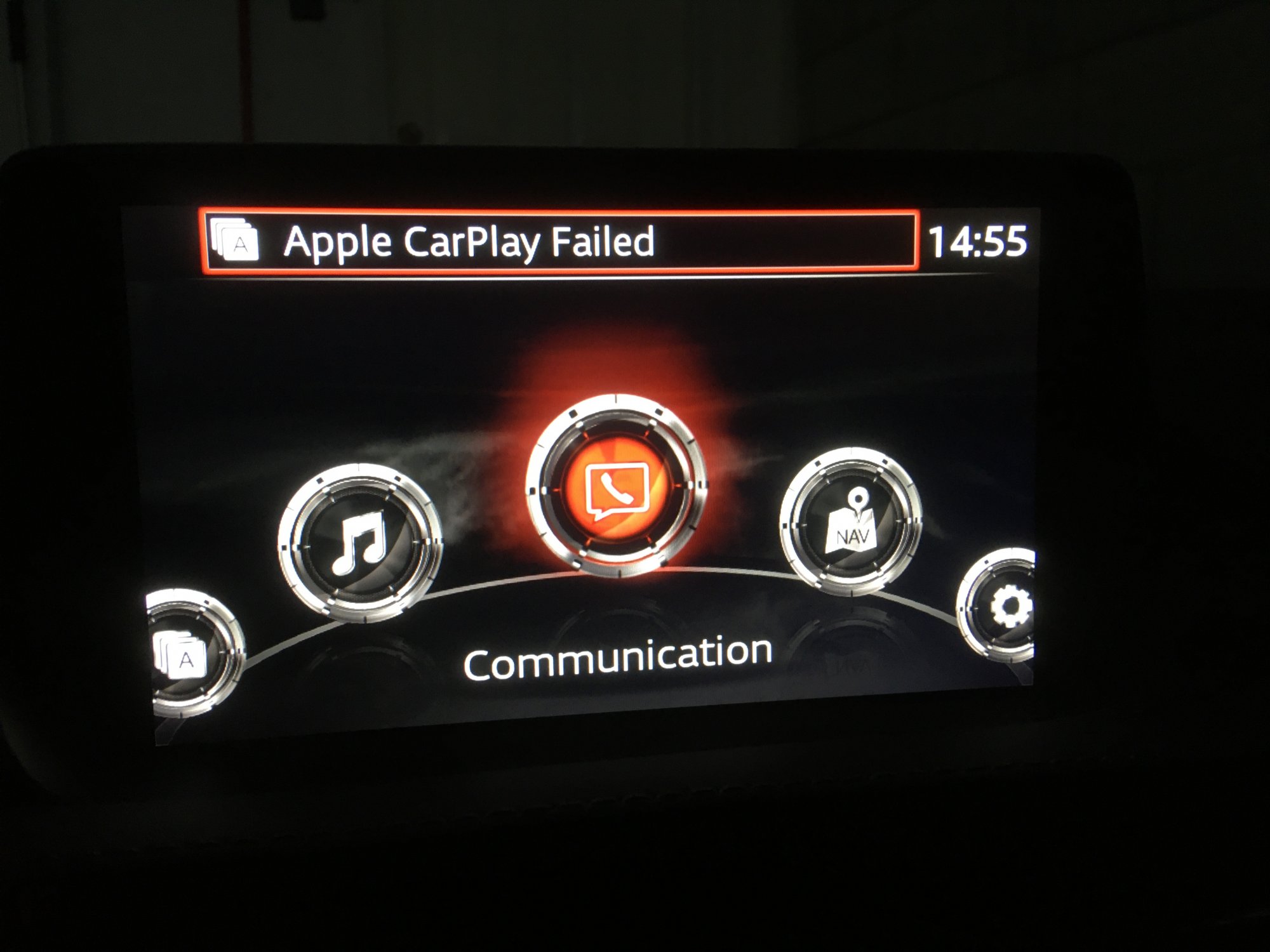

I bought a Carplay2air to use on my Canadian 2018 Mazda 6, the unit arrived and after a few intents I was able to pair my phone and the vehicle. Also I downloaded the latest software upgrade ver 2020.01.18.2149, but the problem is that the Carplay2air connects with my car randomly, for every 10 tries the dongle connected one or two times fine and it is usable (Music, Maps, Phone calls, etc).
The rest of the time just says “Apple Carplay Failed” on my car infotainment and never reach the Bluetooth connection page.
I removed all the phones paired with my cars’ Bluetooth. I rebooted my iPhone SE, the wifi and Bluetooth are "on".
Any suggestions on what else I could do to connect with my Mazda 6 on the first try, please?
Thanks,
Updated to the latest Mazda firmware? The latest update might or might not help?
Yes, I have the latest Mazda firmware installed for sometime already (Mazda ver 70.00.352 NA)
I'm waiting for an Carplay2air update to fix the annoying random connections.
I don't know what else can be done.
Today's update fixed the steering wheel control issues for my Chevy Traverse. They now work properly! Unfortunately the unit still crashes after about 10 minutes running.

Today’s update didnt fix the phone button for me 🙁
