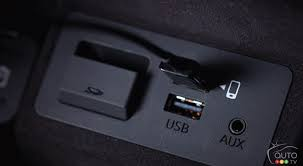

I get a similar message on my Mazda 6, "USB Connected" and "USB Disconnected", when I by mistake connect the dongle in the wrong USB port, just be sure that you are connecting the device in the dedicated USB port for Carplay, the one with the small phone icon beside. Good Luck, could be an easy fix for you.
I am definitely plugged into the correct port, which works fine when I plug my iPhone directly into it with a USB connector.

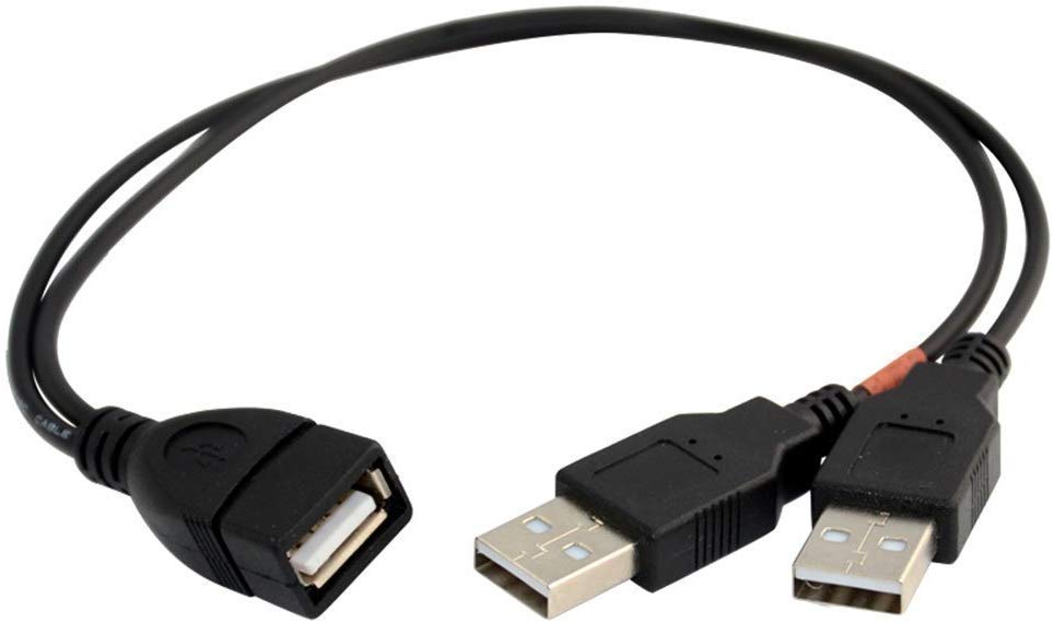

For those that are having problems to get the dongle functioning, it might be worth a try powering it up using a cable with two USB like this:
Maybe your cars usb port is not providing enough power for the dongle to work...
Also, when trying the usb disk upgrade, remember to use a usb charger to power the dongle during the process.
