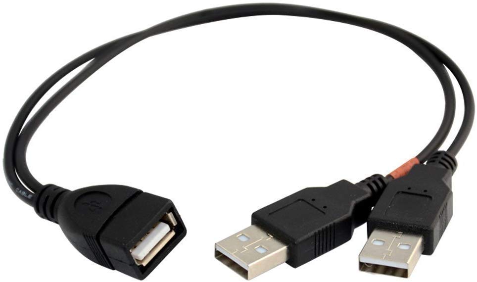

For those that are having problems to get the dongle functioning, it might be worth a try powering it up using a cable with two USB like this:
Maybe your cars usb port is not providing enough power for the dongle to work...
Also, when trying the usb disk upgrade, remember to use a usb charger to power the dongle during the process.
Before anybody wastes time with this, I had the same suspicion and measured the dongle’s power consumption and it’s only 200mA, or 0.2A. Your car’s USB port is more than capable. Most put out 1A, but even a basic 500 mA port is sufficient.
Have you actually tried this type of cable? I was a bit apprehensive with this "combination" cable and created a "alternate" power cable, feeding from an external 2.1A adapter. No go for me.

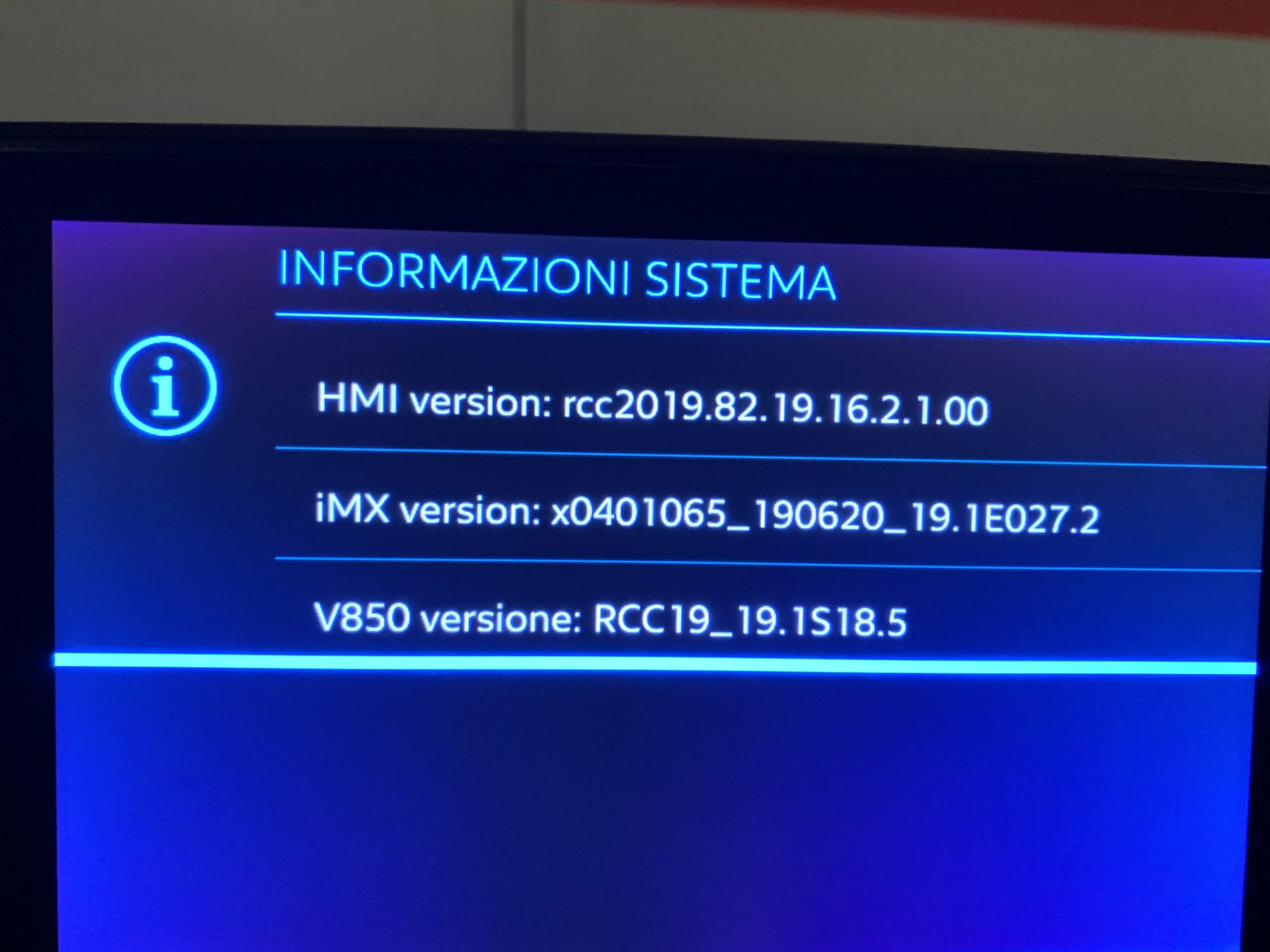

Hi @datolis I think i have the same issue as you. I also have a new Peugeot 5008 from November 2019. I connected to the Hyundai of a colleague following the steps given by the manufacturer, i upgraded to the latest firmware and i thought my problems were finished.
Unfortunately then i connected it to my Peugeot and... nothing. I connect it, it pairs the bluetotooh to my iphone, then i accept the carplay message, it blinks blue for a few seconds and then it disconnects.
I attach a screenshot of the number of my car system. I think we have the same.
