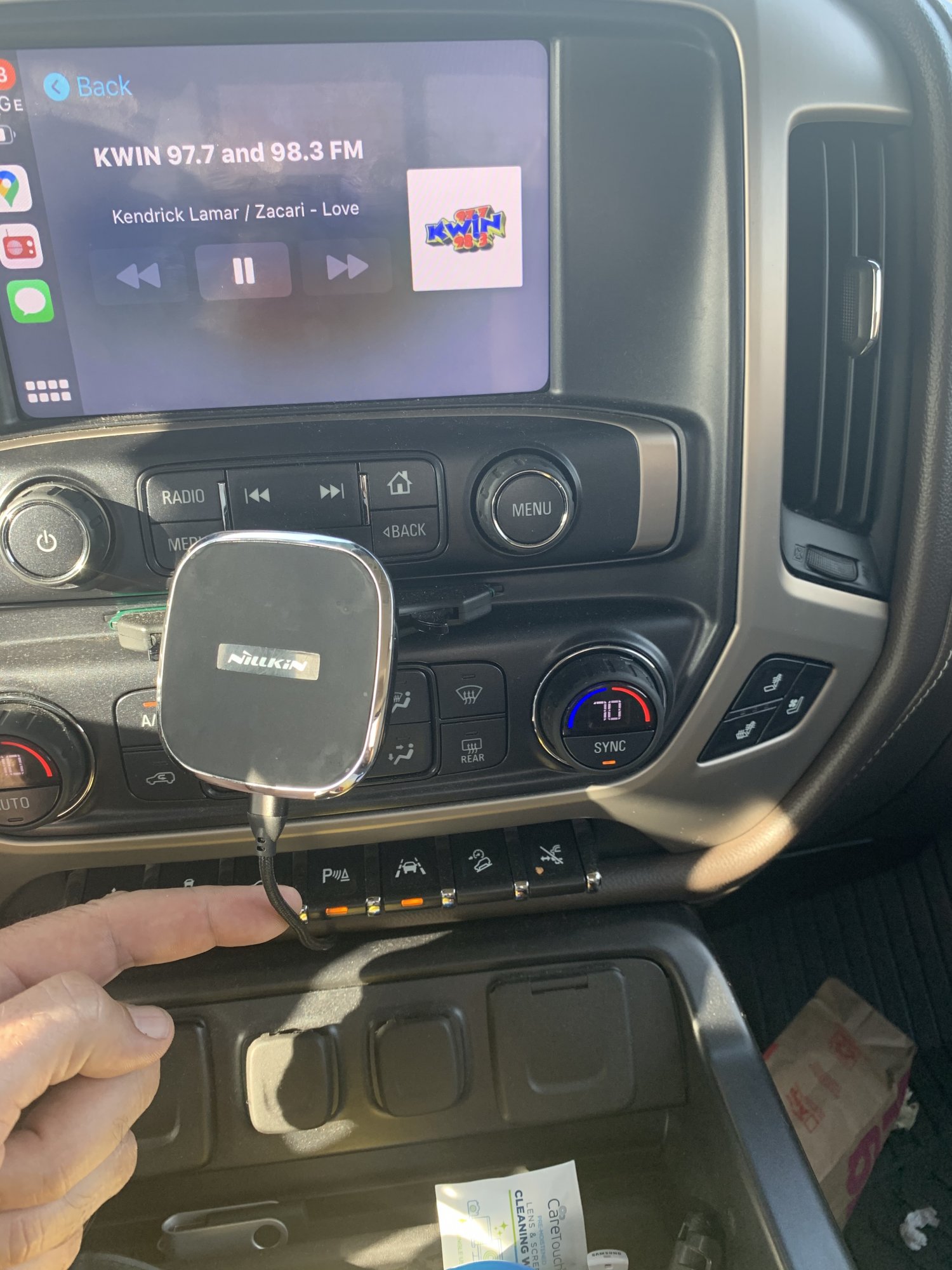

Given my experience with carplay i'd say you probably want your phone to be charging when running GPS and other carplay related stuff anyway. Which, unless you have an induction charger in your car means plugging the thing in...
Actually I have a CD slot mount that wirelessly charges my iPhone when I place it there. No need to plug the phone in.
For my use case, it's perfect.
My normal car trips range from 10-30 minutes, and I'm not usually utilizing navigation (i.e. my short commute, running errands around town, etc). For this, wireless CarPlay is great because I can easily navigate my music collection, see and respond to texts, etc. without having to dig out my phone and plug it in.
For long trips where I'll be actively using GPS (which for me is not that often) I'll plug in. I would be doing that anyway even if I didn't have the Carlinkit.
Another factor is what phone you have. I have an 11 Pro and even though the battery life takes a hit when I use wireless CarPlay, it's not enough to matter. Ditto for folks with an external battery case.

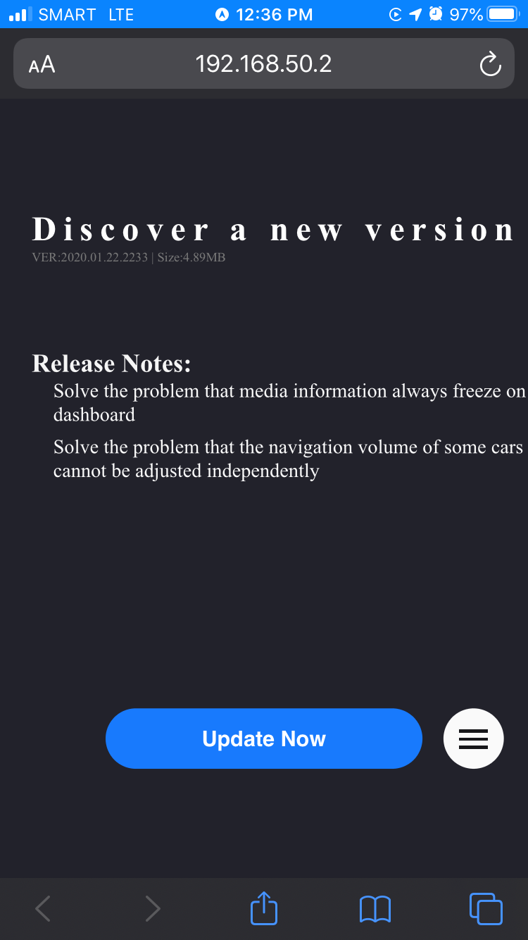

The Carlinkit team sent me this email yesterday in response to connection issues which indicates the latest official firmware is 2020-01-22
Thanks for the reply and picture, yes, currently the 2020.1.22.2233 is the latest version. For your problem, we need you to upload the log to us first. You can upload the log via the menu in 192.168.50.2 page. And our tech will received your errors after you uploaded it. Then the tech will check the problem and try to update new firmware to resolve the problem later. Thanks a lot!

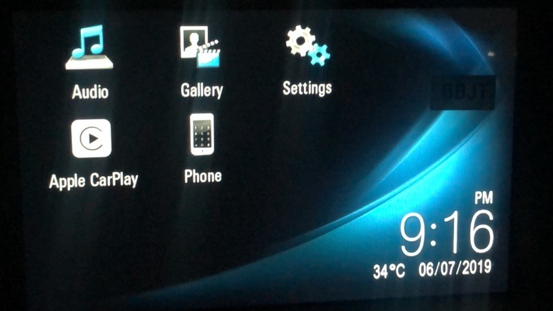

Hi All,
This is my first post and I'm from the Philippines. I have been lurking around this thread since December 2019, and
I received my Carlinkit dongle about two weeks ago, February 1st to be exact.

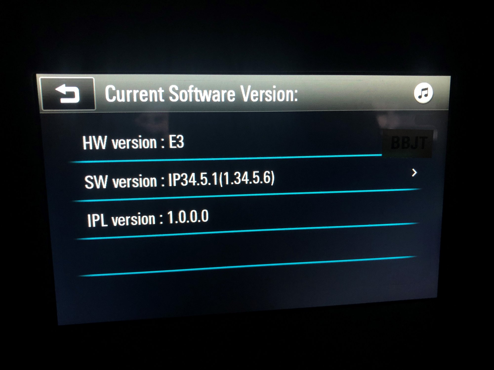

I have a 2019 Chevrolet Trailblazer LT with 7" Mylink with built-IN Apple Carplay and Android Auto. The headunit seems to be the same as the ones called Intellilink in some European countries based on the home screen.
- 2019 Chevrolet Trailblazer LT [ known as Holden Trailblazer to our AU friends ]
- 7" Mylink with built-in Carplay/AA [BYOM 2.0 i0B] [aka Intellilink?]
- Mylink version
Anyways, Out of the box, it has worked without flaw except for the slight lag when tapping next or back button for audio, I use Spotify most of the time, however, this is a non-issue for me. Have not updated to the "latest" firmware as indicated when connecting to "192.168.50.2" which indicates version 2020.01.22.2233 as the latest as seen below.
My question is, how do I know the current installed version on my Carlinkit Dongle?
In addition, just an input regarding why the dongle works on one car and won't on another with the same brand and model as the other and even having the same year model.
This is may be due to the headunit models/versions not being the same. Like for example, for my current vehicle, the LT variant here in the PH comes with the 7" Mylink sytem [BYOM 2.0 i0B], while the same year and variant sold in Thailand comes wth the 8" Mylink [BY0M 2.5 i06 ]. My previous car which was a 2011 Chevy Cruze came with a monochrome 2 liner radio display, while the same variant released in the US came with the 4 liner display.
