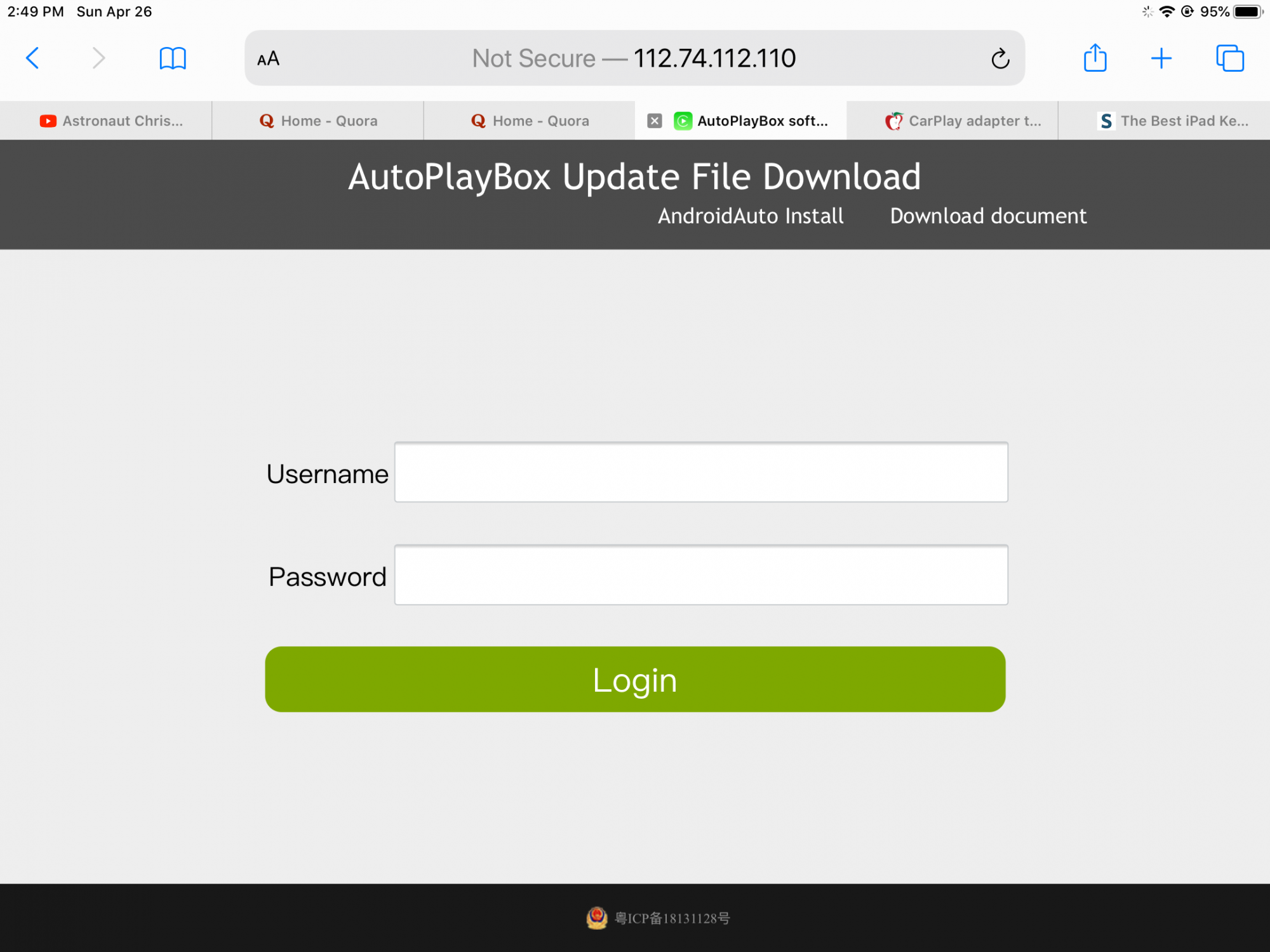

If you keep using the existing URL and replace the date accordingly, you will be able to see if there is a new file or not. If the file is downloading (e.g. for 2020-03-06) you know that there is one. If you receive the 404 message you will know there is no new file.
Code:
http://112.74.112.110/download/YYYY-MM-DD/U2W_Update.img
I confirmed that the only downloadable file seems to be the OTA January 22nd file (either from OTA or via browser using provided format). March 6 and 7 only archived here. Tried every date using provided format from March 6 to April 25 nothing. I tried backing out of the URL what level at a time to get a directory, did not work. The server IP itself brings up an interesting page requiring a user name and password.

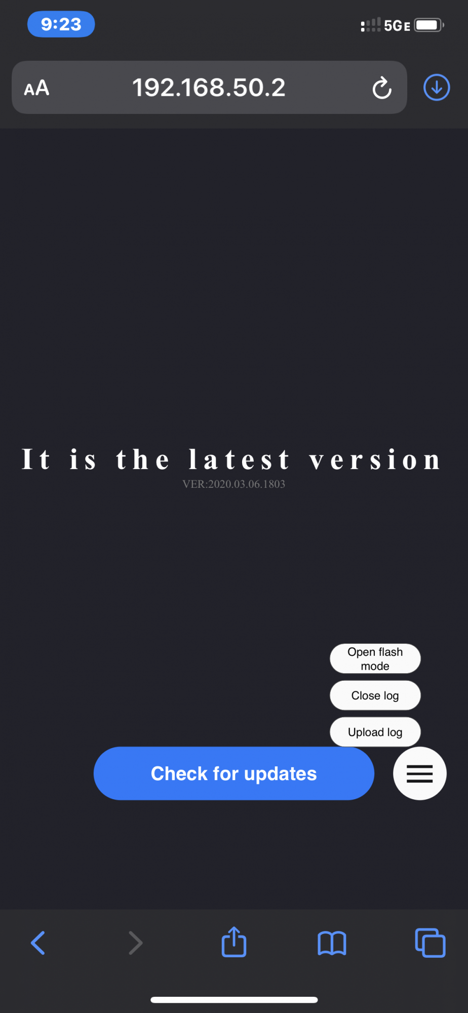

can you attach a screen shot of your adapter showing 3-7-20 installed?
By going to 192.168.50.2 while connected to the CarPlay2air.

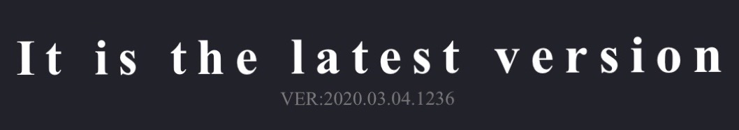

can you take a screenshot of your adapter on 3-7-20?
Bookemdano i just did as 2018 Danali asked and had the device check the version that you have posted as 3-7, its actually 3-4. See screen shot below. The modification date was also 3-4. Worked well in testing regardless. Can you as well check your installed version? I still have to check the one posted as 3-6 as i did not do so prior to switching it out.
Bookemdano i just did as 2018 Danali asked and had the device check the version that you have posted as 3-7, its actually 3-4. See screen shot below. The modification date was also 3-4. Worked well in testing regardless. Can you as well check your installed version? I still have to check the one you had posted as 3-6 as i did not do so prior to switching it out.
Mine is 3-6-20. Attached is the screenshot.
