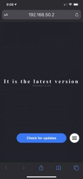

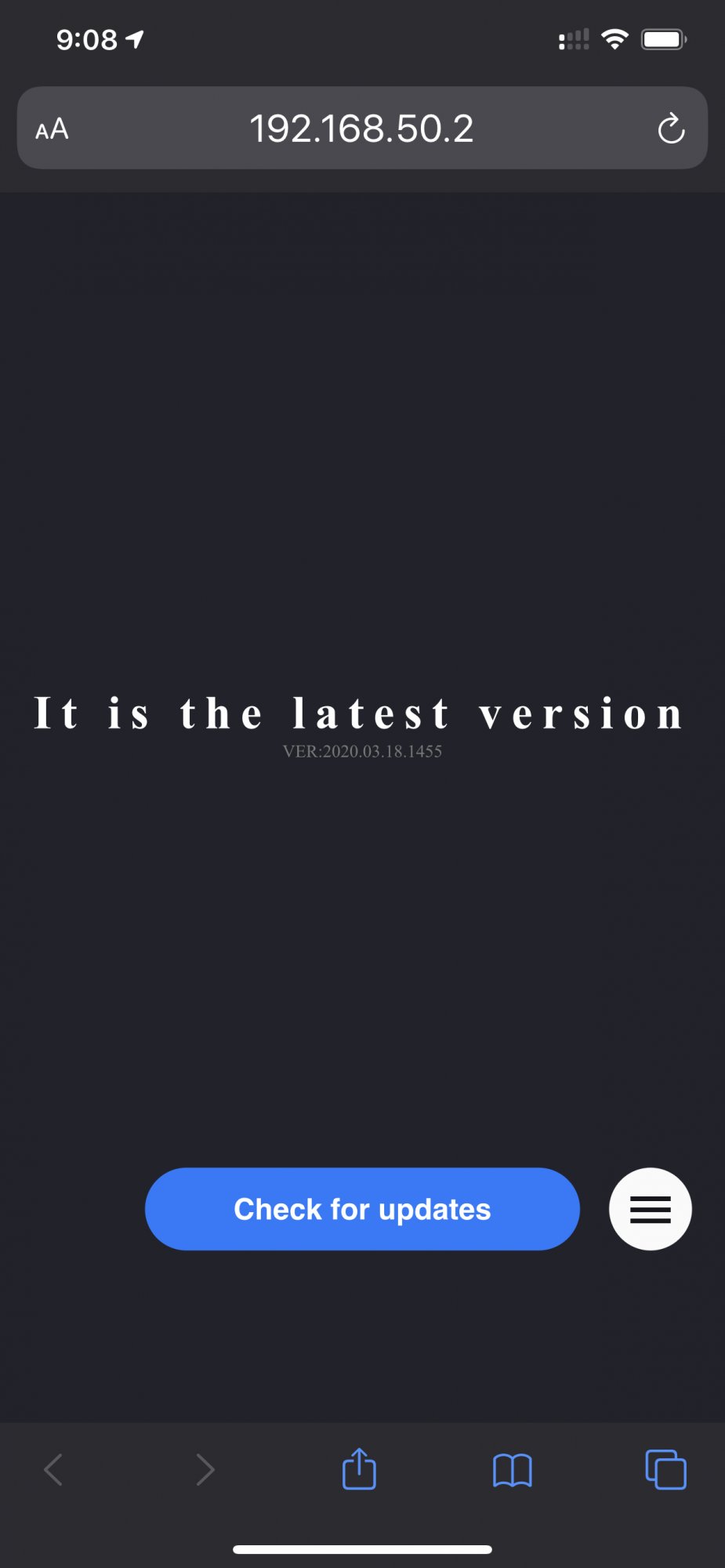

Well after 10 days for 3 day shipping, I finally got my Carplay2Air adapter last night. Was frustrated at first as i would plug it in the USB port and the interface would not display on my 2016 Silverado. After reading through the post this morning I cleared out my personal settings in the MyLink and boom it connected. When checking for an update it said i was running the latest firmware 2020.03.18.1455. I supposed this is 3.18 as I thought 3.06 was the latest...
You are the second one to get 3.18 pre-loaded. The other was a new USB-C model, so I guess 3.18 isn't just designated for that. I wonder why they aren't putting 3.18 OTA? I checked yesterday.

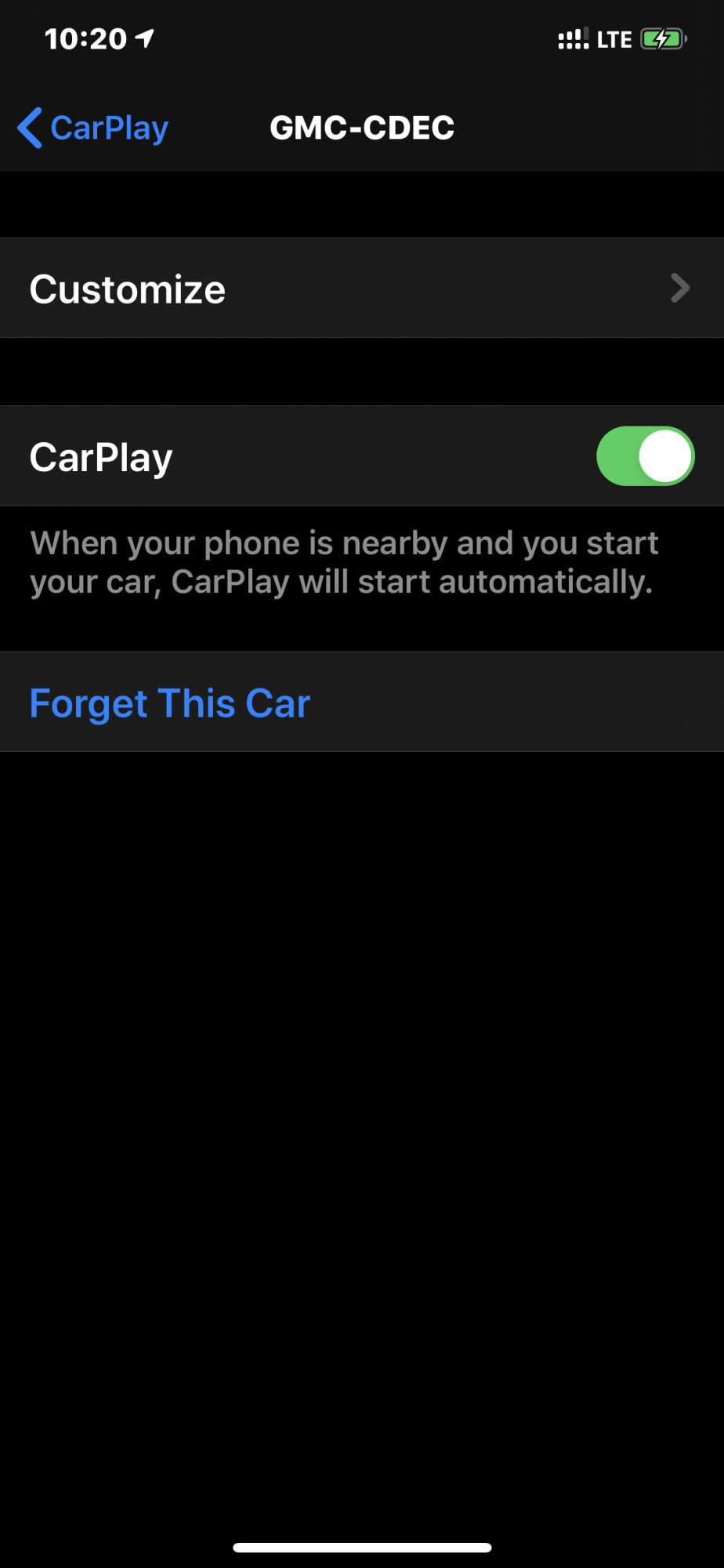

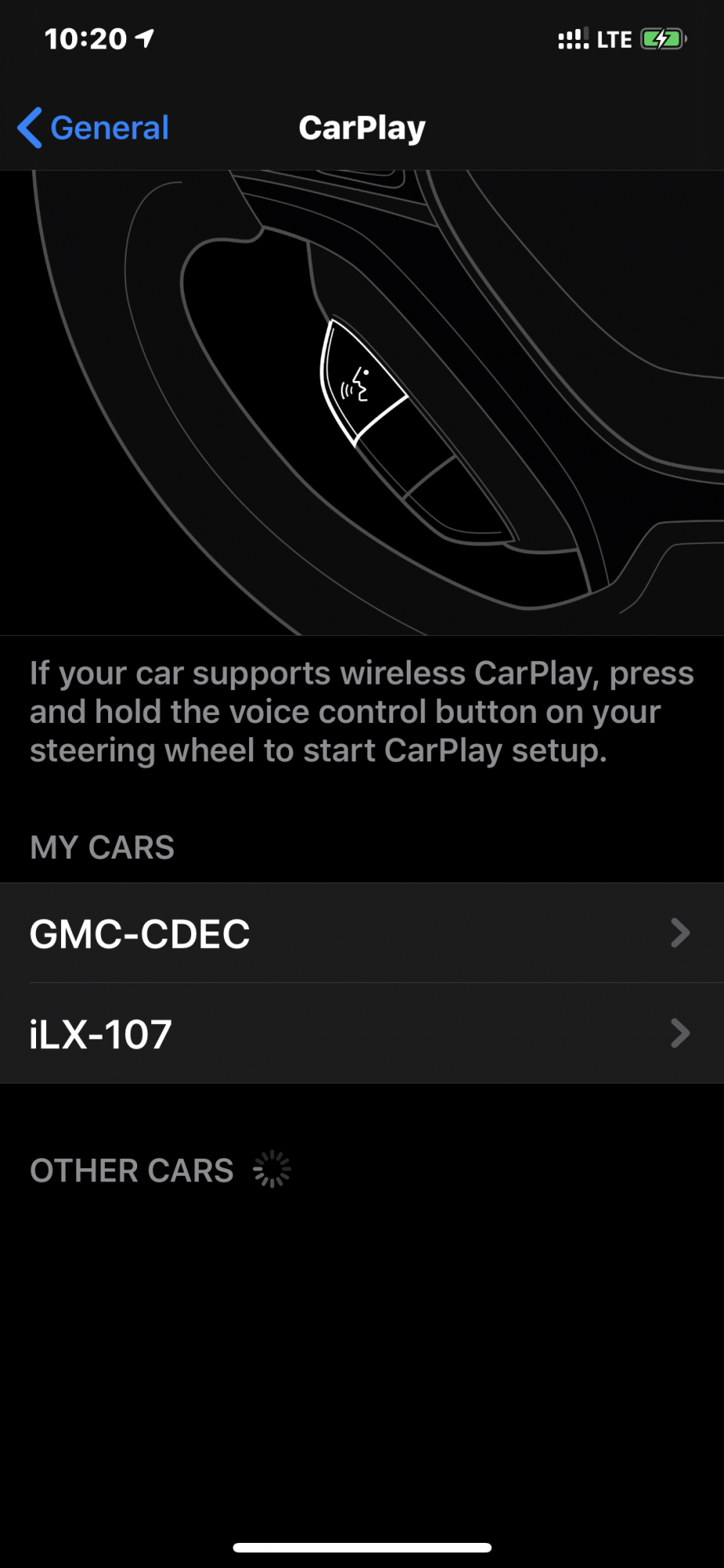

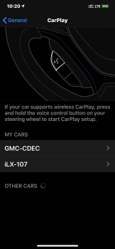

On your phone search Settings/CarPlay then tap on the one for your truck and click forget it. Then start the process over.
1. remove the CarPlay2air dongle.
2. Start the truck and let the screen boot up.
3. Reconnect the dongle.
4. Open Bluetooth setting on the phone and search for the name displayed on the screen.
5. Let it finish the set up.
6. Allow CarPlay if it asks.
see pictures attached.
4. Open Bluetooth setting and the phone and search for the name displayed on the screen.

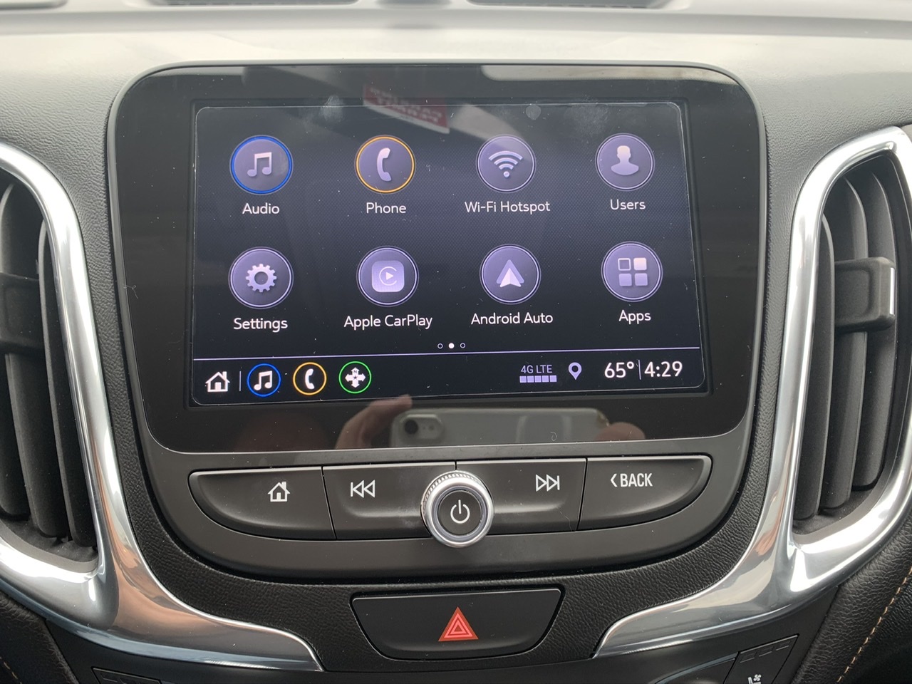

Here you go. Mine is a 2020 Malibu. My wife’s 2019 Equinox with the identical system also only results in the solid red LED.
Thanks looks just like mine. It works every time in my 2016 Corvette. Only bought it for my truck. I’m hoping they’ll come out with a new update.

It's coming on new Carplay2Air units that are arriving to customers. I've had mine now for a week and it came with 3.18 preinstalled.
Yes but they haven’t made it an available OTA upgrade for everyone which makes me wonder if they pre loaded it based on the car you have if you communicated that to them before shipping.
They asked me before shipping the new version. We shall see when it arrives.

For those with the March 18 firmware, does it say “you have the latest firmware” when checking for OTA upgrades? Just curious, you would think so but since 3.18 is not on the server you never know. I guess I’m wondering if mine come with 3.18 and I check for updates will it think 1.22 is newer. Want to be careful to not overwrite 3.18.
