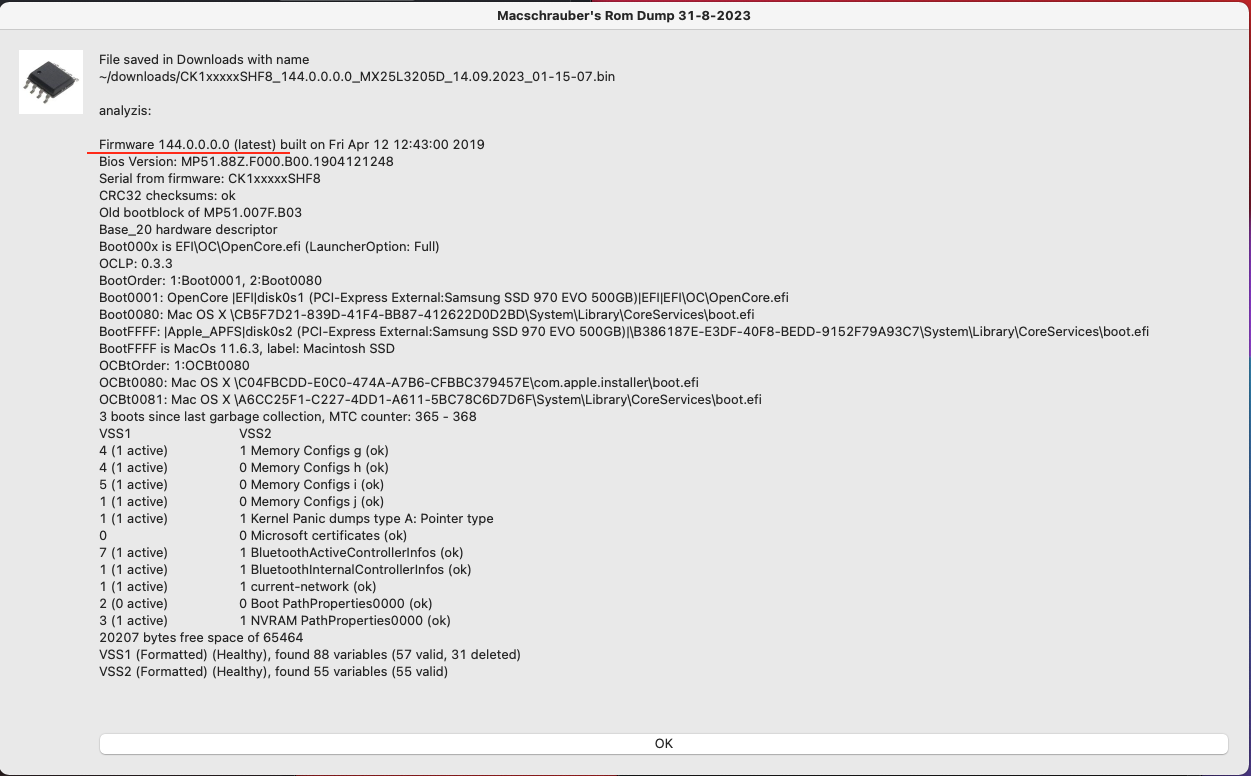

  1. I took a quick snapshot with Macschrauber's bootrom dump tool to get started. Does it look good ? I guess I do not need to flash the rom?

You already have 144.0.0.0.0, but it´s not in good shape and even have PanicInfo.Logs/crash dumps.
You have to do the basic maintenance, like checking the RTC battery voltage, clean-up, CPU tray northbridge heatsink push pins inspection and etc.
My goodness: I simply missed the 1 kernel panic listed there.

I notice that the CPU-B fan kicks off every 30-40s or so and stays full speed for around 15-20s before repeating all over again. I had a quick look inside and think northbridge is pretty dusty/dirty and needs some cleaning work.
But how were you able to tell that from the bootromdump ? Is it a general suggestion or there are markers in the dump that indicate the current shape of things ?
I was about to make a separate thread on it, but since we are here --
Start with the basic maintenance, then run ASD.
Mac Pro is very resilient, but it´s not indestructible.
Educated guess since the most probable cause for KPs saved inside the VSS store are com.apple.driver.AppleIntelCPUPowerManagement crashing. Btw, this is not a BootROM dump, it´s just the report of Macschrauber tool that catch the most common problems.
Inference based on a combination of issues, basically you have a very old BootBlock and hardware descriptor that are prone to crashing when thermals go crazy and the PanicInfo.log. When you have as much experience as I and other users here have, some clues are easy to see.
So guess it means OCLP 0.3.3 (which h9826790 advices against, here) was used to set this machine up ?
Nuke all disks/blades and install native Mojave.
Forget OpenCore/OCLP/any hacks until you have a fuly clean bill of health. You will make it worse and even brick if you continue to use anything but native macOS until you fully repair your Mac Pro.
Btw, you gonna need a full BootROM reconstruction service.

Noticed this in the logs, too:
Code:
14.09.2023_01-49-24> (progress) running eficheck...
14.09.2023_01-49-25> (progress) running eficheck...error
14.09.2023_01-49-25> error eficheck: ReadBinaryFromKernel: No matching services found.
                     Either this system is not supported by eficheck, or you need to re-load the kext
IntegrityCheck: couldn't get EFI contents from kext
and:
Code:
14.09.2023_01-49-24> The Dumper: 31-8-2023, System Version: 11.6.3 (Big Sur)
14.09.2023_01-49-24> OpenCore: UNK-000-0000-00-00, OCLP-Version: 0.3.3%00
14.09.2023_01-49-24> CPU: Intel(R) Xeon(R) CPU X5690 @ 3.47GHz, 24 cores
This is just logging Eficheck does not work on a Mac Pro 5,1.
What is normal. Eficheck is another method to dump the firmware on later Macs. It does not need S.I.P. off, so I use it as another dumping method.
