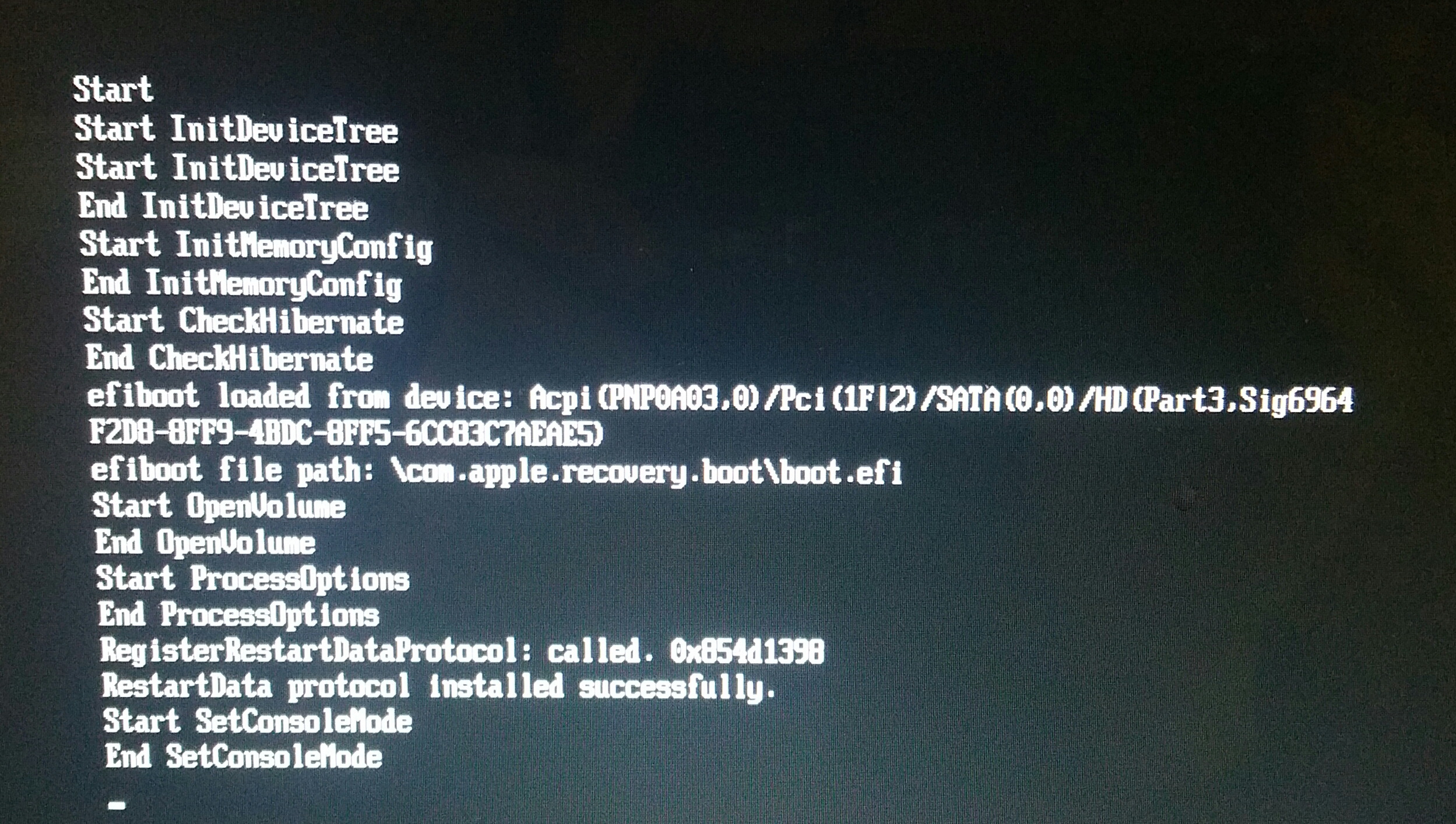

good afternoon, pls am having an issue doing a clean install on my Mac... I have windows currently installed on the Mac but right now it doesn't boot up..so I tried installing Mac OS Sierra on the Mac but I can't seem to have it figured out, pls can anyone put me through...my Mac is 2011 with a failed amd gpu card ... thanks

I found this worked a number of times and then I had to reset my PRAM and my SMC. This again worked a number of times and now is getting more complicated as I cannot determine the sequence in which I need to operate these different codes or resets in order to have the screen operational.
I have tried to launch into recovery mode however my mac doesn't seem to recognize command + R. In turn cannot disable the SIP however still followed these steps which has also gotten me successful boots:

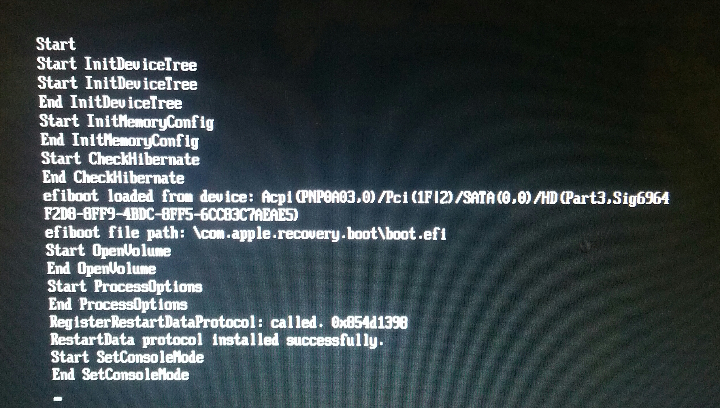

Busted video card and I'm trying to follow mikeN fix.
I just can't get into recovery mode it doesn't matter how much I try.
Command R
Command R S
Please help,
2012 MacBook pro, MacOS High Seirra, 10.13.0.
Command R
Command R S
Please help,
First boot with Command+S. Apply nvram fix.
THEN
Type "reboot"
During reboot hold down Command+R.
Thank you so much for your response (Spectrum). This what I get when I tried your method.
Please chech the uploaded image.
Command R
Command R S
Please help,
I've never seen such a screen...are you sure your disk has a recovery partition?
What happens when you restart with Command+S?
