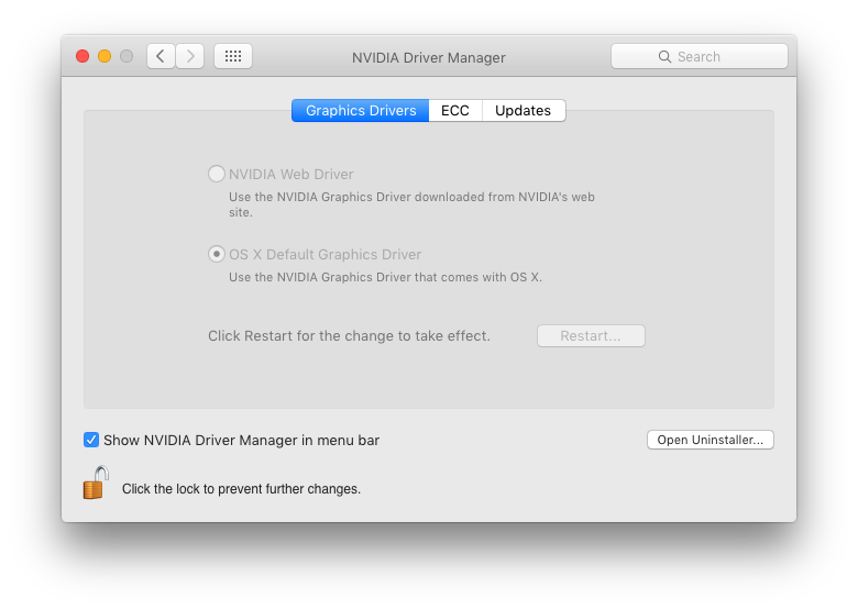

I need your help, like the thread title states, I can't install the nVidia graphics driver update, and the option to choose the nVidia driver as the video card driver is greyed out and the system is defaulting to the Mac driver which is not allowing me to use my GTX 980 in my Mac Pro. Right now I am using my old GT 120.

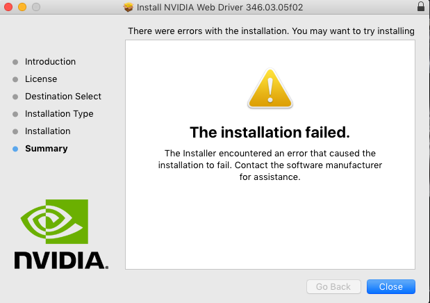

Here is a screenshot of the error :
And one of the unavailable states of the driver (Even after I authenticate / unlock my settings) :
Not sure what to do here, any suggestions?

Hi Lou, I'm not sure if that was one of the Drivers I originally tried, but I just tried it again and got the same error. I tried some of the older drivers from MacVidCard's page as well, but they said they were incompatible.

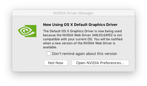

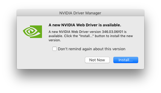

Here are some more screenshots...
I get this one when I restart the computer :
And this is one I get after logging in :

I did try un-installing the nVidia driver from the pref pane and re-installing it, but it did not work. Still getting the error at the end. I'll try finding another way to add them so you can see the error.
