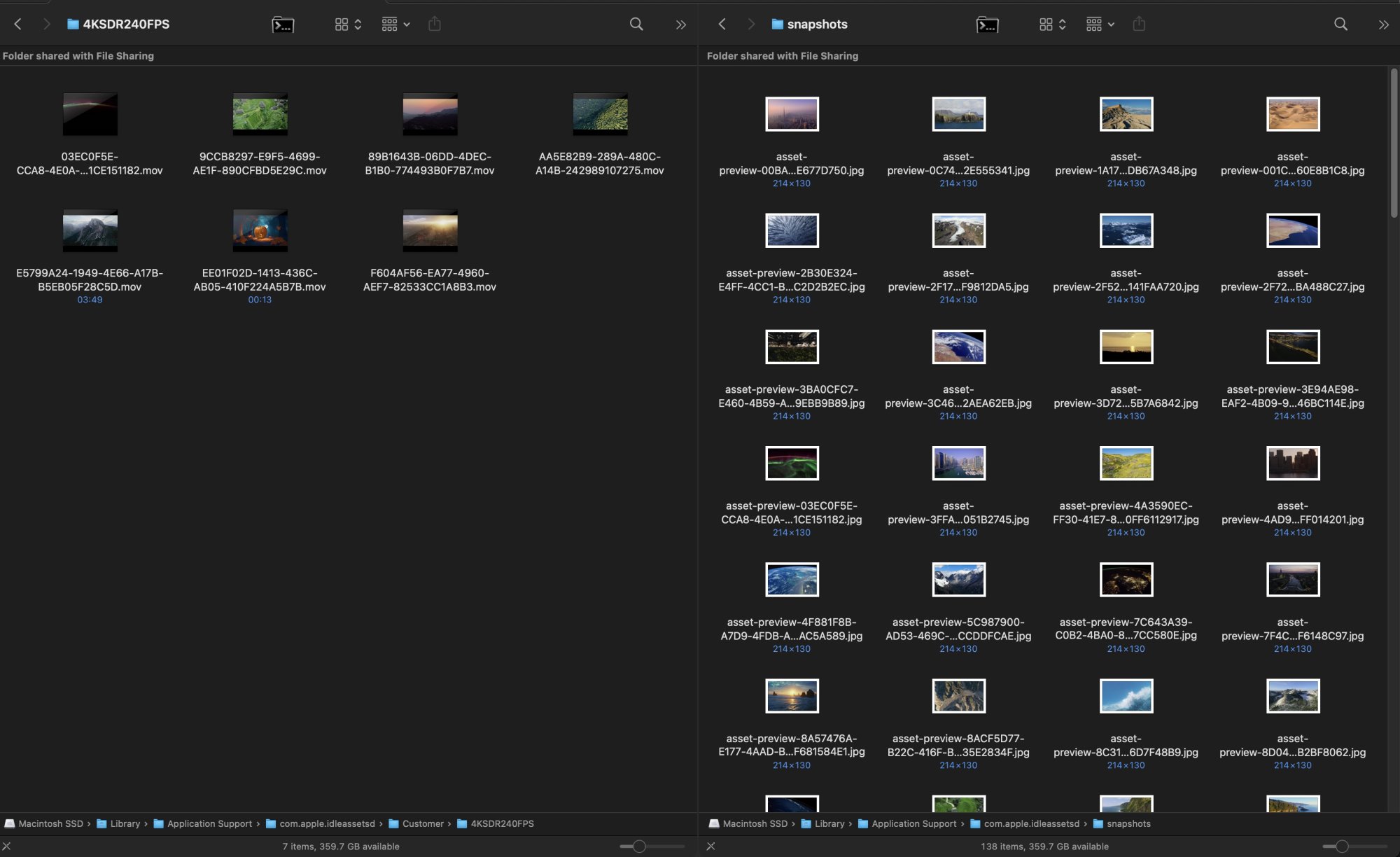

Video (MOV) goes here:
/Library/Application Support/com.apple.idleassetsd/Customer/4KSDR240FPS
Thumbnail (JPEG) goes here:
/Library/Application Support/com.apple.idleassetsd/snapshots

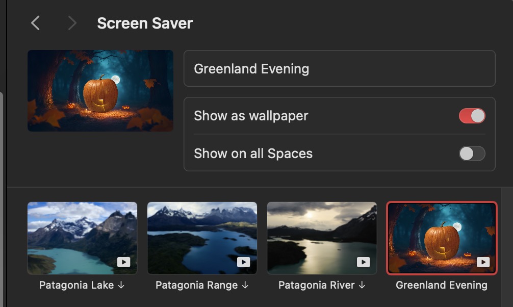

Update:
I'm finding that both the wallpaper and screensaver stop working after some time, and display as gray (what macOS uses when a wallpaper or screensaver is set, but missing). Toggling the option to "Show as Screensaver" off and back on fixes it for awhile. Not sure if there's a way we can fix this, or if it's a coincidental Sonoma bug (this version of macOS has been a crapshoot for me on the stability side of things,. I'm running it on 4 computers, and all 4 have various issues. I had to run the 14.2 beta just to use external drives on my Mac Studio. I wish Apple would focus on quality and stability, instead of feeding us new glittery versions every year!).
I have my halloween themed files attached, inspired by the upcoming Spooky Fast media event.

Hmm, I was able to make a custom screensaver using OPs instructions but also ran into the issue where it stopped working. I noticed when it was only set to play on a single screen (I am running 3 on a 5,1/Sonoma) it worked. Then when I toggled 'show on all spaces' and it broke. Now it just shows black screen even for the wallpaper.
edit: After watching a YT video, i edited my mov to be the same length as one of the built in ones, and that proceeded to solve my problem for the screen saver however, it involves setting the same mov file as a wall paper which makes my desktops all black. Can't seem to get it to work any other way.
I have only MacBook Air M1. No additional display. I made same Time length video as original wallpaper video. I can only run if I keep the option on "show as wallpaper". It goes blank after 5 seconds (1st loop of my video). it will work well after I press some key. Then again it goes blank after 5-6 loops.

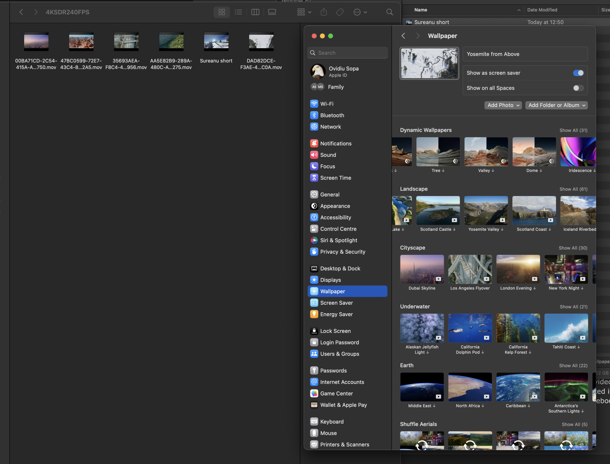

hello everyone,
I'm new to mac and quite pissed off it's so complicated to add a custom dinamic wallpaper, I don't understand why they made this thing so dificult 🙁
I also tried to add a folder, from the settings -> Wallpaper > Add a folder or album (created a new folder and added a .mov 4k 60fps video I created, but nothing happens, no error is shown..)
Than I tried to manually copy the file in the 4KSD240FPS folder, but I couldn't find the video I added in Wallpapers setting or in Screen saver settings. If I chosed another one from the mac library I noticed it was imediately downloaded in the 4KSD240FPS folder, next to my video, but mine still doesn't show.. do I need to reboot ??
Thank you.
PS. Can you guys enlarge the settings window, to the right ? It seems it's locked to a quite small size, I'm unable to rezise it on the horizontal direction, only on vertical axis .. quite stupid, as the screen it's landscape, not portrait.. anyway, I'll be gratefull if anyone can tell me what I'm doing wrong, why my video doesn't show up in the settings window
