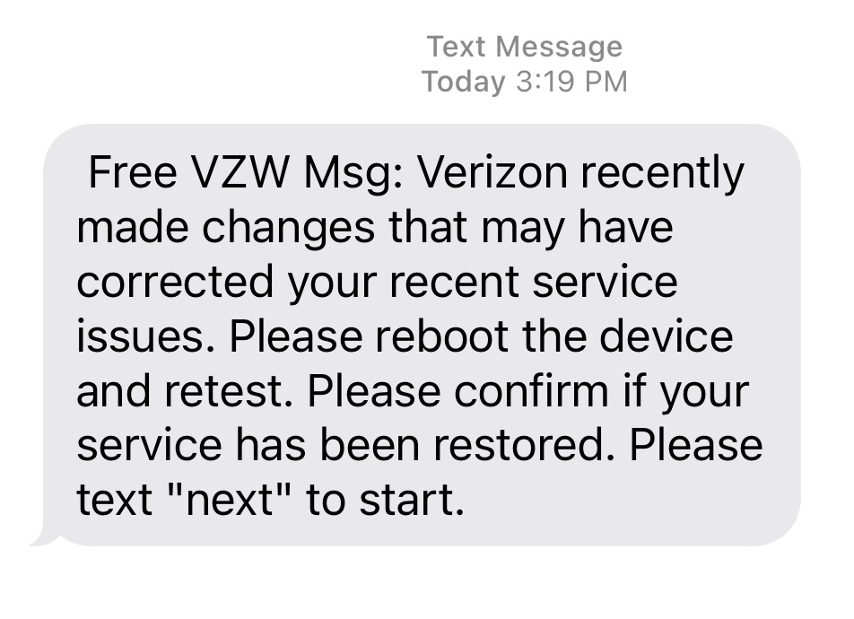

Just received this text from Verizon:
Reactions: Datloud
