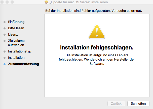

I'm having problems getting this to work on my Mac Pro 3,1 (running 10.12.5, patched dosdude version). Had no problems updating so far through the app store, 10.12.6 however, is not showing up.
1. Tried the script: failed due to insufficient right (I think because SIP is enabled – can't boot to recovery because of unsupported/non-efi graphic card). So I booted to my secondary harddrive and was able to run the script and modify the LauncherDaemon on my primary harddrive. However, the App Store still shows no updates.
2. I tried AUSenabler but still nothing shows up inside the app store (tried all channels).

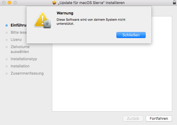

3. Downloaded the Comboupdate. Installing it without modifying the Distribution will of course quit right away like this:
(Software not supported by your system)
However...even after modifying the Distribution file by adding my board (Mac-F42C88C8) and removing my model from the unsupported list, I get an error.

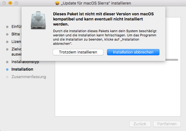

I can start the installation, however, it notifies me with:
This package is not compatible with your version of macOS and may fail...try anyway?
If I continue, it seems to actually run through but then fails with an error message.

You probably have SIP enabled. Disable it and it will fly past that error. Worked for me.
(I have the same mac pro upgrading from 10.12.5 and got the same message. Ignoring the error doesn't work...)
NOTE: I had to re-boot with an old OS on a stick in Terminal to disable SIP since my recovery partition wasn't working : "csrutil disable" and reboot.
While you're at it, modify the platform plist on your recovery partition (make sure you mount the right volume!)
Good luck.

Thank you very much for pointing me into the right direction. After disabling SIP, I was able to install as you mentioned.
Thank you also for the hint about the platform plist, so I got my recovery partition working again as well.
By the way: if you have a full backup of your system disk available, you can use this instead of the USB stick. Just boot into it, use diskutil to check where the recovery partition of your (primary) disk resides, mount it, modify the file and reboot with primary disk. Seems obvious, but sometimes you overlook the simple things. 😉
Edit: also, after disabling SIP, I was also able to run the swupatch.sh script without errors. However, app store never showed any updates (seed or apple production catalog), so I used the modified combo update.
Edit2: booting into recovery partition does indeed work with my non-supported graphics card as well. Once it's loaded, you will see it, just like OSX you simply won't see anything in boot. I just didn't reach that point because I got the "not allowed icon", where my graphic card is not showing anything. Just wanted to clarify this as it's easy to get into this situation with a mac pro and a non-standard graphics card.

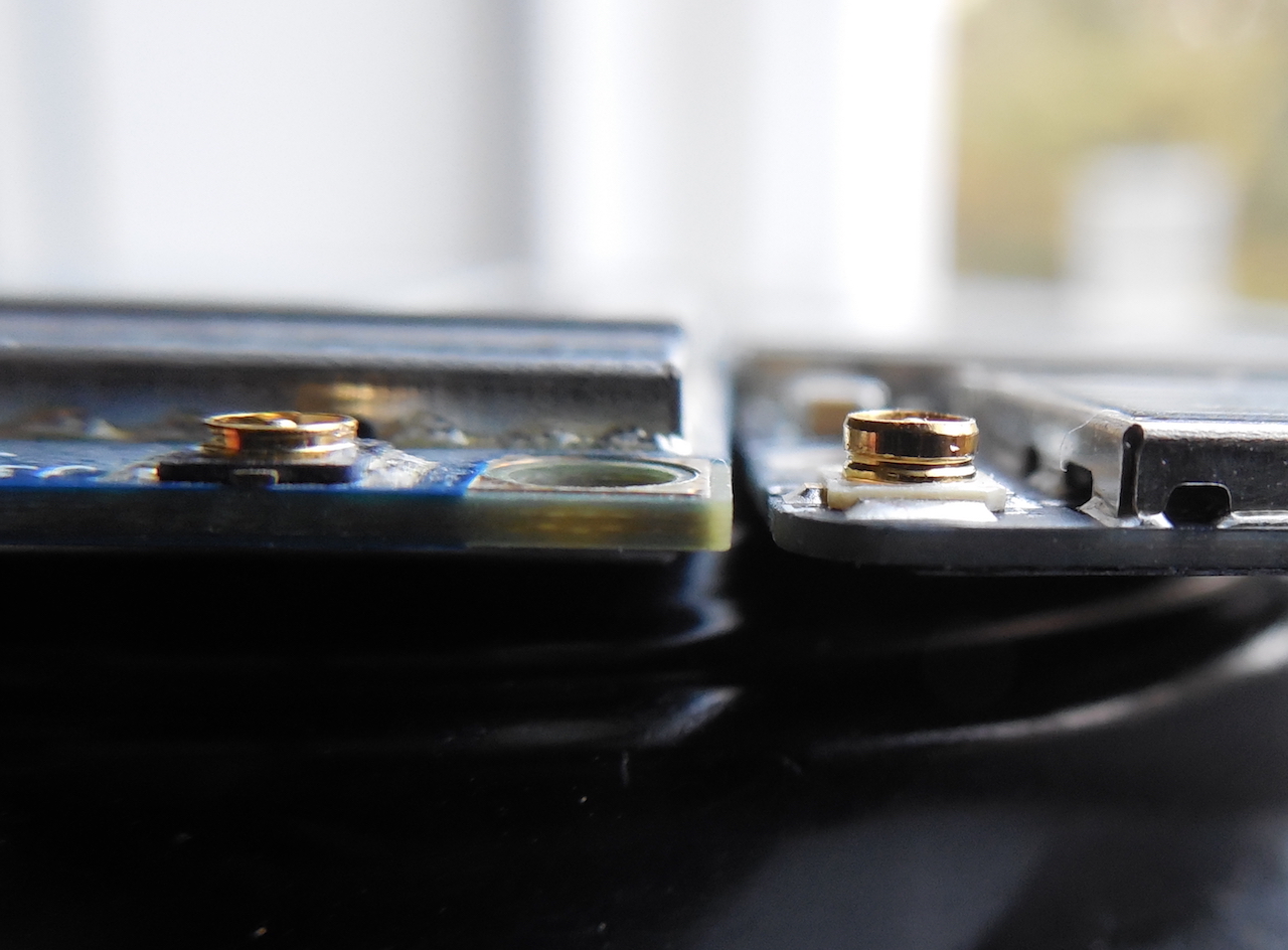

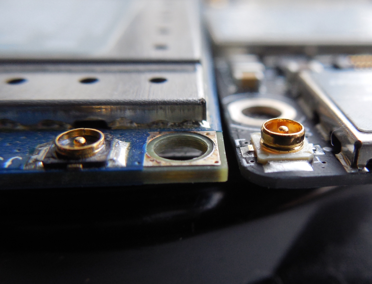

A1342 combo card coax connector is slightly different than the ones on Mac Mini 3,1. It is taller and the groove for the latching/click onto securely is lower (Thus doesn't click and easily disconnects). Diameters are the same (both 2mm outer).
I had no problems with 2 early 2009 Mac Mini. However, 2 late 2009 Mac Mini's antenna coax connector can't really grab securely onto the A1342 connectors. So it appears while early 2009 Mac Mini's antenna coax connector is slightly different than late 09 Minis.
See pics below. The shorter connector is on the 09 Mac Mini combo board and the taller connector is from A1342 with Apple part number 607-7153-A (607-5952A and 607-6503A are the same).
I even tried soldering (with a high quality Hakko soldering iron+pointy tip) but the fit is so poor and wasn't successful.

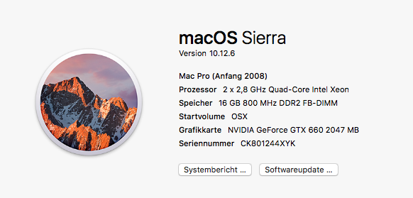

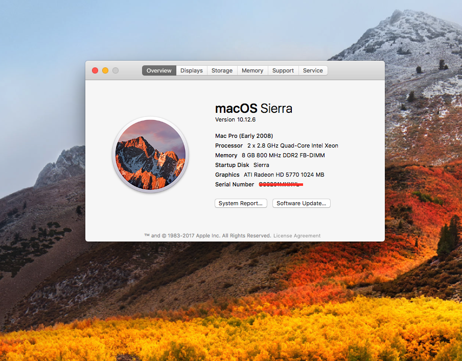

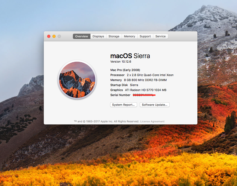

Mac Pro 2008 updated macOS 10.12.6 via App Store.
No problems..
How did you do it, mate? Please share, I'm using a Mac Pro 2008 too, and AUSenabler says there are no updates at the moment. 🙁

Growing impatient waiting for the 10.12.6 upgrade to show up in the AUSEnabler catalog.
After reading the post above by "virk" I decided to give the upgrade a shot.
MacPro3,1 running Sierra 10.12.5., installed using dosdudes patch.
After making sure I had 2 working cloned backups I downloaded the 10.12.6 upgrade from the Apple App store and let it install.
Once the install finished the system booted up to 10.12.6 Hi-Sierra and much to my surprise appeared to run normally.
As a "just-in-case" I rebooted from the USB pen drive and re-did the post-install patches.
Much appreciation to the folks that make and maintain the hacks and patches that make all this possible.🙂
