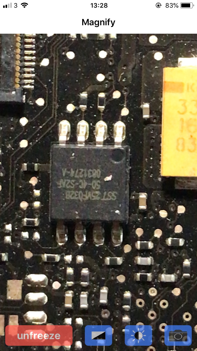

So tried to flash a 5,1 Macbook guess something went wrong . Three short beeps three long beeps and then three short beeps . I don’t have an eeprom programmer so I guess I’m ordering a new chip and getting the solder kit out ?
Ouch! Did it recognize your chip? If not, which one did you select ?
Hearing the beeps rarely aren't bad signs, do you tried a twice PRAM reset and SMC reset?
Do you have tried to swap the RAM sticks? Using one at once?
I did bricked too a MBA (soldered on-board RAM not swappable) about a month ago and the only visible symptom is a silent blinking power led, EEPROM programmer are very cheap, I'm still waiting for the shipment, anyway I guess on your MacBook A1278 since you should have inside an EFI EEPROM CHIP "with paws" you could use an EEPROM programmer with a POMONA Clip without desoldering/soldering.
Using an external USB adapter plug your HDD to another Mac:
The APFS ROM patcher made a backup of your original EEPROM into /Users/yourusername/MacBook5,1_backup.bin
while you'll find the APFS Patcher logs into the /tmp/ root folder.
It didn’t give me an option to select a chip . Just went straight in to dumping a backup then writing new one . Ah well
[doublepost=1534617529][/doublepost]I’ve a fried 2009 board knocking about I’ll practise on that one if I can find my solder flux
[doublepost=1534617793][/doublepost]
That’s the chip

Meaning of startup beeps.
https://support.apple.com/en-us/HT202768
Try pressing the power key for 15 seconds again to get back into flash mode if you can.
