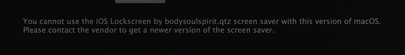

Any ideas of how to get all QE (quartz composer) screensavers to work again? I have installed some 3rd party "iOS Lockscreen" saver and cannot get it to run under Mojave. Error message displayed instead of content...
Same here. Found a nice flying toaster clone and it worked just fine with HS but now I get the same error message.
