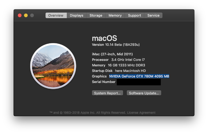

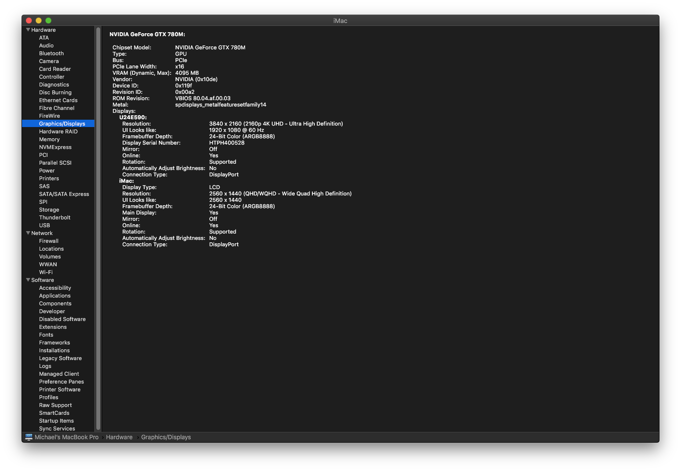

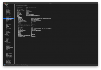

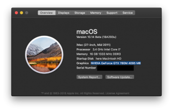

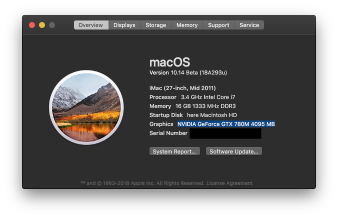

I was unaware this thread existed until today. I installed a GTX 780m into my 2011 27 inch iMac in anticipation that 6970m wouldn't be supported in Mojave. I have booted Mojave with the GTX 780m installed, everything graphics related is functional. There is no audio natively or Airport without modifying kexts. I used AppleHDA and IO80211Family from 10.13.5. As usual there is no Backlight control or EFI boot screen.However doing this upgrade allows this iMac to drive a 4k display over one of the functional Thunderbolt ports.
Screen Shot 2018-06-12 at 4.37.37 PM.png Screen Shot 2018-06-12 at 4.38.48 PM.png
Now that is genuinely interesting as I have that iMac but sinking £200 into a £600 computer with no brightness control gives pause for thought. Might be worth a punt if anyone can work out how to flash an EFI onto the card.
Yes, MacVidCards has been talking about MXM EFI cards for iMac on his Blog since last June. If such a feat was accomplished I would instantly buy/send away an MXM card for EFI features. The Sandy Bridge 2600 in this iMac still performs well today, and this chassis is great to work on compared to 5k iMacs.

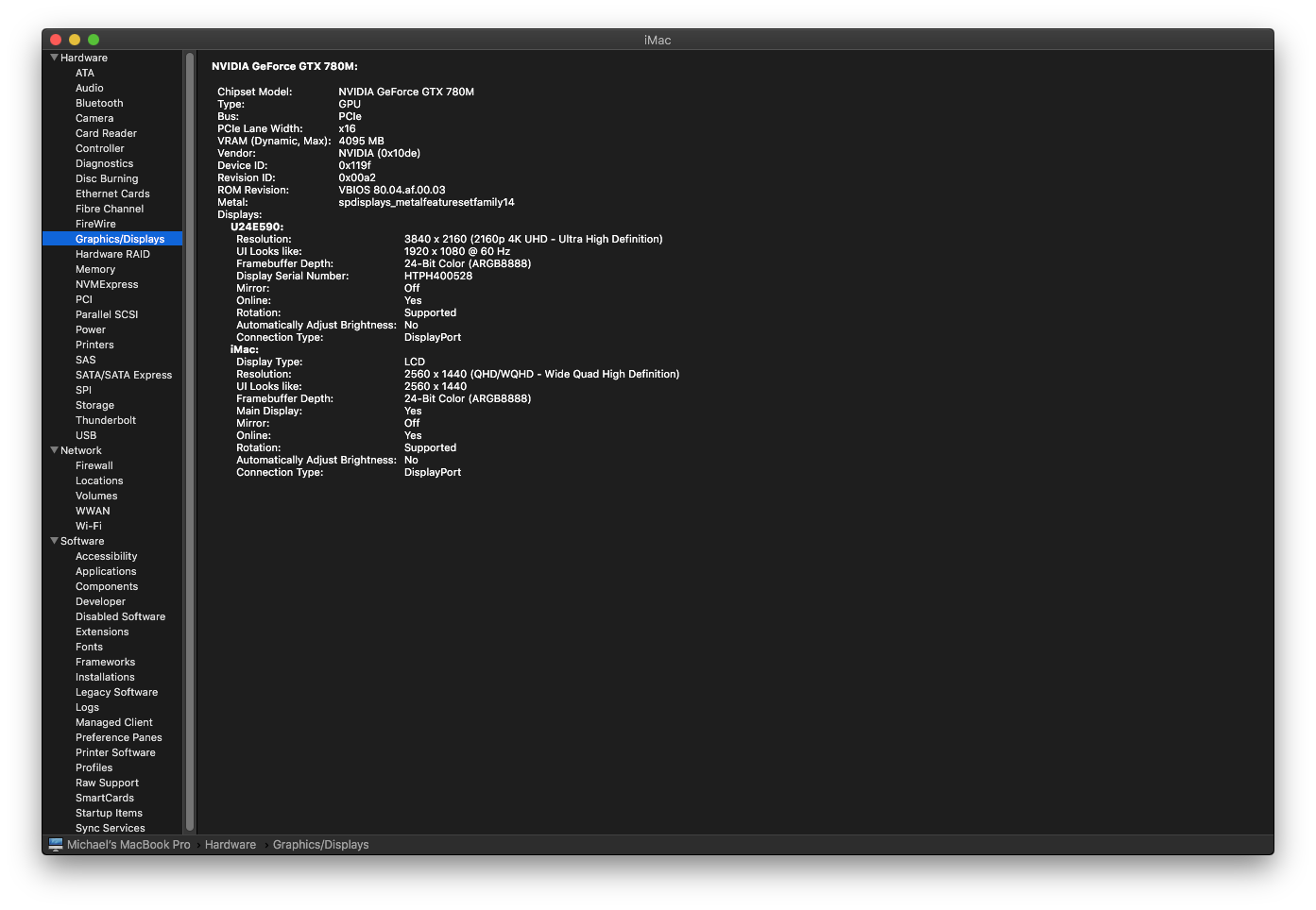

Hello everyone,
View attachment 766059 View attachment 766060
Now that is seriously cool! The thunderbolt chip in that machine supports DP 1.2? Amazing! Hope for the EFI flash development soon!
