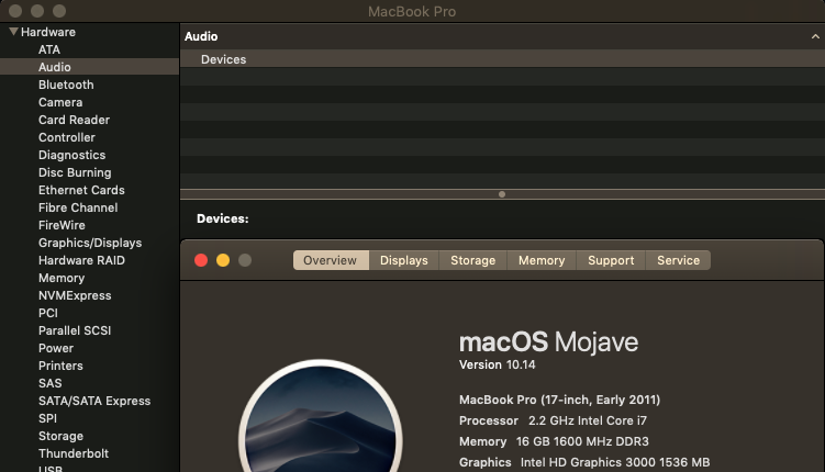

Suddenly, my Mac sound is dead...
is there any way to run diagnostic?
Re-install Legacy Audio Patch using Patch Updater.
