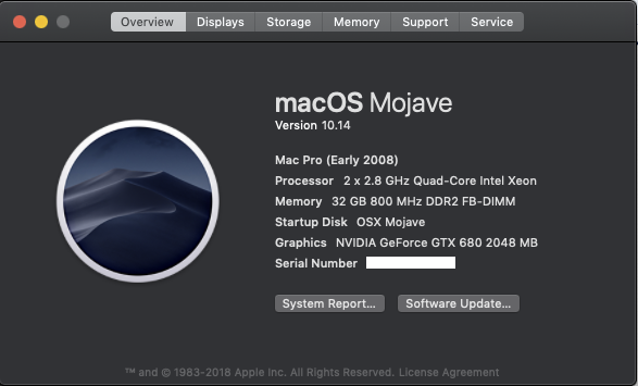

The GTX 680 works great on the 3,1 running macOS Mojave which was installed using dosdudes amazing patcher. 🙂

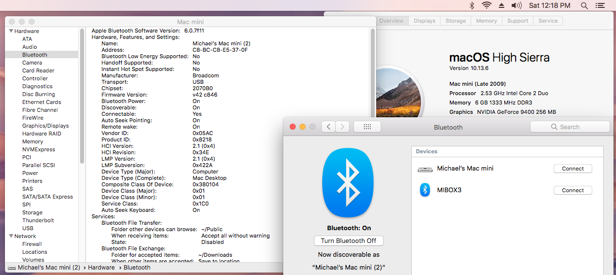

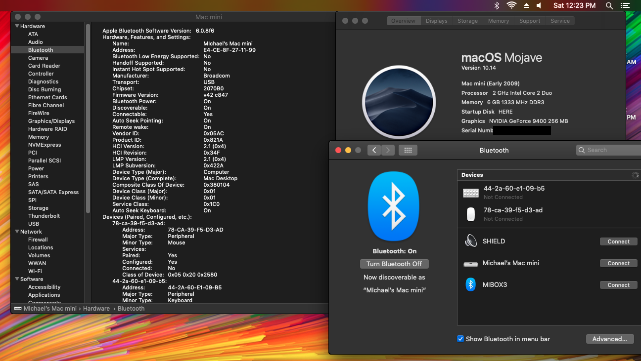

Here are my final results. So far it looks like my final install from scratch has taken. My SSD reads 3 GBz on both Link. I am on a Late 2009 3,1 Mac Mini. I changed the WiFi card, but gained WiFi but lost Bluetooth. The System report says Bluetooth is installed but my keyboard and mouse don't connect. I am using a wired keyboard and mouse. Now I am curious how do we Know when a new OS is available. I installed the Beta access file, hoping that would help.
A link to a Bluetooth Dongle would be helpful, if there is one.
Strange, both my Mac mini's are able to see/connect to bluetooth devices after swapping cards. Do you have bluetooth available at all in system preferences? It could be one of your antennae connectors (most likely the one by itself) popped off during reassembly

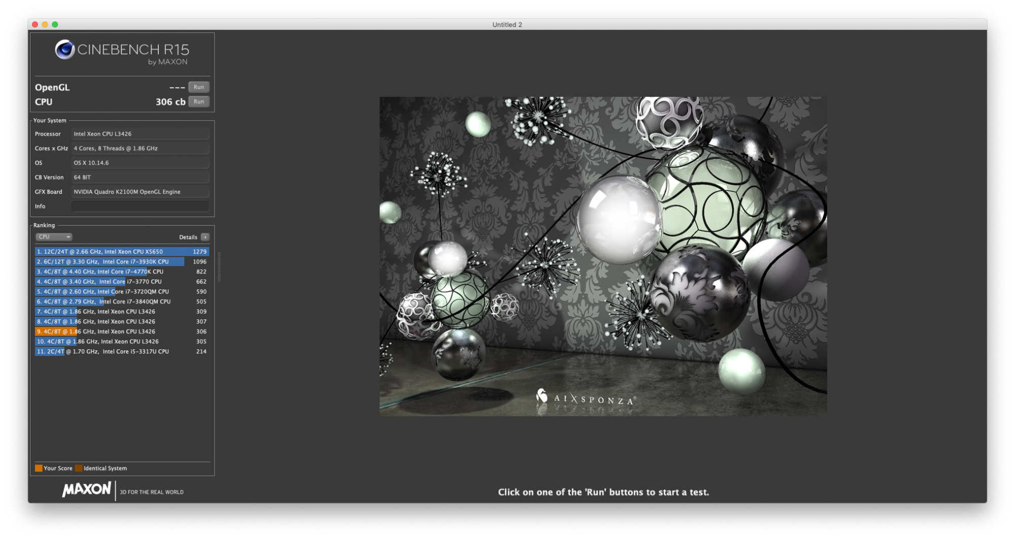

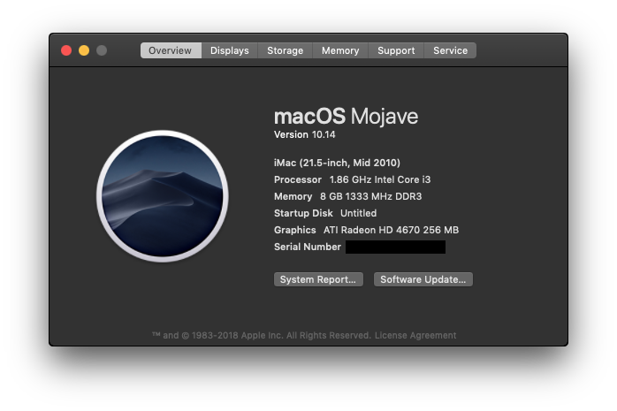

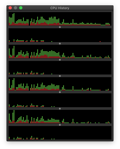

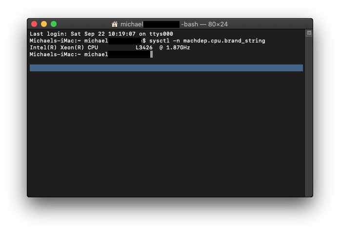

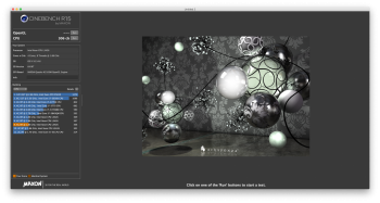

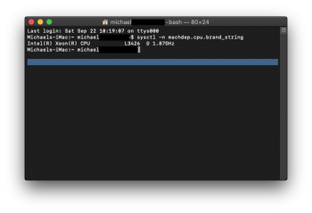

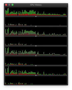

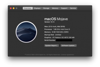

I installed Mojave on my Mid 2010 21.5" iMac. Everything went fine, this Mac natively supports APFS. What's different about this iMac is the CPU, I wanted this iMac to be quad core. I found out the hard way the 21.5" iMac does not support CPU's higher than the 73w TDP. Doing research of different Lynnfield processors I came across the Xeon L3426. It's a 45w 1.86GHz quad core cpu with hyper threading. This is the CPU in the iMac now and it has been working flawlessly.
